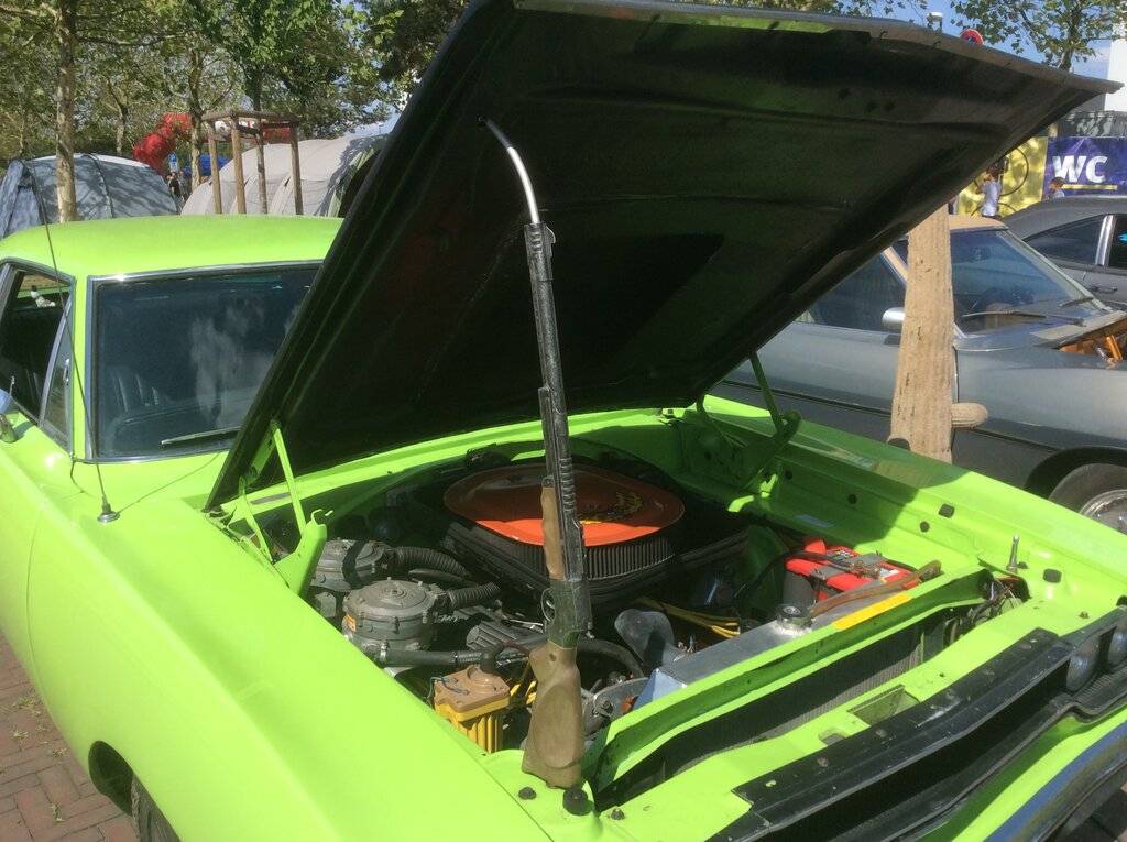

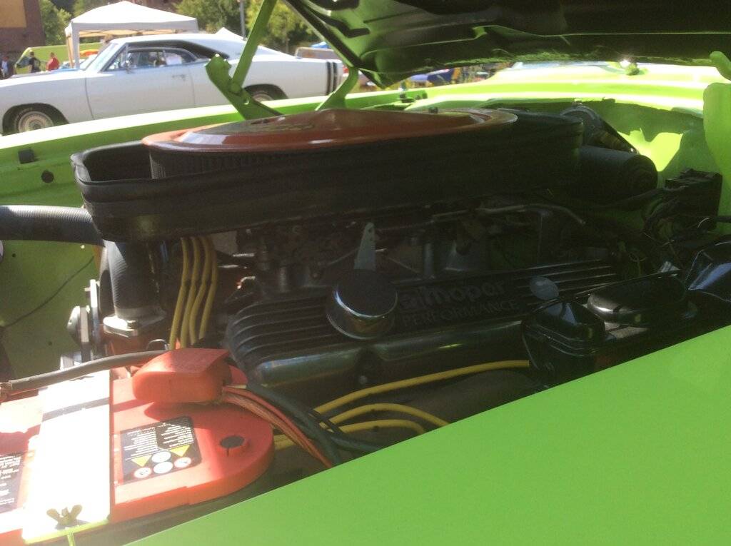

Here some pics of a 70 RR from the Netherlands that attended our 2018 German Mopar Nationals: runs a dual quad setup that is fed by 2 IMPCO-propane-evaporators.
Oh, and as being a Dutch vehicle: it is of course equipped with a trailer-hitch :poke:
