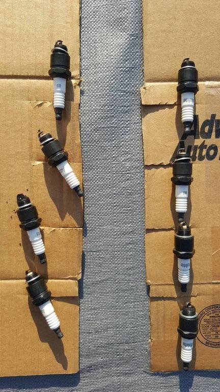

so ive been dinkin around with it, trying to get it to fire. heres where im at. i need some chicken bone readers to tell me what these bones say. do i have a shot at it? or do i just punt and pull it now and send it out?
#5 scares me, and #6 was dripping wet. the rest of them aint so bad lookin.

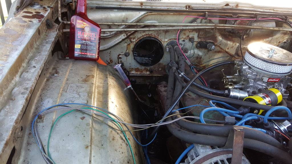

so i put more marvel mystery oil down the cylinders, and it will sit. more.
Your #5 plug looks like it's oil fouled, I don't know how I missed this thread before
i invented meself a new device today - the piston soaker 3000 (TM). it has 6" rubber fuel line on one end, connected to steel line, connected to a syringe, allowing me to do an engine high colonic.
stab teh rubber hose into the spark plug hole, fill, and wait, and then fill more.
...so, it sat a week soaking, then i turned it over, and soaked it another week. today it still was puking out lumps of black **** when i spun the motor, so i am gonna soak it again for another week.
im trying so hard to not take this motor out/apart. i hope i get there.
it wasnt oil :/ its grunge :/
its gritty, but the grits break down like if u take a chunk and rub it in your hand, i havent found a piece yet that was reflecty or '**** this is a piece of metal' its just old *** grungy *** old engine grunge. i hope. i hope i dont jinx myself.

Sounds kind of like "carbon", which could be from rings (should have shiny edges on the piston tops), too much fuel, bad ignition, and/or a dirty air filter element.
How much has the oil level increased after your mystery infusions?
