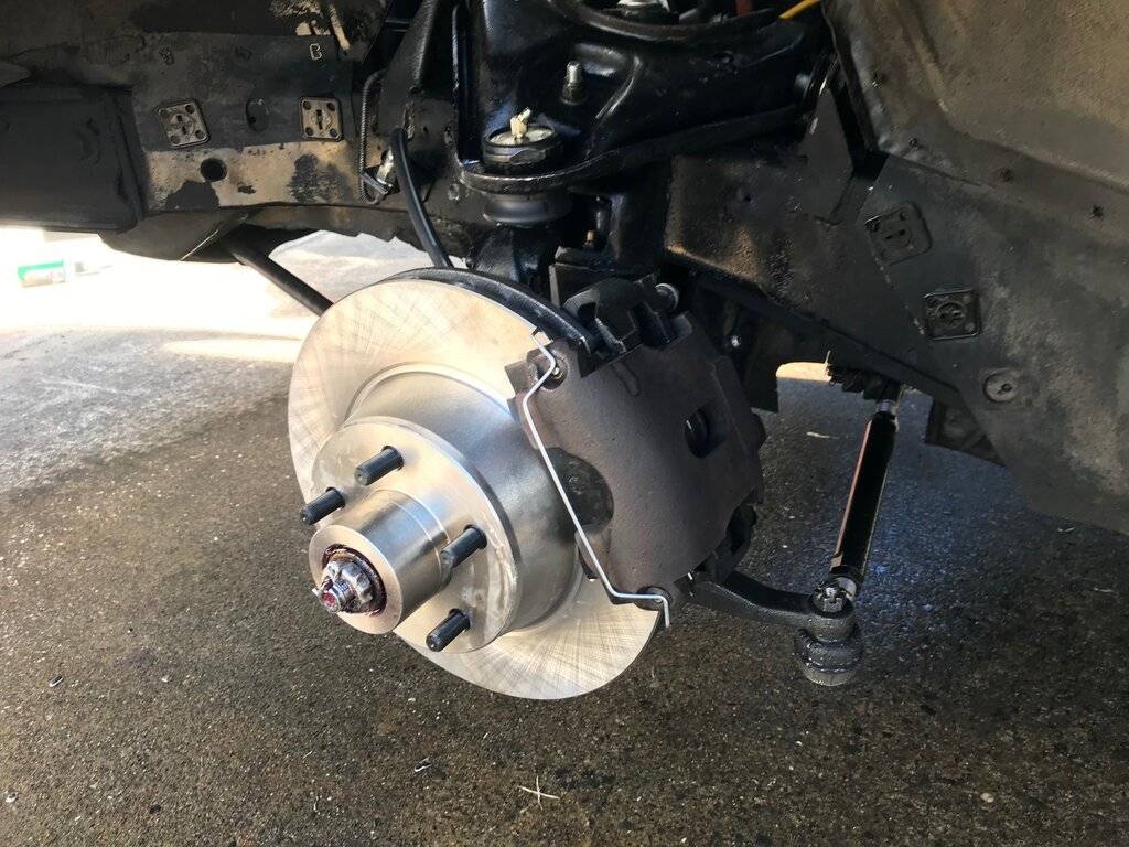

After a lot longer than I wanted it to take, I have completed the front drivers side (minus the sway bar which I'm still waiting on, shouldn't be much longer, they're getting powder coated now). Only 3 more corners to go!

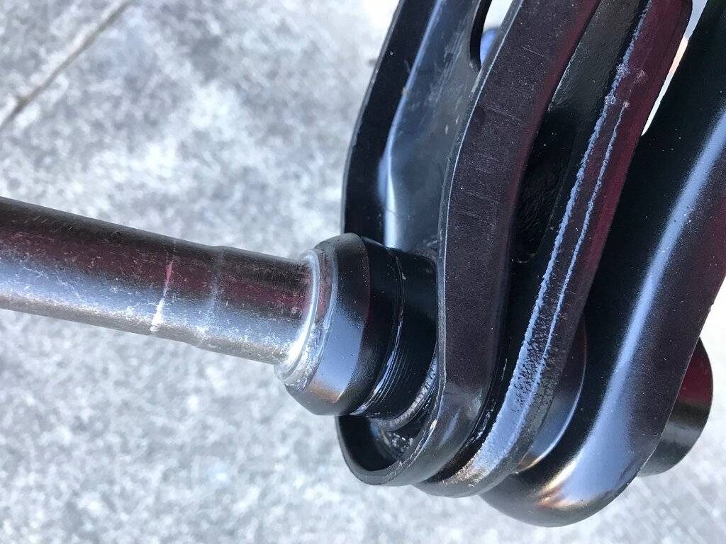

Looking at the position of the new torsion bar, I'm not sure I picked the right slot to install it... it looks very high compared to the other side (original). However, if I indexed it on the next position it looked very low compared to the other side, almost interfering with the adjuster. I could surely use a more experienced opinion...

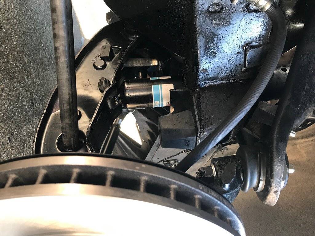

love to know how you like the Bilstein shocks on your C-body. I use them on A,B and E, haven't tried on a C-body. I would like to use on an Imperial, if they make for the Imperial.
Hope you did one side at a time. With the stock bar and suspension hanging and the adjuster for the torsion bar backed off to remove the tension on the bar take note of where the bar aligned and where the adjustment tab is sitting within the control arm. Once you install the new bar try and get the tab to sit in about the same spot, a bit higher within the control arm is fine since it's a new HD bar so might not require as much adjustment to get the ride height where you want it.
BTW I bought the big Firm feel sway bar many years ago for my wagon and love it. I only use poly bushings on sway bar links and ends, the rest is rubber, I have well over 10K miles on my wagon over the last 10 years and the suspension has held up well even with it being a PST kit I installed.

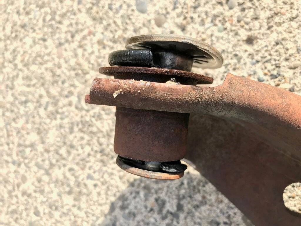

I used a good amount of degreaser and spent a lot of time with a pressure washer to get them cleaned up. I've since sprayed all the parts I'm reusing (UCA, LCA, spindle, disk brake mounting bracket and dust shield) with rust reformer and will rattle can them with Krylon Farm Implement paint to get them to look better. Same as I did with the completed driver side.

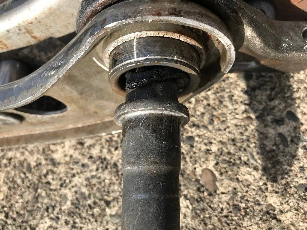

How hard was it to get the rubber out of the old LCA bushing? Looking to do some new bushings on them too!
