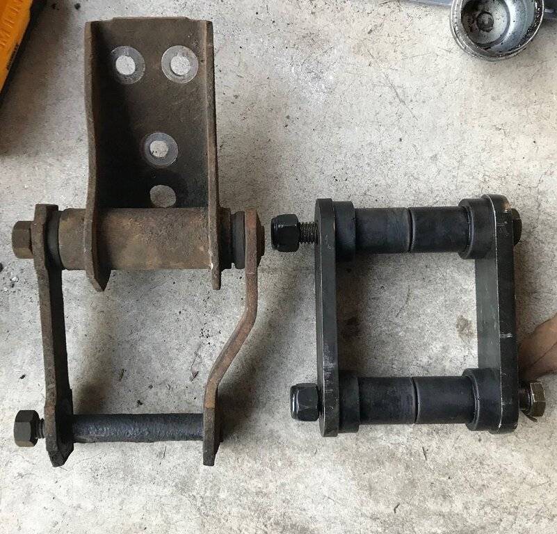

One issue. It appears I have the wrong HD shackles for my new leaf springs. The originals have a very different shape and dimensions than the new ones. I have already talked to FirmFeel and they will get the correct shackles for my application. In the meantime I have some stock replacement shackle bushings on the way so I can move forward with spring installation

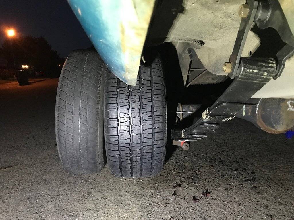

Question for the brain trust here. The new Bilstein rear shocks are about 2.5" shorter than the ones that are on Alvah now when fully extended. Is this a problem?
I'm having difficulty with the FirmFeel parts not fitting on the back end. The new leaf springs fit great and seem like a real improvement over stock! The Iso Delete kit just doesn't fit. I suspect it will fit fine once I have the sway bar which includes a new plate that goes between the axle and the leaf spring, however there is a round piece which is intended to replace the rubber isolator which is probably 1/4 to 1/2 inch too big to fit into the original rubber isolator top plate where it is supposed to go. For now I've reinstalled the rubber isolator and will wait until I get the sway bar kit.
The difficulty with the Iso Delete and the incorrect shackles has me paranoid about the shocks.

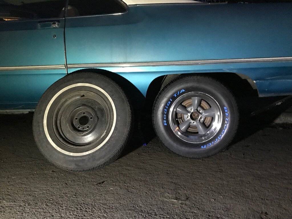

After failing and flailing last night with the suspension parts, I decided I needed a win and test fitted the new rear wheels and tires... I went with American Racing Torque Thrusts (15x8, 4.5" backspacing) with BFG Radial T/A in 275 60 15. Man do they look good!

I just got off the phone with FirmFeel and they are sending me the correct "puck" for the Iso Delete kit so I'll be able to remove the rubber isolators from the rear leaves. This should solve all of my woes.
They also ensured me that I have the correct shocks. They are shorter than the stock ones, but I understand this will not be an issue once the weight of the car is on the suspension.
