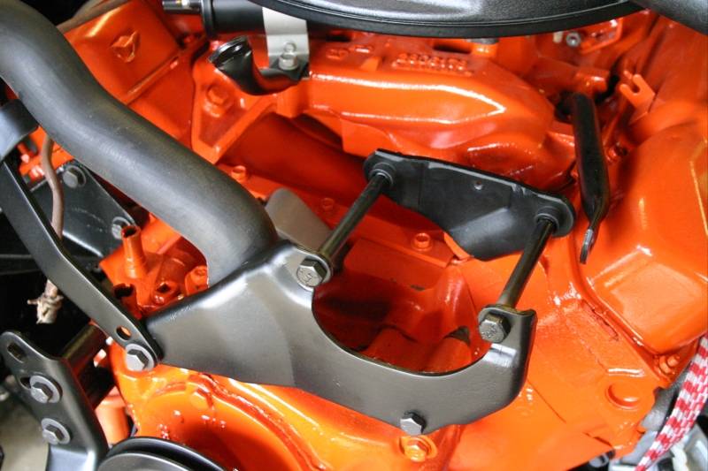

This is all the bolts,
The two struts on top.
The triangle bracket in back has a bolt.
The two on the front bracket.

What year? The brackets completely changed between 68 and 69. Maybe more changes on mid 70's.
It could have been swapped around also, Got any photos?

the earlier cast rear bracket that attaches to the compressor with 3 bolts goes from head to head i think to 2 front intake bolts...there's usually a passenger side tubular brace that attaches to the side of the compressor with 2 bolts and goes back to another intake bolt ,and a r/s tubular brace that picks up a head bolt on the compressor and goes to the intake by the coil bracket (see them in the pic now missed them before)...total overkill the newer ones got much simpler...there are 2 clamps that hold the l/s hard line too...one over by the carb linkage and the other in the back (might go to last intake bolt on r/s?)....just remove the small bolts to remove top of clamps leave the bottoms bolted to intake
That won't work, this small brackets to intake need to come off. The 68 and older compressor bracket has 2 bolts on left head and one on right. Then to top PS bolt and the bolt by T-stat whee alt strap goes.
