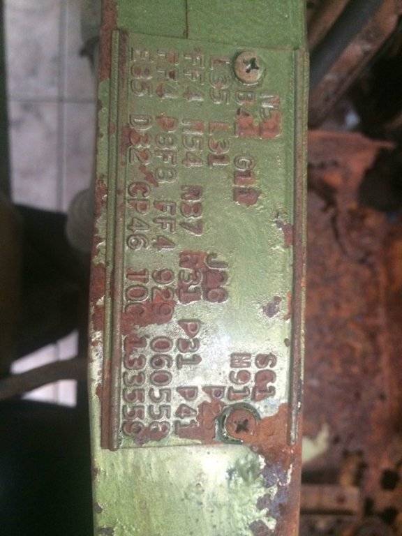

It is E85.... where I can find these exhaust muflers similar to originals for sale? Any guess?

Looking at the factory brochures for 1969-71, no Town & Country wagons were available with the 440 TNT engine, just the E85 standard 440 (and 383-2 & 4 bbls as well).
For 1969 and 1970, for the standard 440 engine and the 383-4 engines, it appears that the dual exhaust system was a mandatory "option", and single exhaust not available except on the 383-2 bbl engines in T&Cs where it was standard. The trailer tow package didn't mention anything about exhaust systems. The way the charts are laid out, it is a little vague regarding exhaust systems for the 383 engines though, so maybe a deeper dive might be required to get to the bottom of it for them.
For the 1971 Town & Countrys, only single exhaust was available with the 440 standard engine and dual exhaust optional on the 383-4 engines (and single exhaust appearing to be standard).
Just FYI, compression ratios on all the 1969 440 engines were 10.1, in 1970 all were 9.7 and in 1971 it was 8.8 for the standard E85 440 and 9.5 for the E86 440HP engine.

You might take a look under your car for any evidence of a factory installed dual exhaust system (hangers brackets, bolt holes, etc.). In any event, you can get a custom factory-like system (either dual or single) from Waldron's. I put their entire stainless dual system on my '66 300 convertible; it fits a looks pretty good to me.
