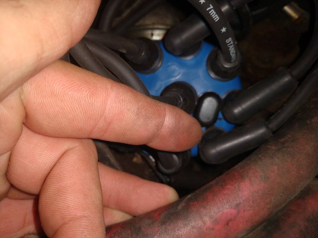

    Will check tdc again tomorrow. As far as I know the distributor has never been out, something's gotta be wrong! Here a pic of where my #1 plug wire is. No pointer on my cap. IMG_20190703_214720155.jpg

    Your number 1 position looks to be the same as mine. But it t looks like your next wire (just above ccw) looks to be going over to the odd side with #1, should be #8(right rear). Could be the perspective.
    As @Big_John said. Counter clockwise distributor rotation, 1-8-4-3-6-5-7-2. Left bank odd numbers right bank even.
    I thought I could go from memory on mine but got my lefts and rights mixed up until I peeked in the manual.

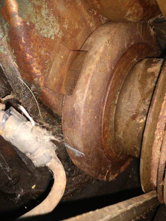

    Just double checked tdc on the compression stroke. Watched the exhaust valve open and close. Then the Intake open and close. Tdc after the intake valve closes is where I wanna be right? Rotor is pointing at #1 plug wire. Here's where my balancer Mark is when #1 is at tdc. IMG_20190704_133710341.jpg

    Both valves will be closed on the upstroke to TDC and also on the downstroke.
    Judging by the white mark on the dampener, you are about 30 degrees off if the spark plug is pointed to #1.
    Again, plug out, thumb on hole, when the air starts to push out of the plug hole, continue to rotate the dampener until the mark aligns with "0" on the timing tag. That is TDC on the compression stroke.

    With the harmonic balancer 30 degrees off:
    If you have original cam sprocket for timing chain, may have nylon teeth. Some could be broken off. If you pull the distributor cap and someone turns the key to start and holds it, does the rotor spin with steady motion?
    If not, you have a big job ahead: change timing chain and sprockets, pull down oil pan and clean out debri.
    If someone turns the crank at the harmonic balancer, breaker bar and 1 1/4" socket, while you stick a piece of coat hanger down the spark plug hole for spark plug number one, you can feel TDC as the piston reaches the top, pauses for a second and starts moving back down. Does this match your TDC?
    If not, you need to reorient distributor and spark plug wires so rotor is on contact for piston 1 at true TDC.
