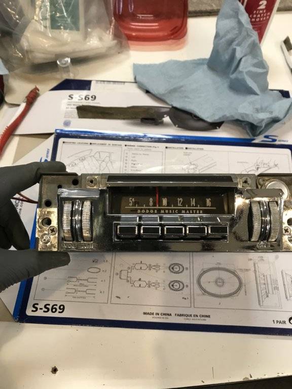

Has anyone purchased an Aurora radio conversion kit and installed it? I am not afraid of electronics and this seems like it would be a fun project to convert my radio for my ‘68 Polara. Any suggestions on what kit to use? There seems to be a few different ones offered by Aurora.
Go for it, but I have never heard anyone doing it themself. I got the pre amp for subwoofer and front and rear speakers. Don't bother with the the usb/mp3 adapter, unless they have changed it, I couldn't get any of my UBS drives to work. It comes with a mini plug input for anything with a headphone jack.

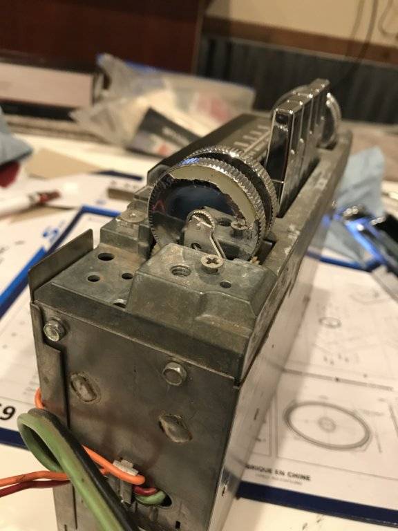

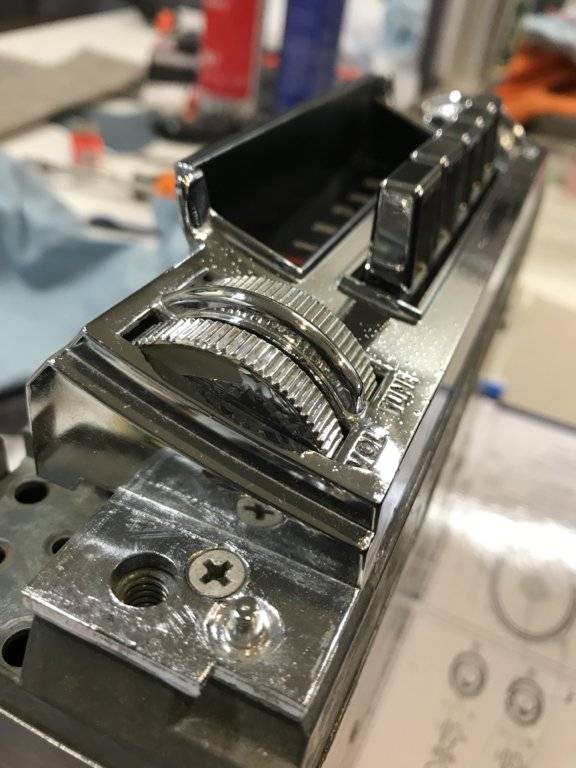

I think I have other issues. The chrome is peeling off the side of my volume dial. Also the plastic gear was stripped preventing turning the radio all the way off. I was able to rotate the gear a little. It will turn off now, but I wonder how brittle the plastic gears are.
Since only a little shows with the bezel on I am try some chrome paint on the wheel.
