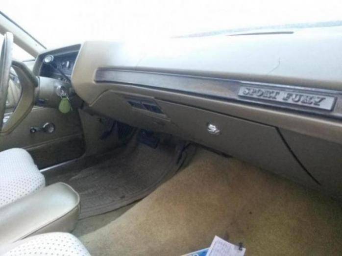

No woodgrain in the drivers area/gauges. Not sure of the rest of the dashpad

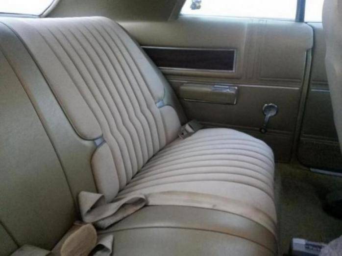

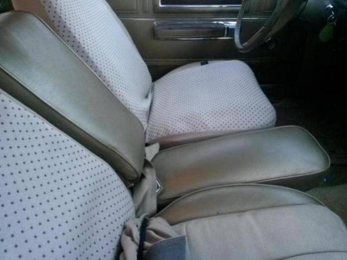

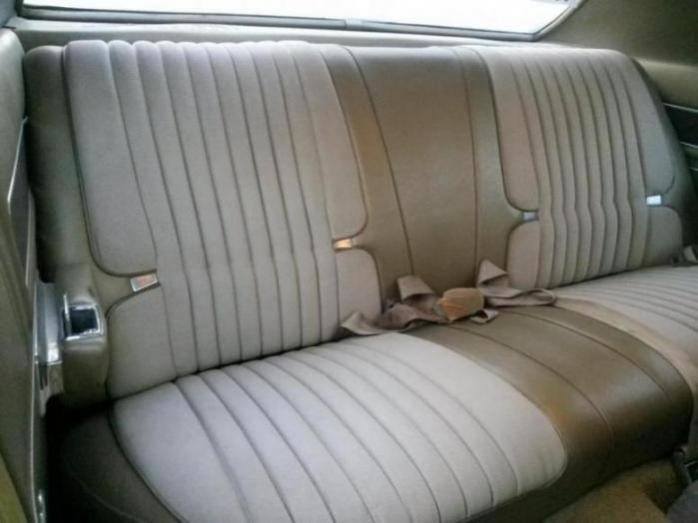

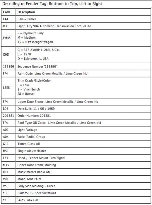

According to the earlier post the Y16 was a stock ordered car and the Y14 was a special order or customer ordered car??? The weather broke here today so I will have a bunch of additional pictures to post tomorrow. It has the green and gold interior. The seats look like the second picture of the 3 that were posted but two-tone light metallic green and gold. Thanks for all the help guys. Again 12k was a starting point I will consider any reasonable offers. But mechanically the car is 100%

From what I understand Y16 was sales bank Y14 is special order car.
Y16 is a sales bank
Y14 is a "sold car" (no matter if a customer ordered it or the dealership wanted a specific car with a certain colour and options)
But it is not a "special order car". That is Y39. It means it has some oddities/differences from a regular production car

It was a sold car (Y14) and special order (Y39)
The special order can also be identified by the "K" in the VON
attention: There was NOT always a second tag saying special order
