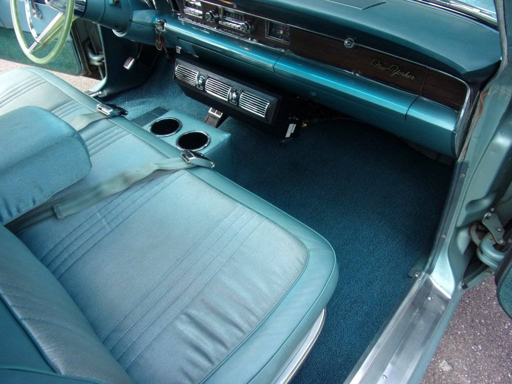

The 65 Town Sedan is doing great, after a lot of sorting through a lot of stuff. So now on to the interior....the foam on the front seat has deteriorated over the last 58 years, and while the seat cover is in good shape, the foam is all butt gone (sp intentional). SO, as a die-hard do-it-yourselfer, I'm wondering if I can peel back the bottom seat cover, and insert some new foam under my butt, maybe a couple of layers of 1/2 carpet padding.
Has anyone done anything like this? I did it once on a '64 Dart, and it actually worked pretty well. Thanks!
