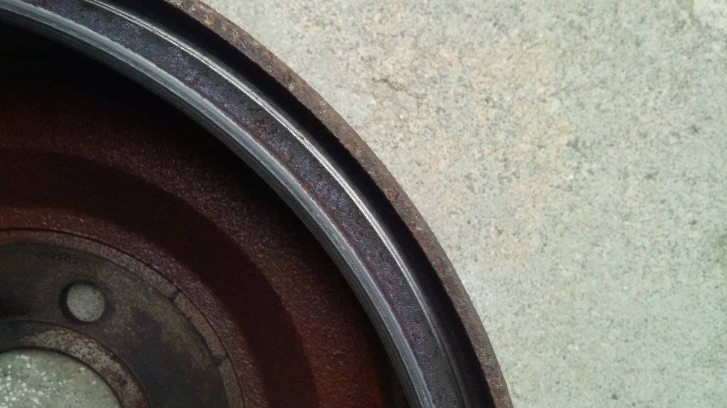

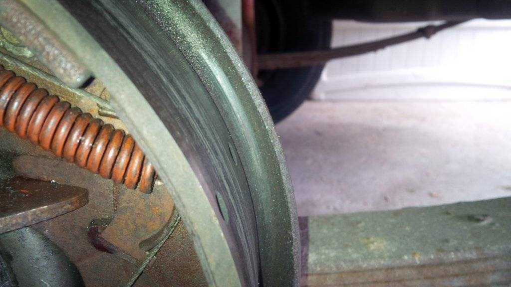

Pulled the drum today and there appears to be a wear mark on the backing plate and on the the drum. Can I just 'massage' the spot on the backing plate with a hammer or grinder? The axle seems to be snug.

Wait a hold it! If the drum is rubbing the backing plate then something is wrong.... grinding it may stop the noise but could hide a problem.

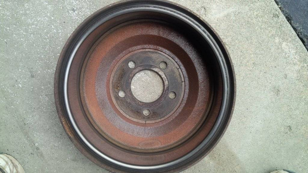

Here's a pic of the inside or the drum. There does appear to be some crud on the inner flange surface.
Check side to side movement of the axle as well as the in/out end play. Use a pry bar or big screwdriver, not just your hands.
