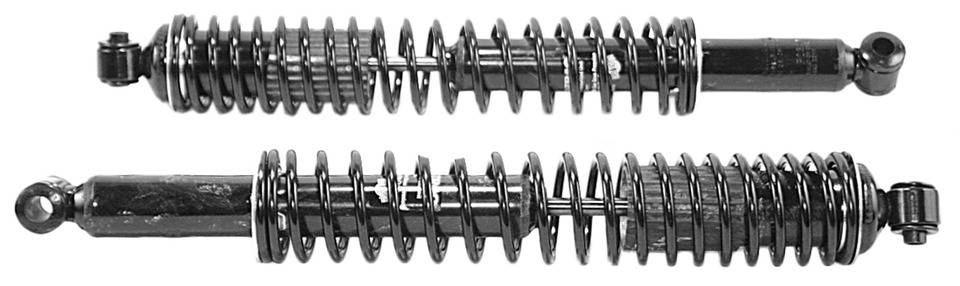

Monroe offers coil overs.
58577 :: e-Catalog :: MONROE® SHOCKS & STRUTS

I don't have much to compare to except for old weak shocks but installed the Monroe's not because I was sagging but because of the rare occasions I have a few people or extra weight in the trunk. Anyway they seam to ride just fine. I wimped out because I wanted to experiment with some of these Rancho adjustable shocks. They are a few of these that should fit. The pics are usually generic and the the parts sites say they don't fit but if you compare the shocks that do fit to the detailed Rancho specs, I think they do.
