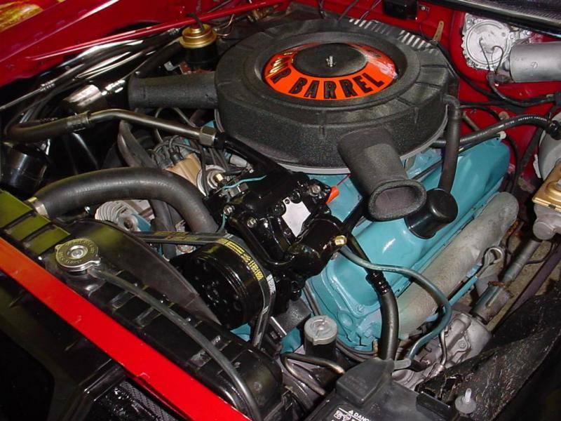

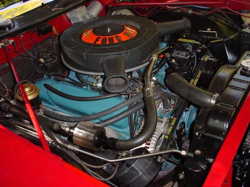

Aside from a few decals and stickers the underhood portion of Jezabelle's assembly is done. Runs as good as it looks to.

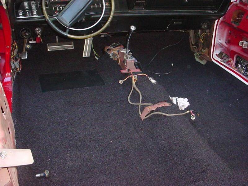

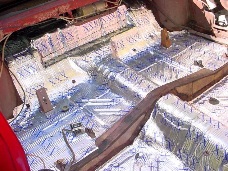

I'm starting in on the interior with some sound deadner on the floor and a new carpet. Also installed the well liner.
I've got one power window giving me a fit but should have it working tomorrow.

Are you putting some dynamat inside the doors also?

[QUOTE=Greg B.;29868]Is that sound deadener Dynamat or a different brand? Any recos on sourcing or best pricing?[/QUOTE]
The sound deadner is called "rattletrap" and is identical to "dynamat" at half the price.
It's a adheasive rubber/butyl type of material with a foil layer, 80M thickness, installed with a heat gun and roller. (they supply the roller and knife).
I got 50 sq ft in an 18" wide roll for $109.00 with free shipping. It's listed on ebay. I ended up using almost exactly 50 sq ft. on the floor.
I used a foil lined bubble wrap material inside the doors and 1/4 panels, Just glued it to the outer panels. (Made it a lot easier to see to work inside the doors).

Is that silver foil on that sound-deadener supposed to stay on or did you remove it before carped installation ?
