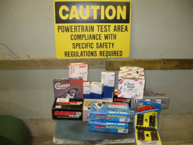

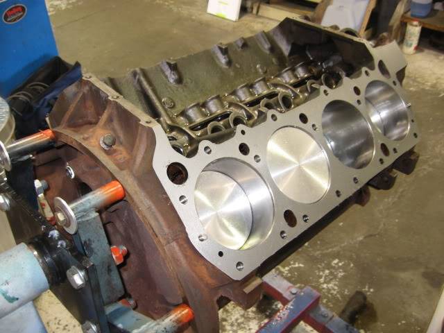

My 383 cylinders were eggo so it had to be bored .40 over. New pistons and machine shop time ate up the majority of my budget.
This is what 6 grand CDN looks like in a well built 383..
