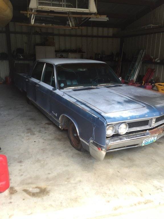

Look at that great project! feel free to tell us more about it, how you came to own it, it's history, your plans etc..

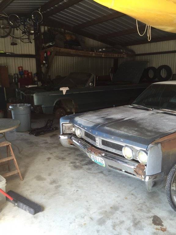

I bought this car in 2001 from a salvage yard for $300 for my son and I to rebuild. When he started high school he was to busy to work on it. It's been in my shop since then and I just now picked it back up. Started on the floor pans last week. I have a four door Newport that I bought as a parts car off eBay for $500. Had to drive to St. Louis to pick it up several years ago. The plan is to put it back as original as possible to use locally and long cross country road trips. With the help of you guys on this website I'm sure it will be done. Thanks.
