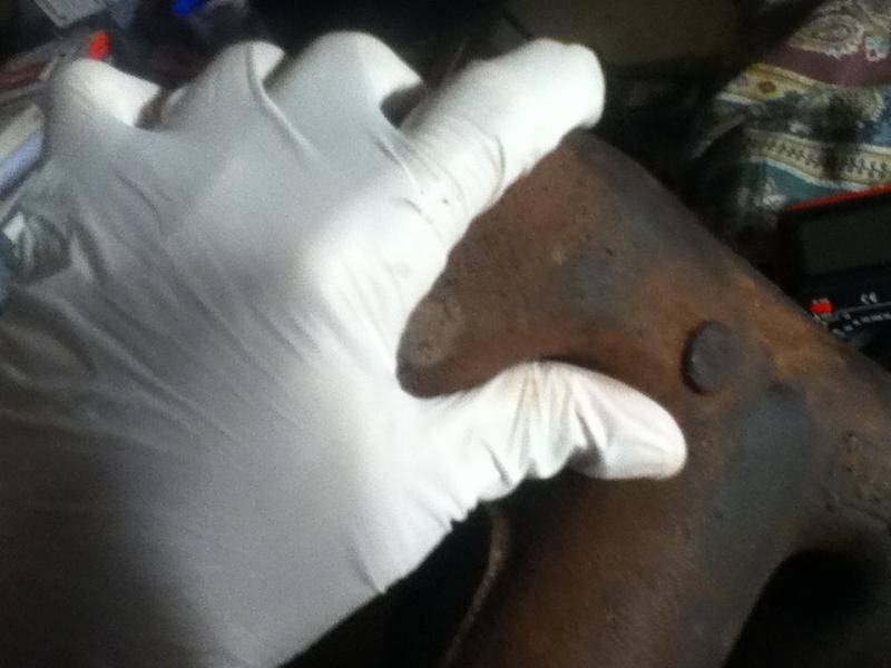

Ahhh.....lol, it wasn't that hard believe me. Good pair of pliers with grips will do. In fact the metal was very soft, which was surprising. Maybe it has something to do with all the heating/cooling cycles over the years. Who knows.

The leak at the crossover valve on my Imp is also loud enough to hear but not bad enough to smell. Nice work Gary. Bare hands? What did you run out of rubber gloves???
Why rubber, don't see any risks for pregnancy. ;)
Nope. I'm keeping the glove manufacturer in business,lol.

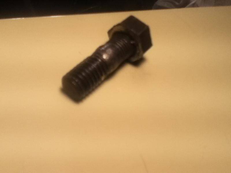

So here's the actual stud. Doesn't look bad to me, none of the threads are squashed or irregular. I wish I knew WTF is holding that nut tight. I sprayed it with PB Blaster and let it set several hours and it did absolutely nothing at all to it. Usually PB is pretty good with loosening stuff. Due to the damn nut not wanting to budge the manifold and the rest of the nuts have to go on first....which sucks trying to do. I'm gonna slop thread sealant on the tip and the rest with Ultra Copper and let it set for day.
