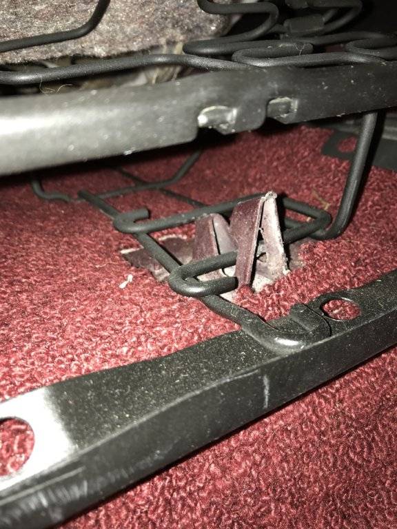

Ok that worked, removing the seat back was a bit harder as someone has lost the bolts and pushed the lower mounting rail you put the screw in, inside the box section it bolts to. Quick n lazy ... I don't suppose someone knows the thread size? Everything off the shelf here is metric so I'm going to have to order from somewhere. Surprised that the service manual doesn't contain any part numbers.
So the process was:
1) Remove seat base by pushing/lifting - someone hadn't fitted it right so one side was already free
2) Lift out seat back - honestly due to the incorrect seat installation this would have been really difficult in a hardtop.
3) Remove 2x screws under arm rest, armrest section including courtesy light can be moved away here
4) Remove screwed in stud at top rear of card - this is one of the top boot attachment studs.
5) Remove screw at top front of card, just inside the door close panel
6) Release 4x clips along the front edge of the card - very easy to damage your door card here, they're metal clips attached to the card with a 'hoop' style clip fitting that pushes into the holes on the metal skin. The clip is stronger than the card it's attached to. They can be easily released with a small tack lifter between the door seal and the front card edge - you can pull it away enough to check positions without causing damage.
7) Lift up to release card from window channel.
I adjusted the window while I was there, but the problem was actually one of the clips which had been fitted to the card backwards, trapped between the card and the metalwork. I also found at least 3 different cut & frayed speaker cables under there. Floor is reassuringly solid under there with only light surface rust in places.
