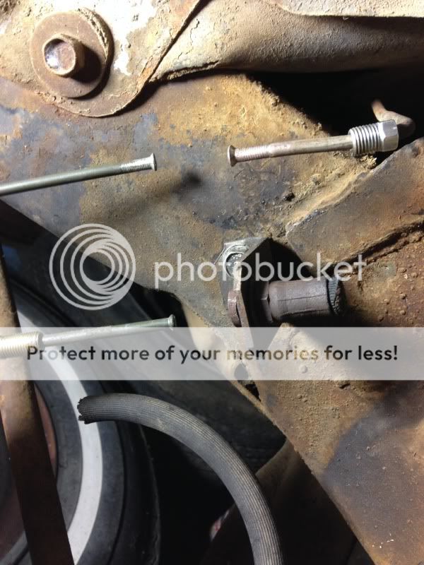

You can cut anywhere you want...
Just showing you the way I would do it.
I wouldn't want to shorten the brake line. You have to keep it loose to prevent stress cracking.

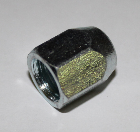

BULLCHIT! That is exactly where you buy them from. AutoZone, Advance, NAPA, Carquest...
You talked to an idiot.
i couldn't find the second nut you posted here. I hope what I did is ok.

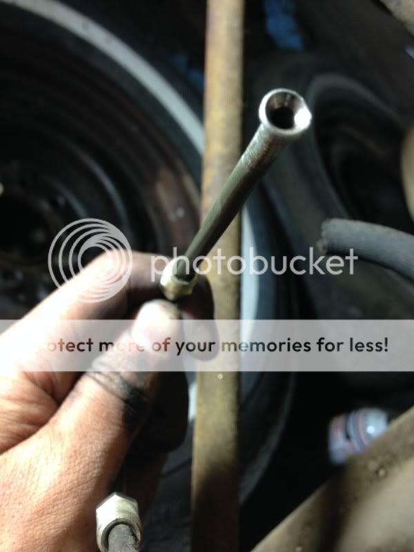

Yep, you want to make sure the double flares are done right. Good job!!!

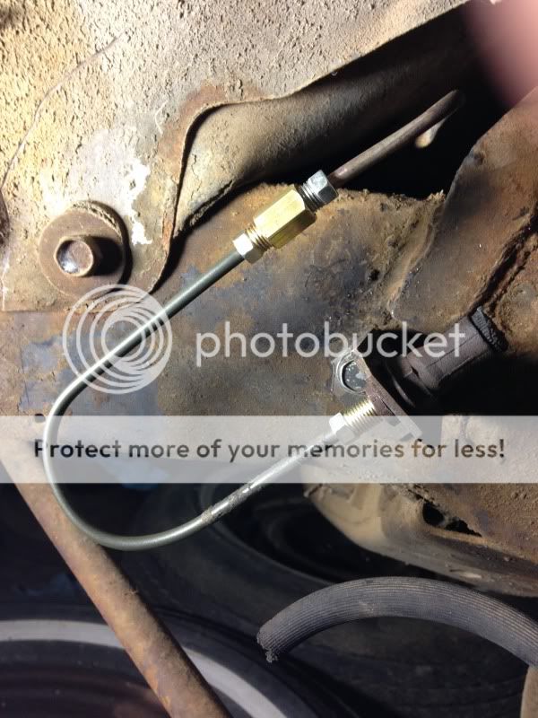

I ended up renting the double flaring tool from autozone. Worked out great.
Great thinking!! And your repair looks perfect...well done!
