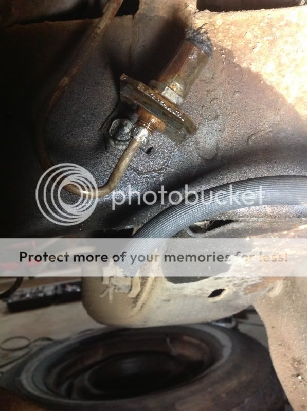

Got the line wrench and got one side off. Did too much damage on the other side. It's pretty stripped. What are my options?
You can even see the line started to bend as I tried. I tried popping off the clip and failed.
Looks to me like you'll be replacing that steel line. You may get lucky and your local NAPA will have pre-made line in a length that's close to the piece that's screwed up.

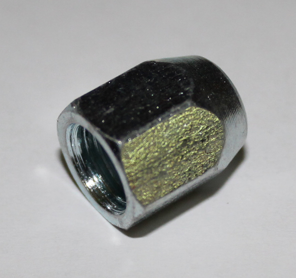

couldnt I just cut right behind the stripped fitting? also checked with autozone and they dont carry these fittings. I assume its 3/8 line and 3/8 male and female connectors? found copper line online but would like to put whatever type is stock.
Believe the brake line size is 3/16" ? Bring the old fitting down to the auto parts store and they can hook you up with the right line. And copper is a NO NO!!
