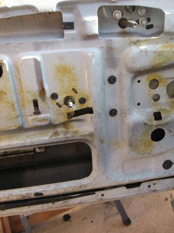

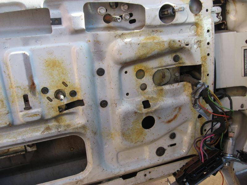

I've read lots of warnings to be careful, so yours isn't falling on deaf ears, thank you. However, I've read in several places that the motors can be removed safely. I'm just trying to figure out how. Or, failing that, get a little more detailed instruction than is in the FSM. Here are two pictures of the door without the panel.
What are the next steps?

Okay, thanks. In the photos above, it would be the black-oxide bolts that hold the regulator, right? And it looks like my window is almost in the position it needs to be to take it off the regulator: You can just see it peeking out into the access panel.
Am I on the right track?

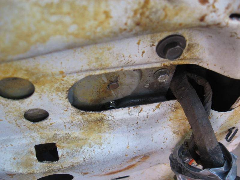

And by the way, guys at the Imperial group insist that you can get the motor out safely by leaving the regulator attached to the window. They say to remove the three bolts that hold the motor to the regulator, and leave the window in the up position. Two of the three bolts are visible, but you need to drill a hole in the panel to get access to the third one. If that's correct, what are the three bolts? In the photo below, you can see one of the bolts looks like it goes on the motor. The second one is below it, partially shrouded by the panel. That implies that the third one is above the visible shaft. Thoughts?

Personally i think the first time around you should remove the regulator assy just to familiarize yourself with how the setup goes together behind the panel and then also see how the motor is mounted to the regulator in situ. Then whenever you have to do pucks again in the future you can take the Imperial.net route to removing the motor. And yes removing the three black phosphated bolts in the middle along the horizontal will set the regulator free, i cant offer much more advice as it has been years since i have removed one of these.
The three bolts are the black ones the first being the one dues south of the remote mirror control and the other two to the left of that one by 8" or so and they are stacked. I can't remember if the one at the bottom comes out too as it might anchor the end of the motor. I can't personally see any benefit to a process that will require you to drill a hole in order to save a couple of minutes. If you use the repair that permanently replaces the rubber this will likely be the last time you do this anyway unless the motor itself quits.
