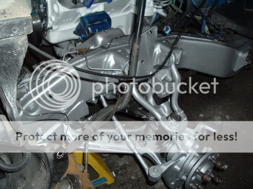

lve used rust bullet and it rocks....sandblast or not...apply rustbullet...then topcoat or apply dominion....lve used (Dominion) that stuff exclusively on all my vehicles...

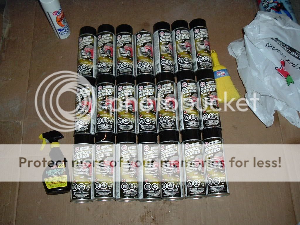

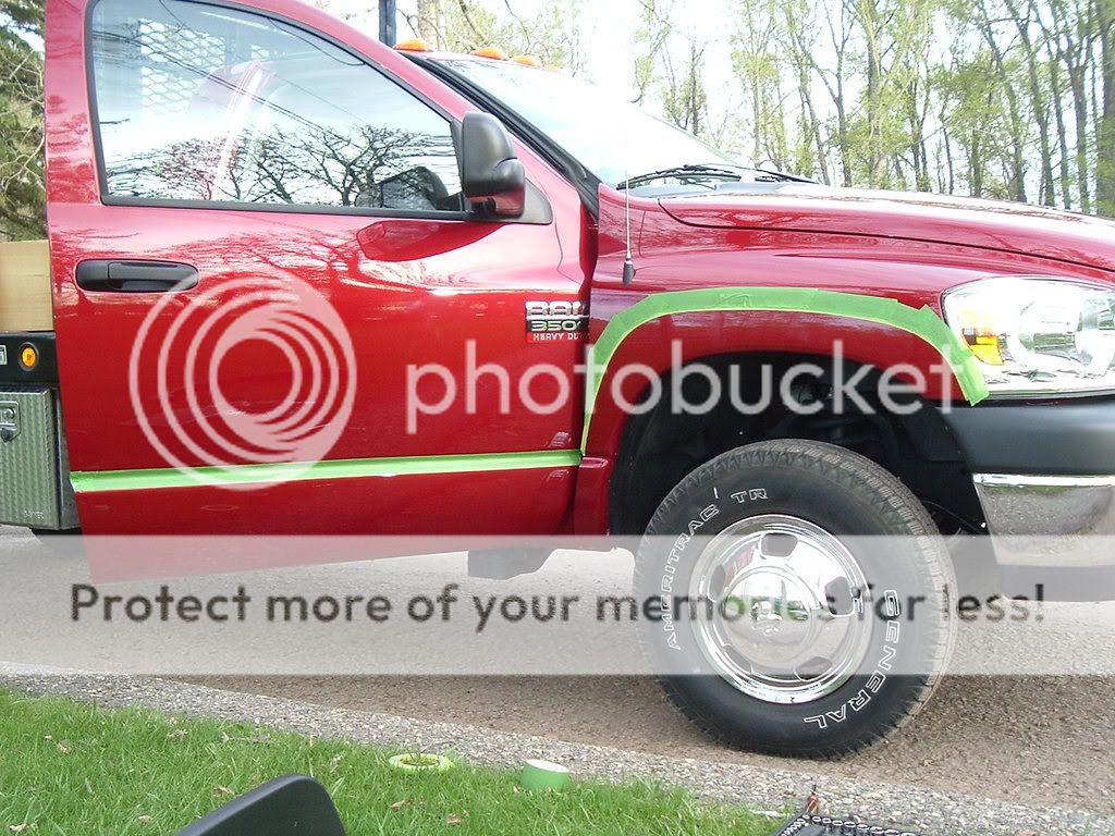

use expensive spray cans for exterior as it lays down realy nice...l grab the quart cans and just use a undercoating gun for undercarriage
l buy this stuff at crappy tire in the fall when they put it on sale..drops down to 4 bucks a can as to reg price of 8-9 bucks
works great on grills ect..

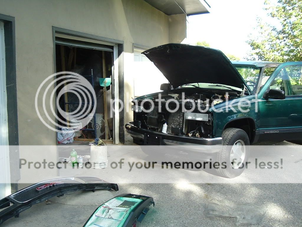

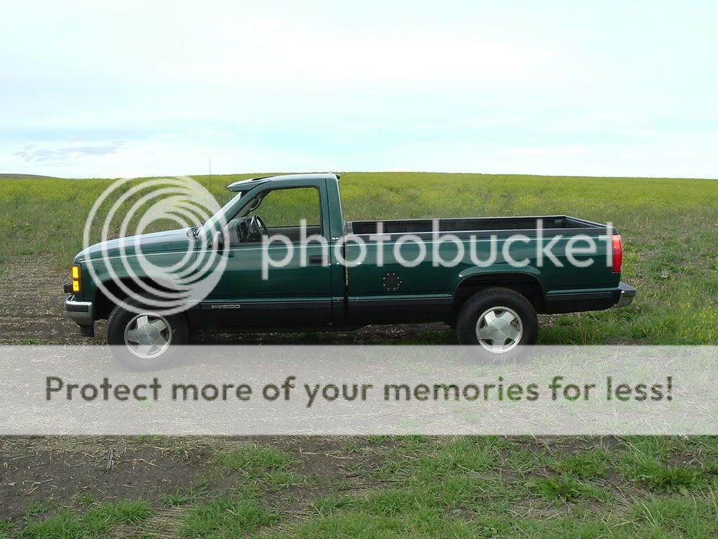

rust bullet on 91..basecoat before topcoat...rustbullets the best covering stuff lve come across and tough...not one complaint other than trying to get it offa hands

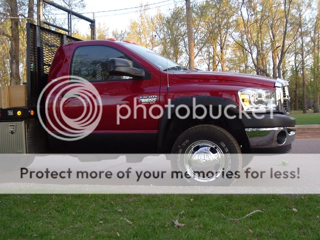

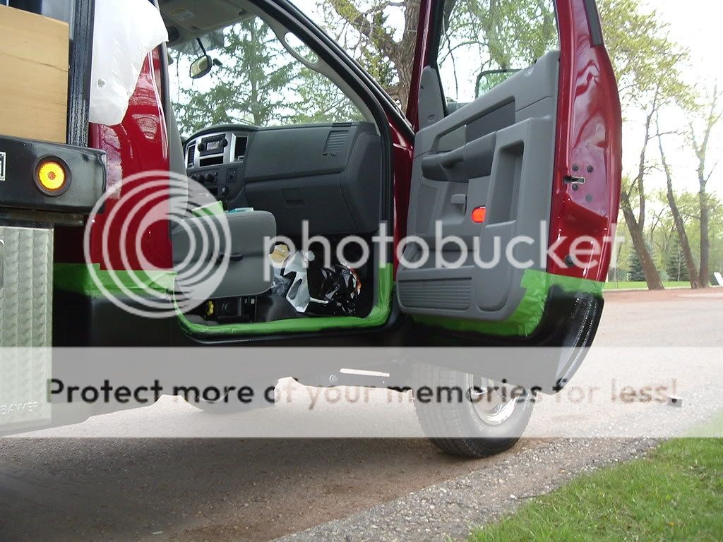

dominion on lower panels and grill...love this stuff...saved me alota rust issues
I've heard nothing but good about rustbullet. I can't wait to use it. Does it take a topcoat pretty well? I've heard it does, but takes alot of prep work to get whatever your topcoating with too stick.
Naw...easy to coat.....they have a black topcoat that go's over the silver...you'll see...
