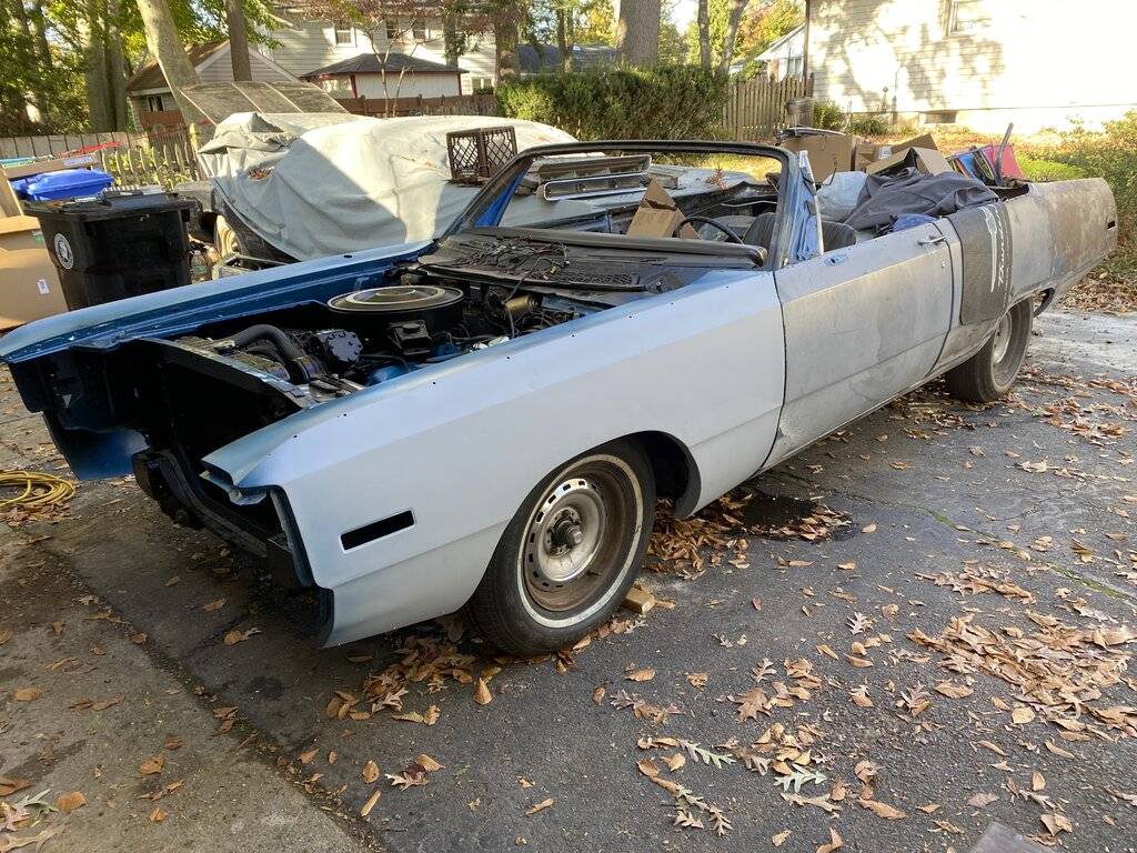

Resurrection of my 1970 Chrysler 300 Convertible

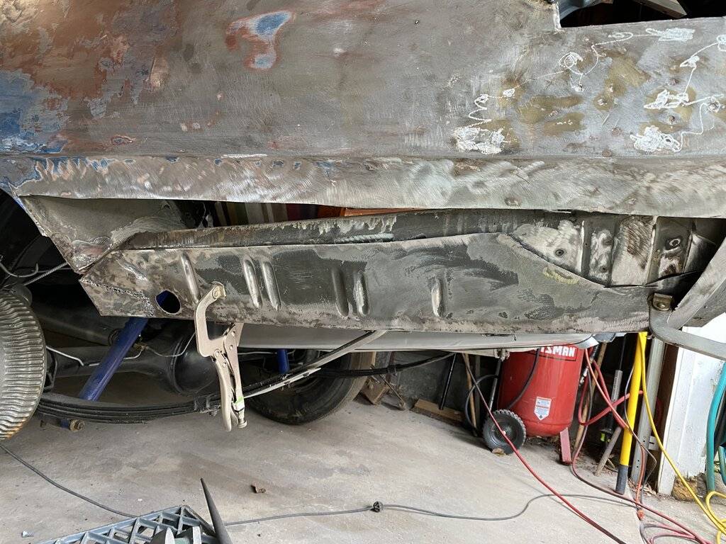

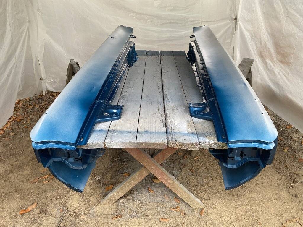

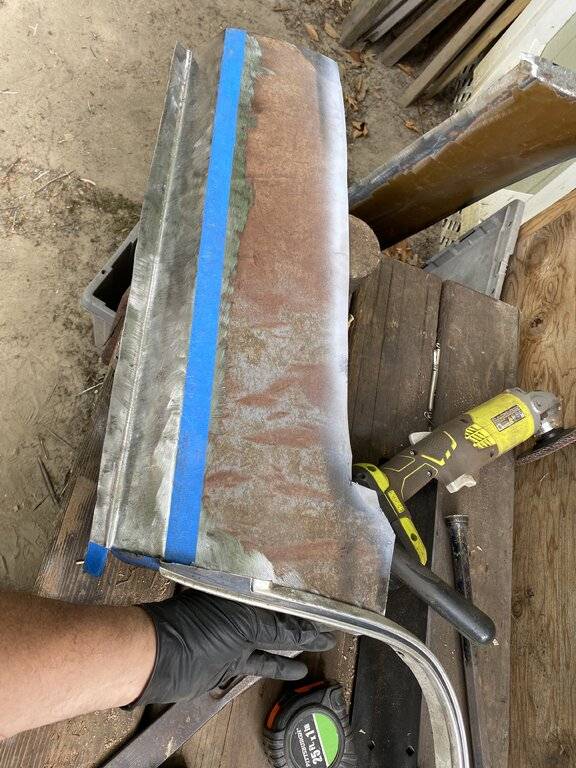

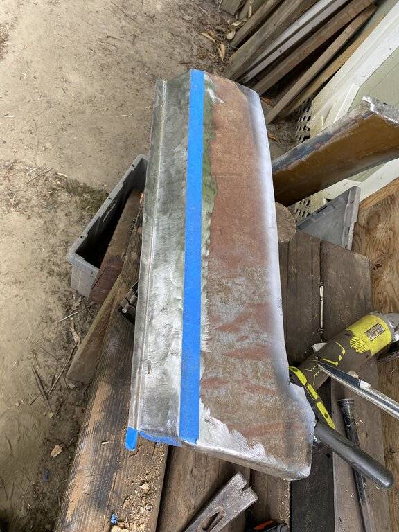

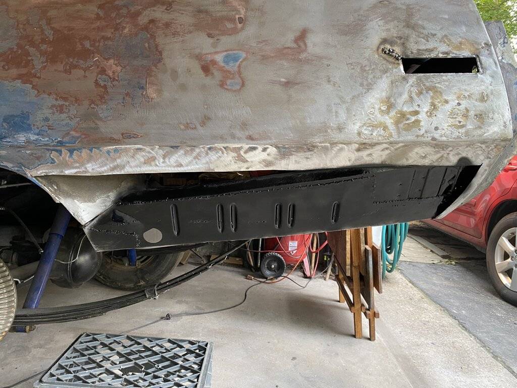

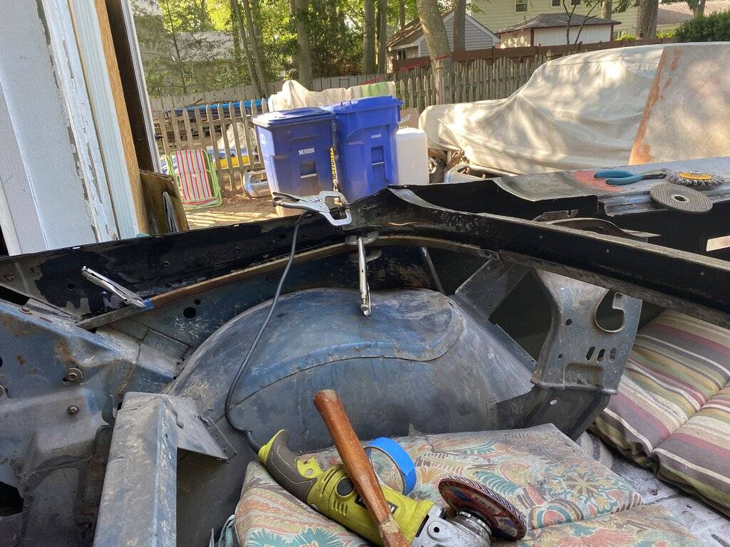

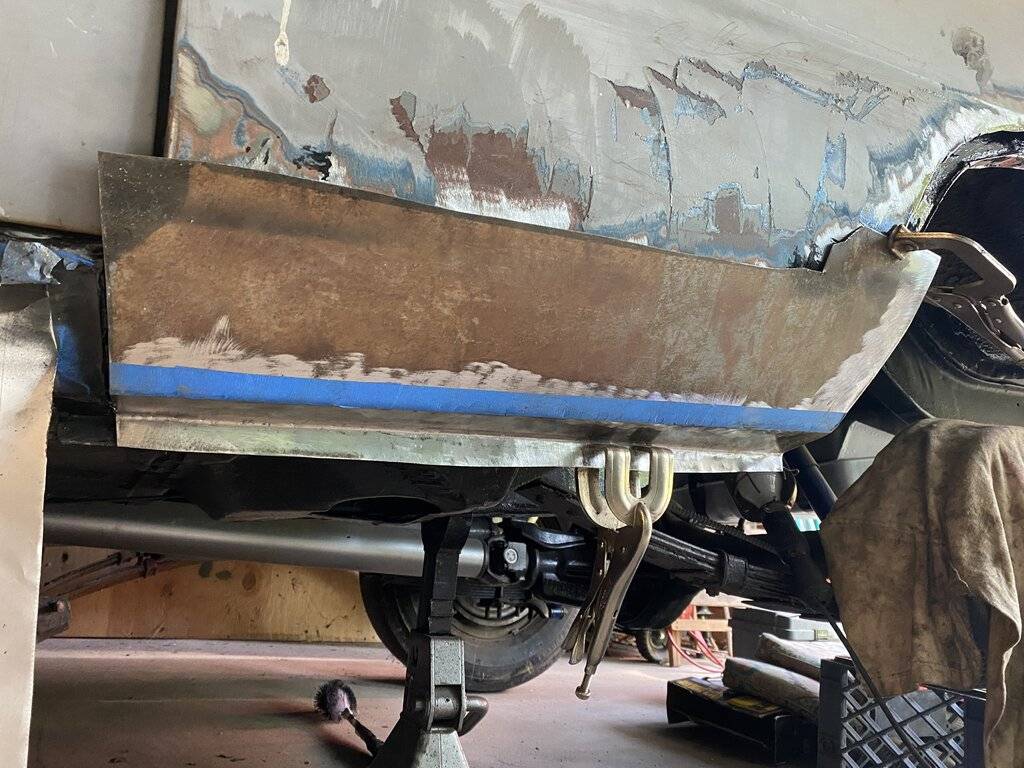

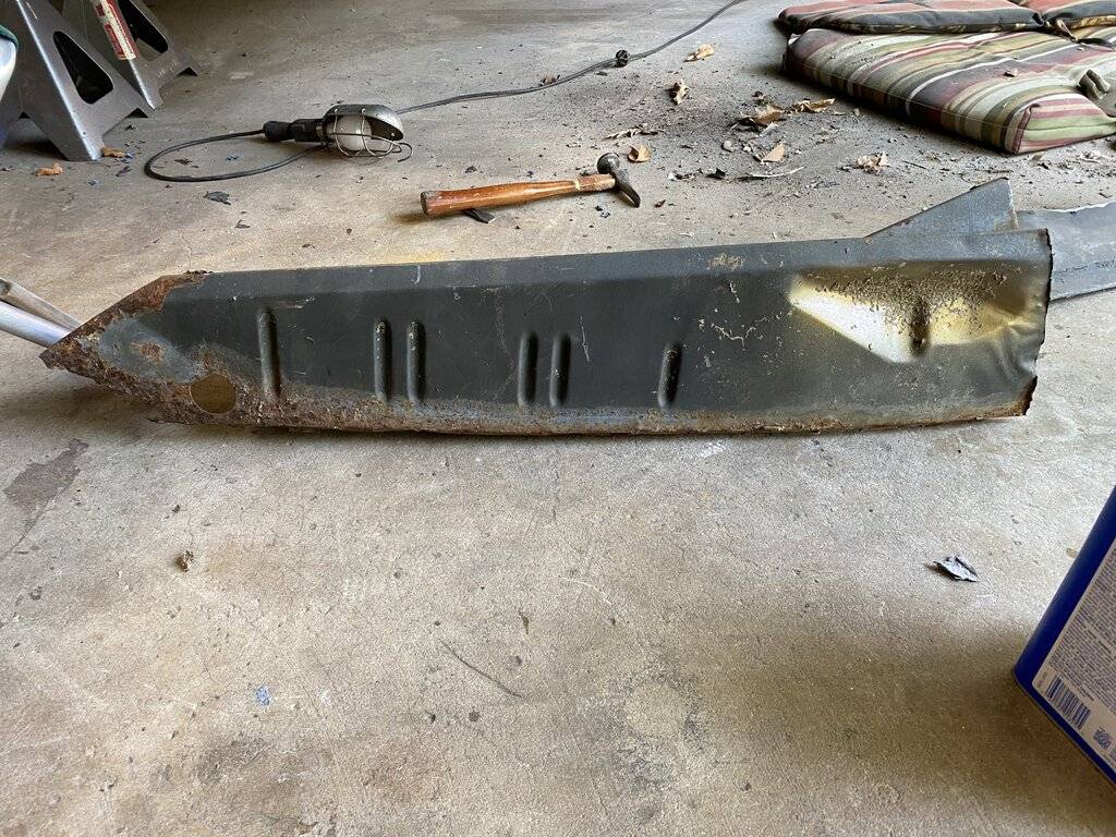

I didn't need to replace the center channel, so the repair is mainly on the corners.
Interesting cleat marks from the factory helped me line up the new parts.
Finally solid after all these years.

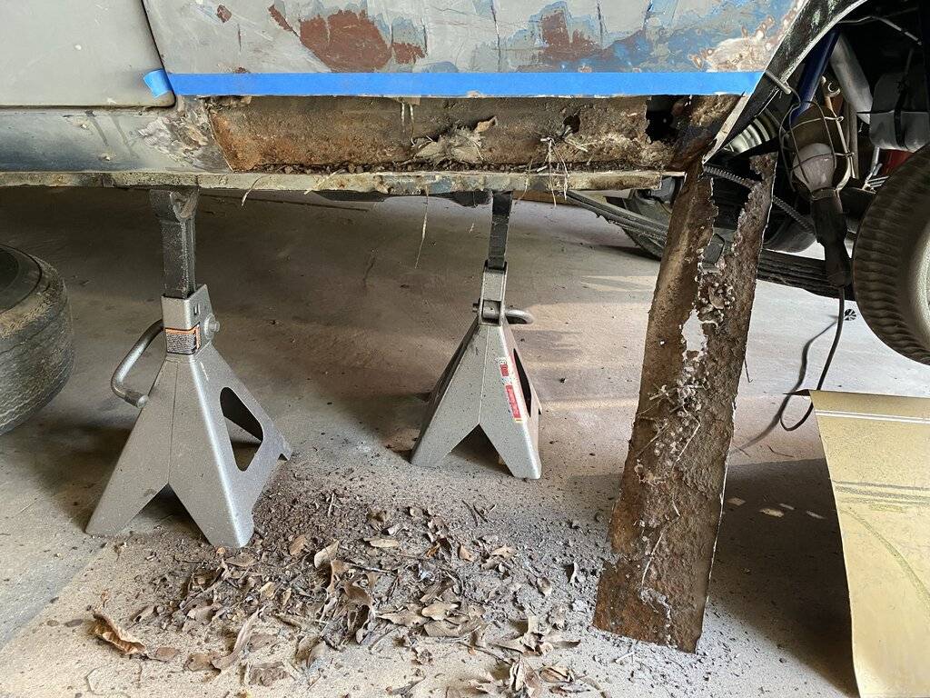

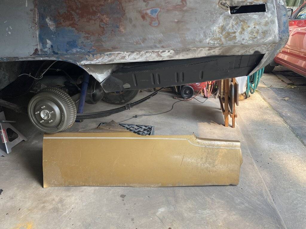

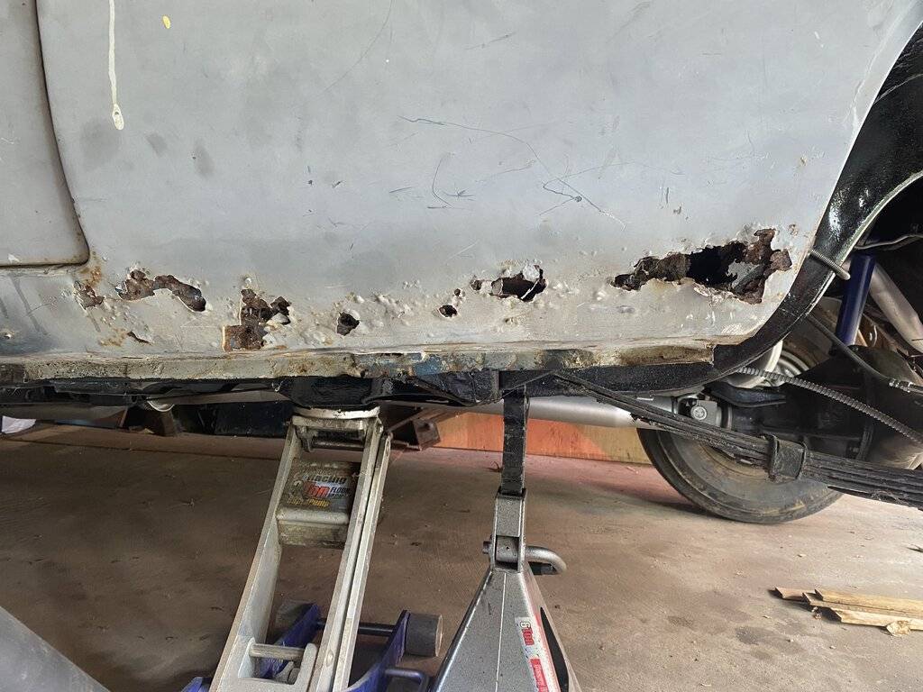

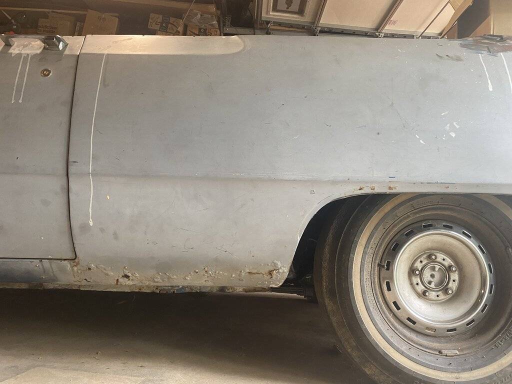

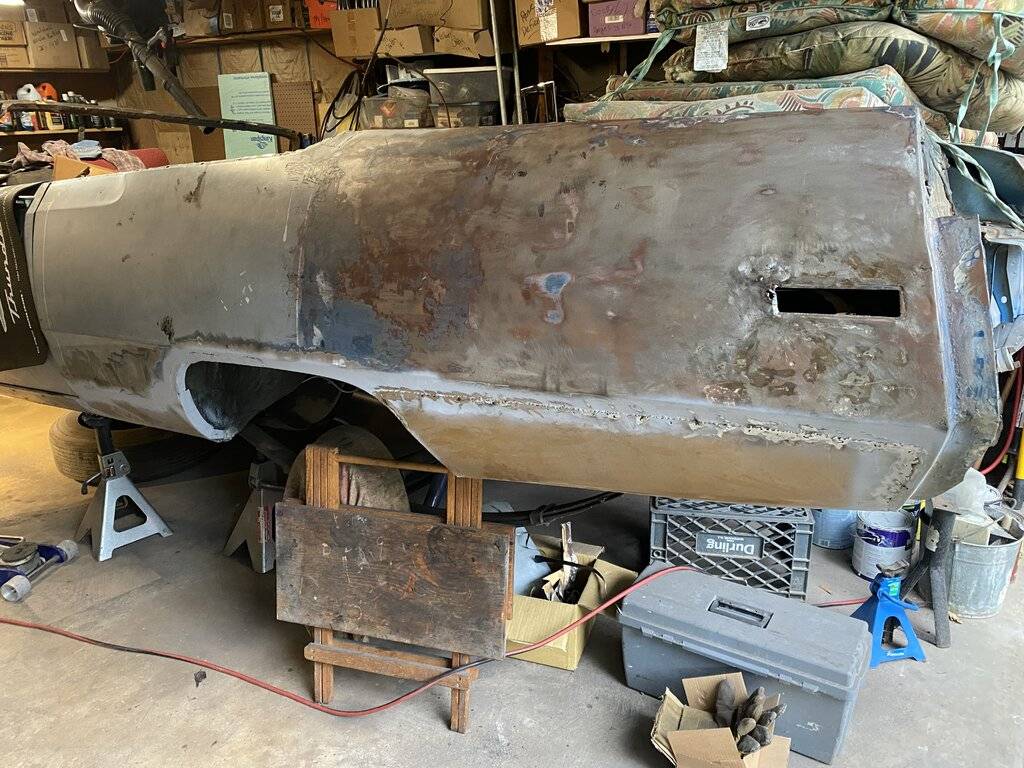

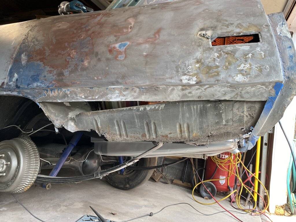

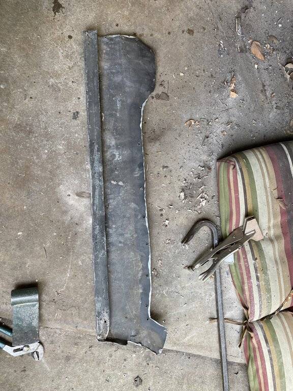

Next, it was time to start on the left side quarter and door.

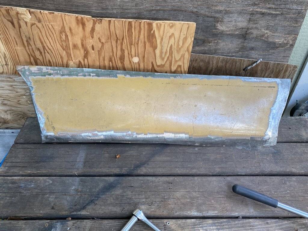

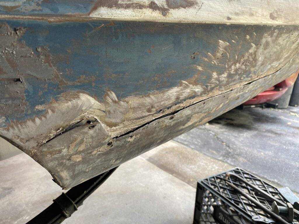

It didn't look too bad, until a couple of taps with the body hammer revealed the results of more 1990's repairs.
When I see this fall out, it's worse than a mouse nest. Screen doors and globs of old bondo....

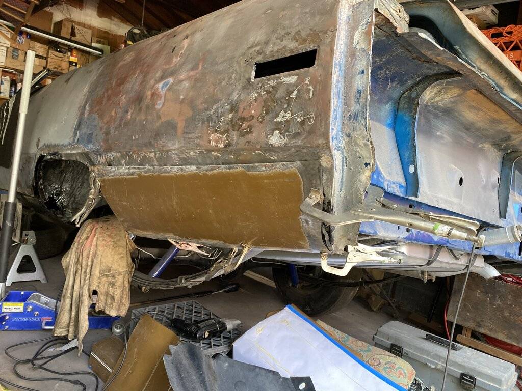

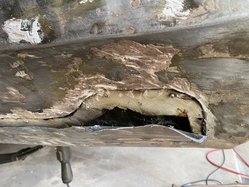

Oh no! More metal pop riveted and then covered in bondo. Did no one own a MIG welder back then??
Not only pop riveted, but right over OLD bondo!

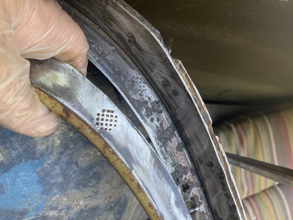

What were they thinking when this patch was cut out?
Yup, looks like I need an inner as well.

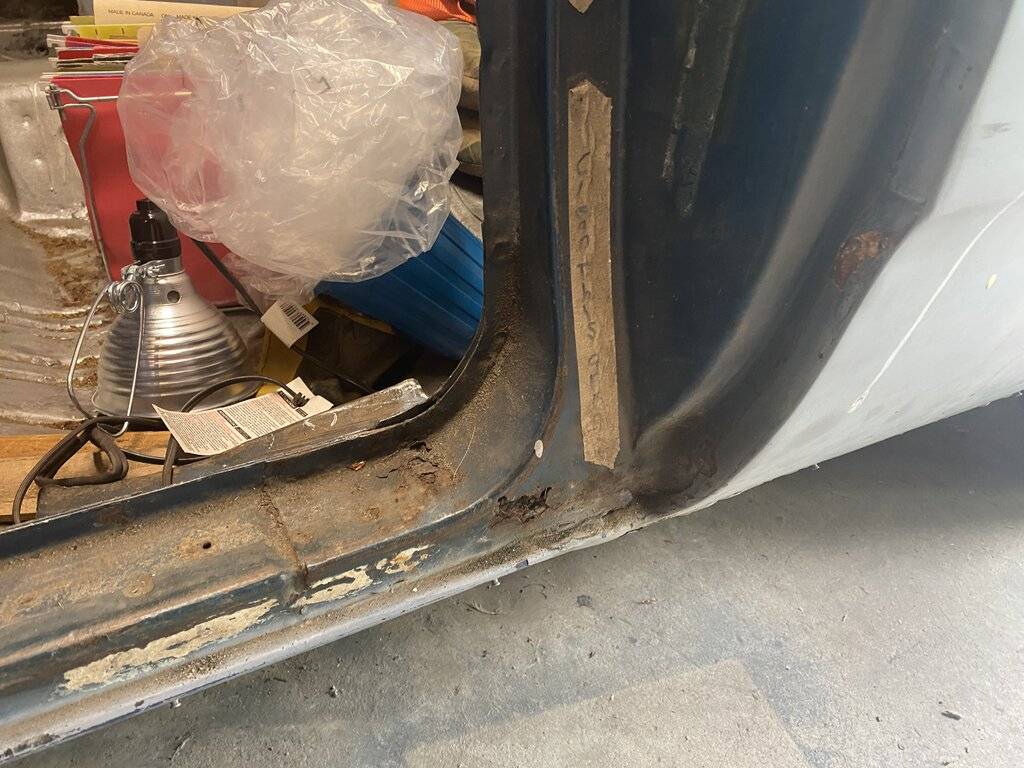

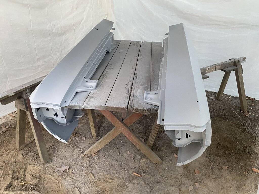

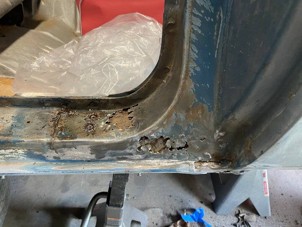

Door jamb typical rust repair. Again, a solid piece of the '73 NYB fits perfectly.

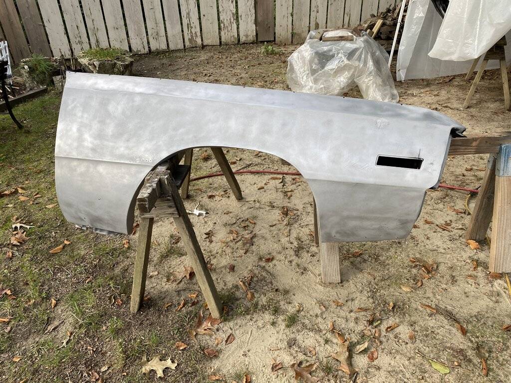

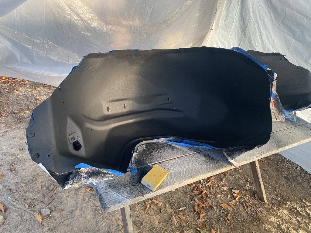

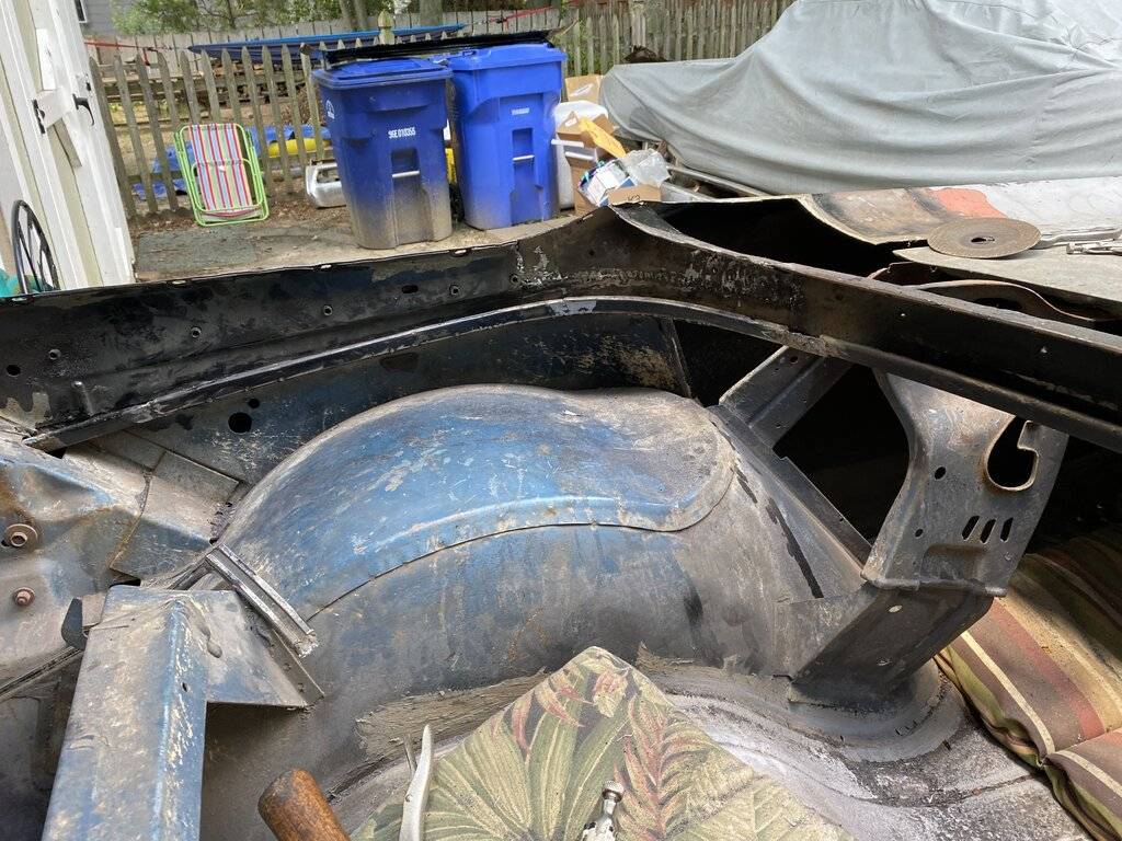

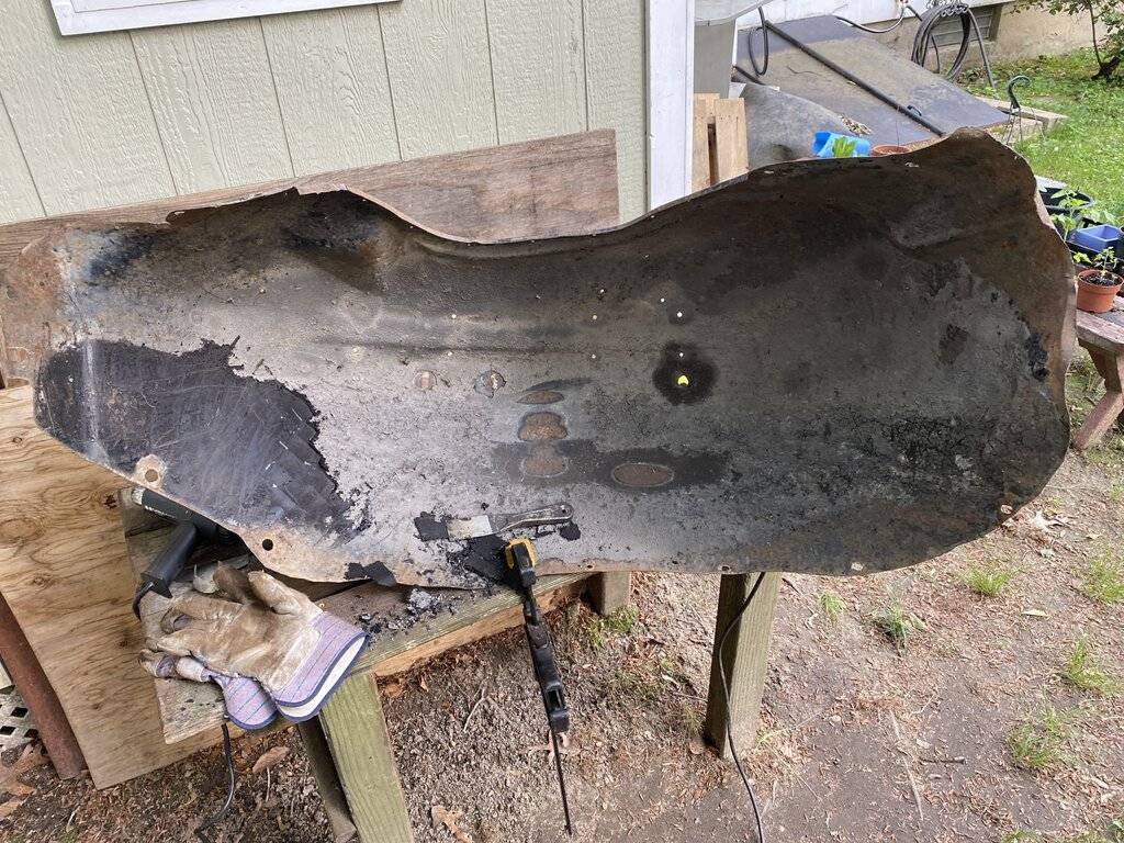

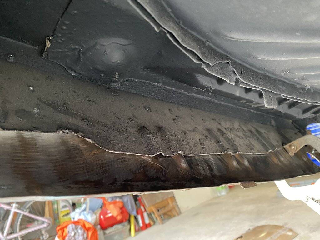

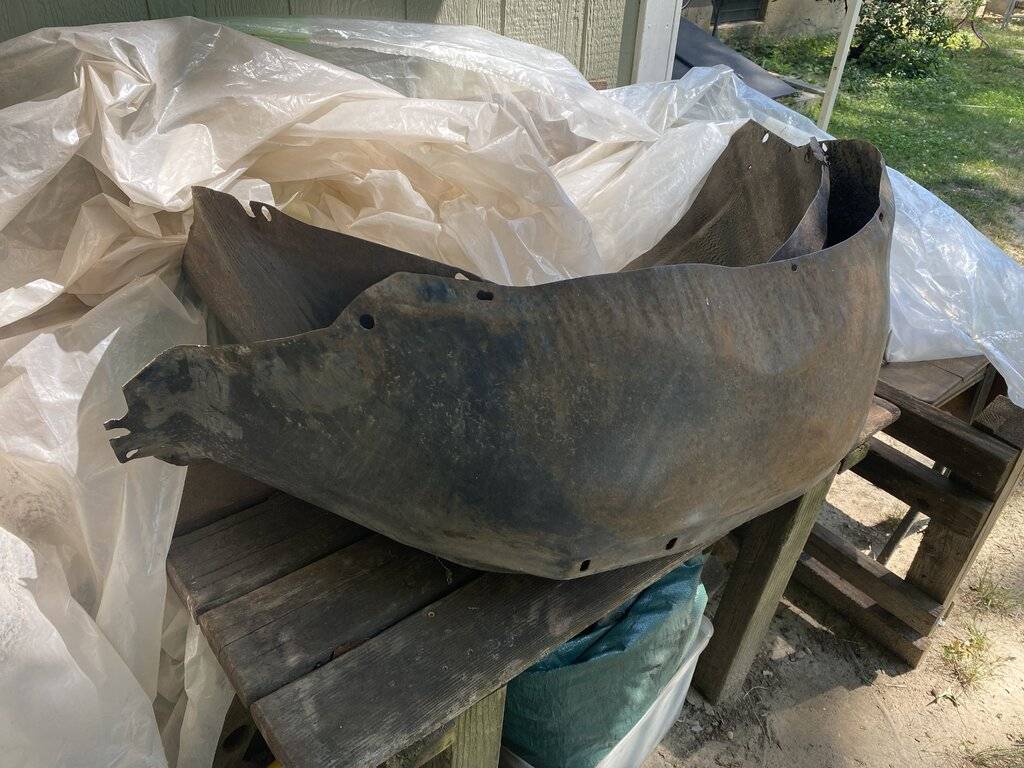

Work on the inner front fenders involved a lot of undercoat removal, then sand blasting with glass from the mobile blast unit.
3M body schutz for a new undercoat look.
Finally, 3 coats of Krylon semi-flat.

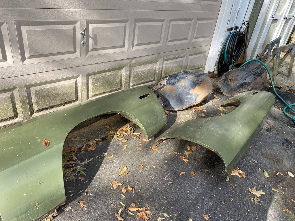

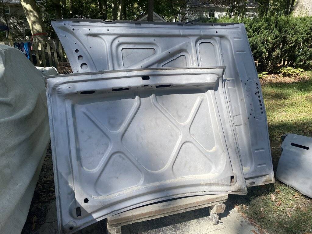

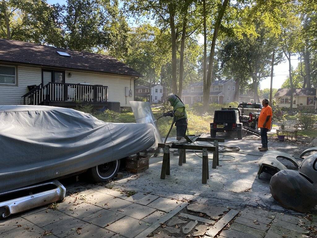

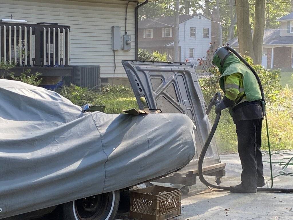

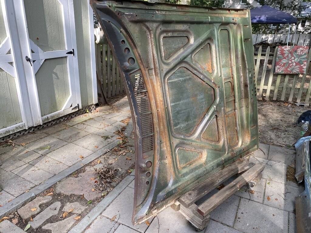

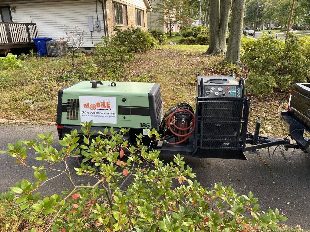

I was running out time for the season, so I hired these guys to blast all of the big panels. They used glass and water with a rust inhibitor. Four hours to blast the hood, deck lid, fenders, front and rear valance and inner fenders, done right in my driveway. Saved me 6months of work with chemicals and a hand grinder.

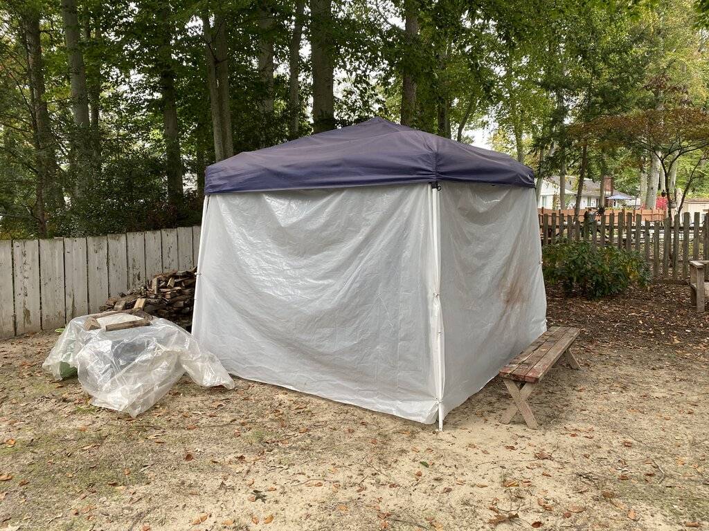

Ready for prime and paint! The new larger paint booth:

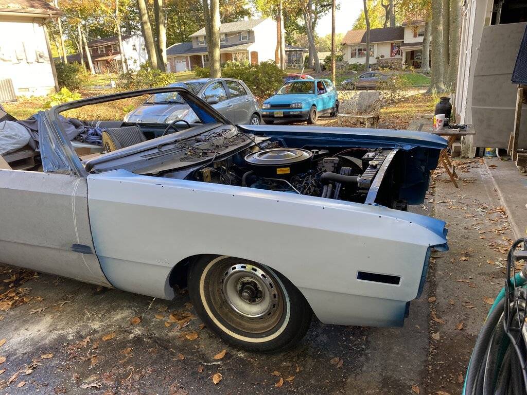

That's it for this year. Wishing everyone a happy and healthy new year!
Thanks guys! The goal this year is to get it road worthy, and actually drive the thin on the road.
