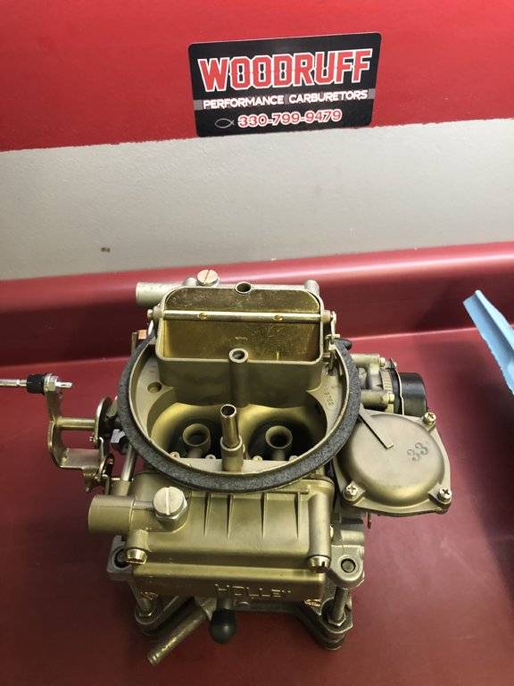

Ok, ORDER UP! Here you go Cazman. Here is your undercover 780. A little more work than I first thought integrating the Chrysler throttle shafts, but worth it. Side hung float bowls and a 3310-3 rear metering plate, Chrysler style vacuum pod, and I had to get a little creative on the curb idle adjustment screw. The Chrysler main bodies have a cast on boss that the screw goes through that 3310’s don’t have and the Chrysler throttle shaft won’t work with the 3310 screw. I can’t wait to hear it make music on your 505”
Wow, looks great. Thanks for integrating the original throttle linkage, not only will it look correct but it will save me time hooking it up correctly. I love the idea of this thing being set up for my stroker, but still looking stock.
I have always rebuilt my own carbs and I can’t tell you how many hours I’ve wasted screwing around with jets and valves. It will be a treat to have one done by a pro.
That's awesome Dave. I did not get mine running last year but I know when it starts in a month or so my 800 DP is ready to run.
I changed my combo a bit, I'm now up around 11:1 cr so that should work well with cam. Wishing for 10s low 11a will be a success also.
Cazeman that carb looks great. I know you will be grinning when the naysayers say that carb won't work.
