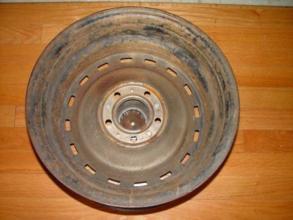

You have pics of the current condition of the rims, just to see how much work would be required ?
If the paint is just faded without rust going over with some small grit paper and repaint without primer is enough for example.

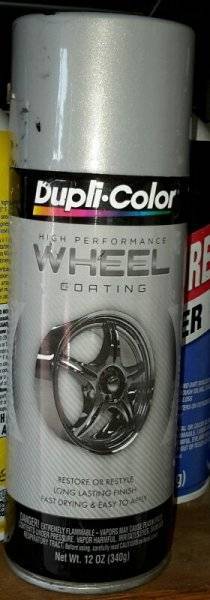

I use this from off the shelf from AZ.
I don't know if it is an exact match for Mopar Argent but the color seemsclose and it does have that little "sparkle" to it like Argent.

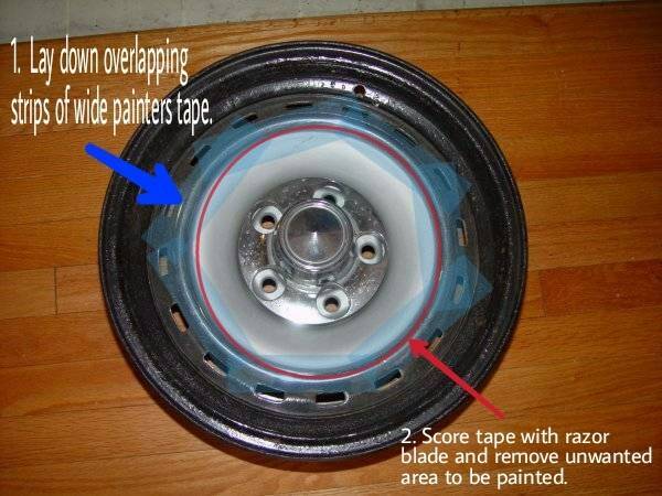

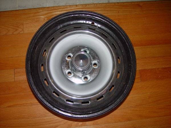

Masking tape has some flexibility so you can tear off short pieces and follow the round contour fairly easily. Worked for me. I just made sure everything was clean and didn't worry about primer. Most of the indoor/outdoor rattle can stuff is designed to work in less than ideal conditions.
