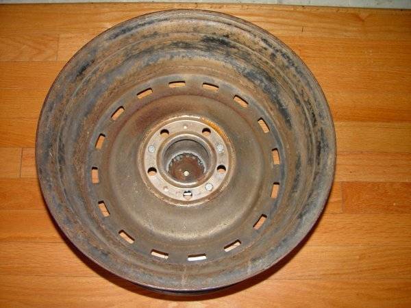

I'm going to spray those area's gloss black.
It'll probably take me a couple of weeks to get done. I'm going to spray them on my deck on nice weather days and in between work (50+ hours a week).
I took and angle grinder mounted wire brush to the back sides. Cleaned them up with varsol and then sprayed with rust converter. Lastly the back sides were finished with gloss black paint.
My back sides are pretty rusty. I might hit them with a wire brush on a drill and spray with rust converter and then gloss black.
