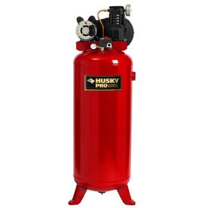

I have one of these cheapo units. Paid around $120 for it at Tractor Supply.

What kind of compressor power do you have running that unit? I've been looking at a similar unit but they seem to need CFM volume equal to what I have in my shop not my 20Gal craftsman 3HP at home.
60 gallon Husky Pro
It just about keeps up. It does take a time-out on a couple of occasions to catch it's breath.

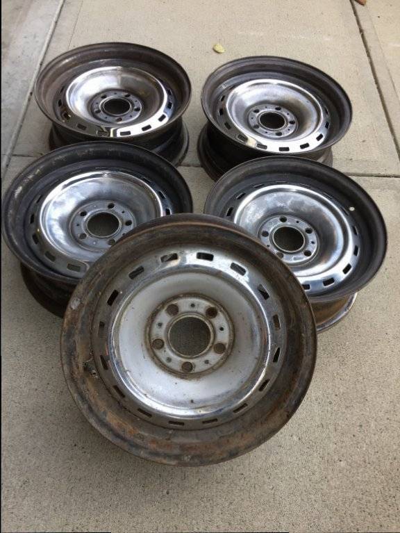

I'm using the info gleaned from this thread to restore a set of road wheels as well. After wire wheeling them and cleaning up the chrome they are ready for paint. I seem to remember someone here mentioning using a spray masking material to cover the chrome or using vaseline to protect the chrome or centers from overspray. If anyone has tried this method please let me know how it works. I also looked up the center domes and caps at work. The domes pn#3699011 are available at vintage parts they have 44 instock but no caps pn#3580365 - 1978 NYB used pn#3580360 which are also no longer available so if anyone has an alternative source please pm me. Ill post the vintage part price tomorrow once i talk to them.
Pics for you all...one rim untouched for comparison
