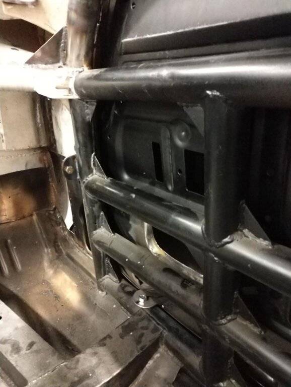

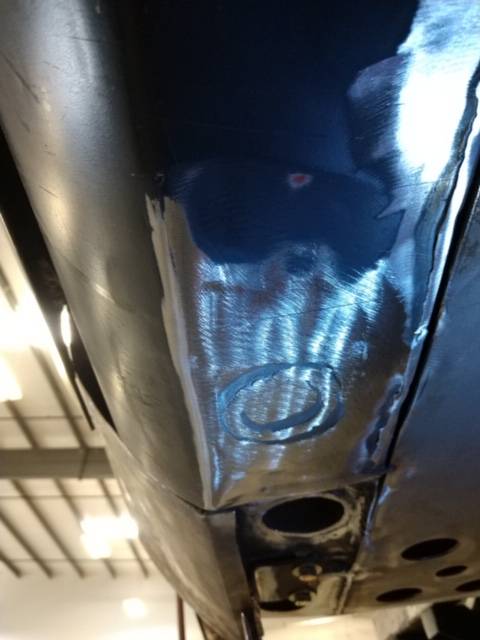

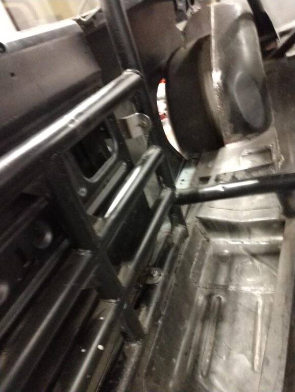

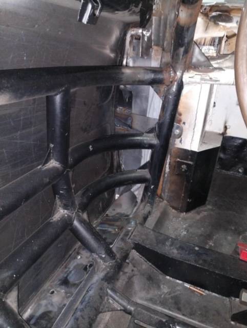

    More than you'd need, but here's the cage of my Nascar Daytona #88.
    Could be some ideas for you. Note the "A" pillar bars. Nice and tucked in, welded to the pillars. Lower "A" pillar and main hoop bars go through the floor, into the rocker. The rocker than becomes a structural part of the car. Tubes welded to rocker bottoms.
    Hey, it's free strength. It adds to the lower door bars.
    Left door bars were curved out, per the rules. Door is split to keep the glass working.
    Right side - door is in one piece!
    Agreed as stated above: a one of a kind custom install.
