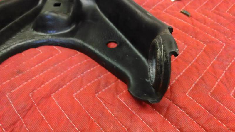

Brilliant move today crushed the lip around my right side control arm when pressing in the bushing. My socket wasn't deep enough and ruined it before I realized it. Anyone have an extra one laying around?
Bring it to someone or a shop that has a torch set.
Heat it up red and hammer it back, dunk in water....

Really I figured I ruined it. My cousin has a torch big enough to make it red. I'll give it a shot.

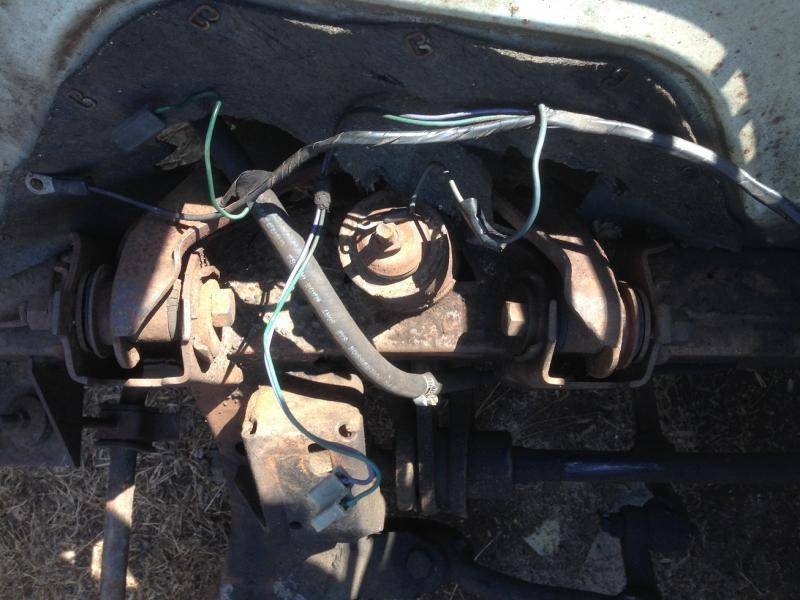

Here's a pic of the right (passenger side)upper on my 65 Newport. Taken just today. I'll PM you prices shortly.

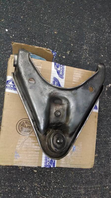

Thanks C Body Bob. I received my "new" control arm last week and pressed out the bushings and cleaned it up this past weekend. I am still waiting to remove the ball joint, the guy I was going to borrow the socket, for the removal, is on spring break I believe. The bushings came out of Bob's control arm easier than my old one so I am hoping the ball joint is cooperative too.

glad you got your problem solved but I can't understand why no one would fix the old one for you looks like a easy repair, If it was mine I would have fixed it in a heartbeat
