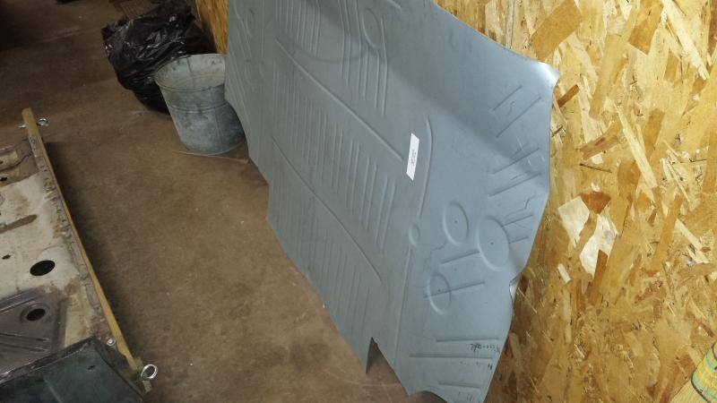

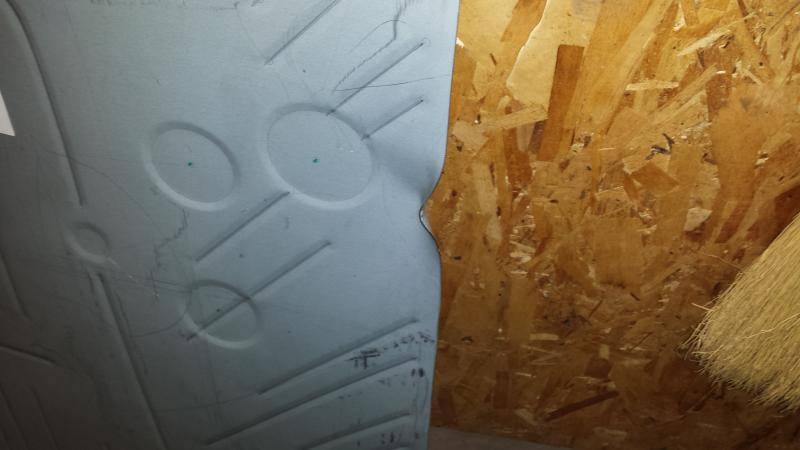

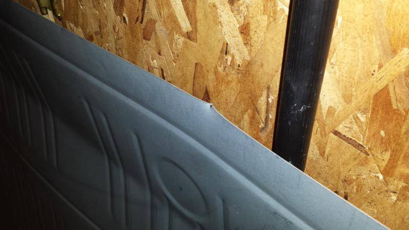

My new trunk pan arrived but was damaged. C2C Fabrication was great to deal with on the phone. they are shipping another right away although I am not ready for it.

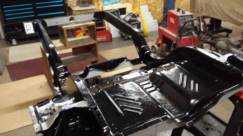

The rear frame as as close to being ready as it can be to being welded into the car now.
I added the dual exhaust bracket today which I had saved from the original floor of the car.

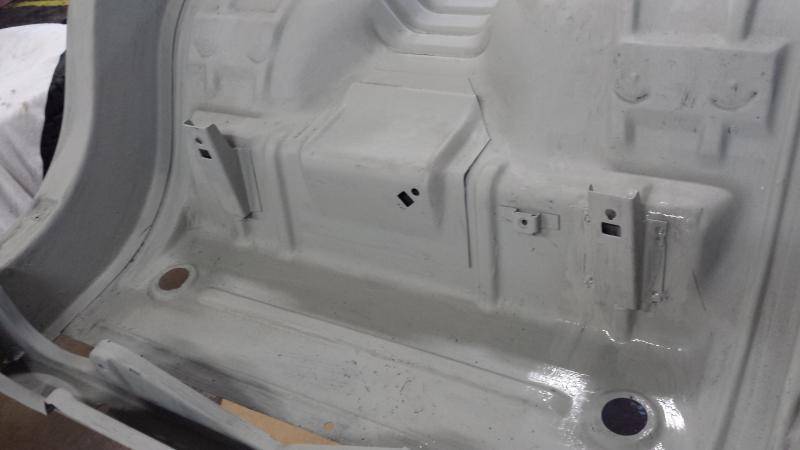

Primed the top side of the rear floor pan and inside the rails as well.
I just have to prep the side rails a bit first then weld it into place once its' lined up.

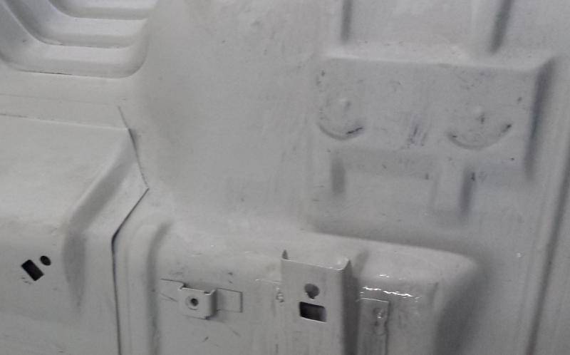

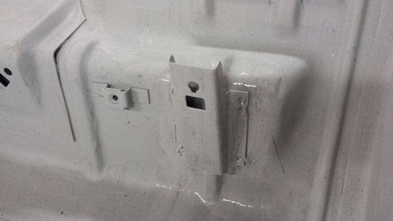

BTW, if anyone knows which dimples I should be using to mount the seat belt anchors to?
There are 2 side by side on the rear of the floor pan and I don't know which ones to drill and weld the anchors to the floor.:tard:
Added some satin black paint to the under side tonight. I figured it would be tons easier to paint and touch up later once ti was installed...

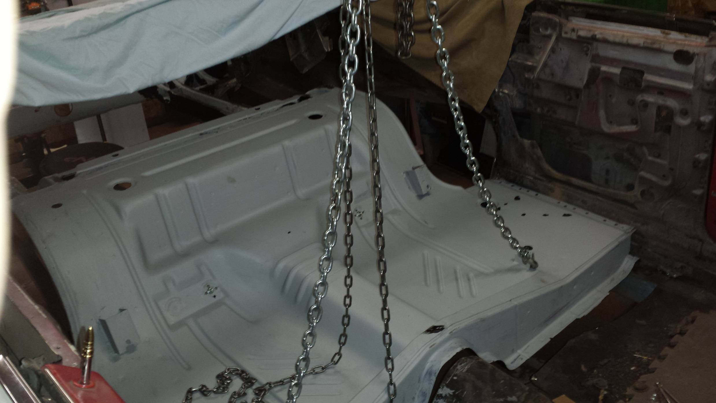

I am finally getting back to a concerted effort to finish the Polara

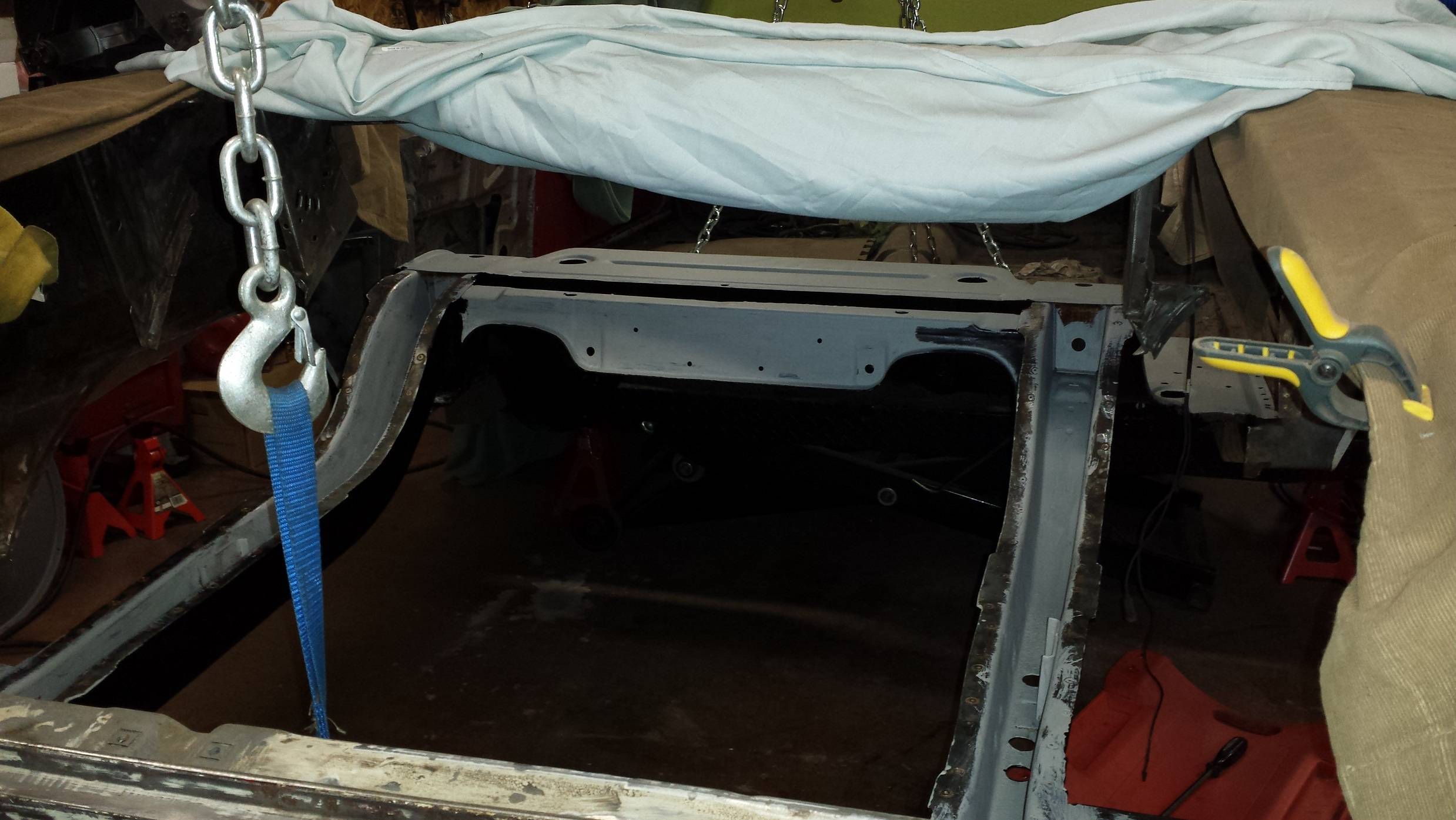

I dropped the rear frame section into place today!

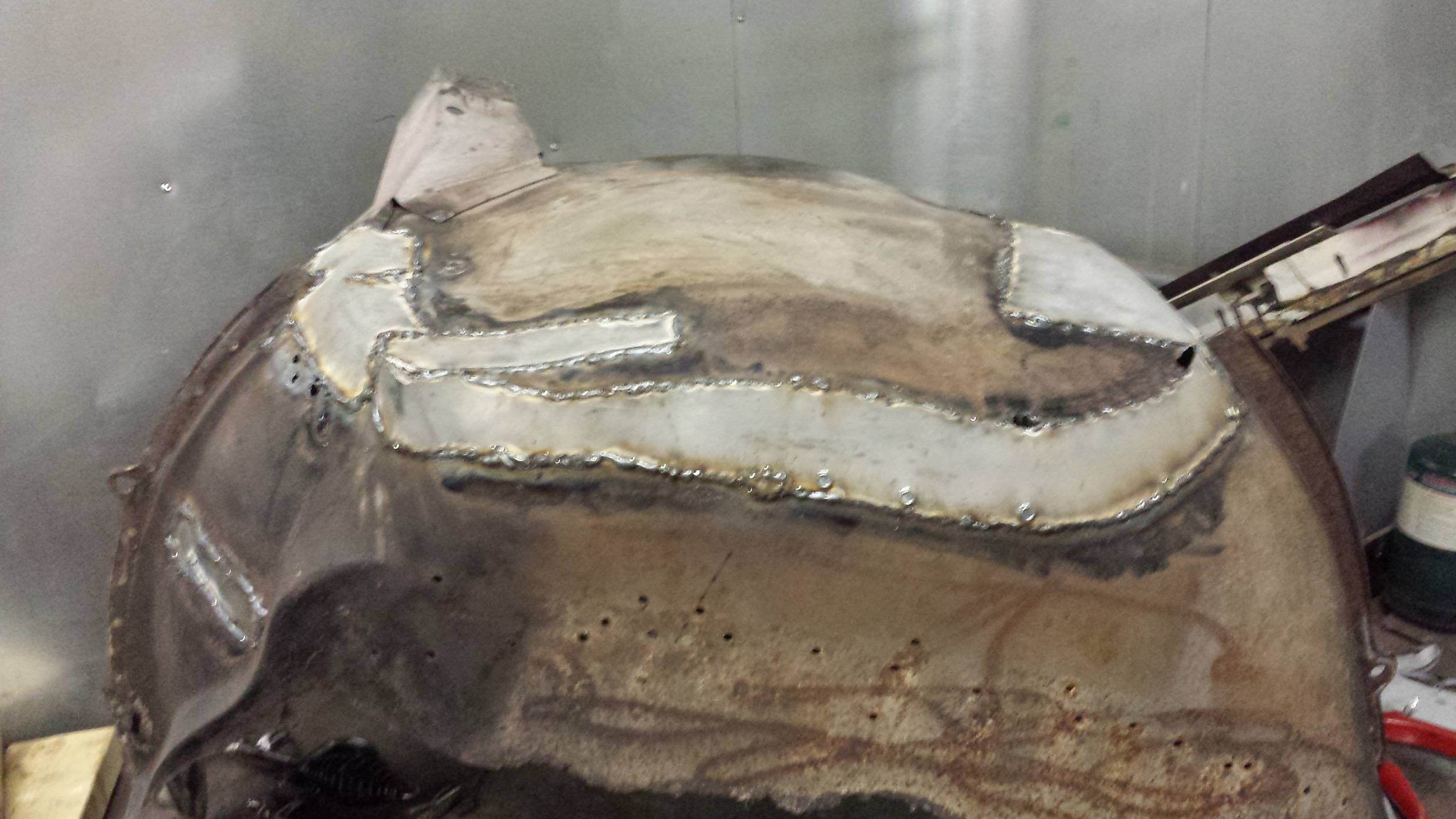

I've also been rebuilding he rear wheel wells as well.
Insane how much you needed to cut out. I wouldn't have the ability to keep everything braced and lined up for fabrication and assembly. Impressive.
Well the *** end fenders wise was very strong as the PO had replaced the 1/4 panels and some how managed to line them up pretty decently with the rusted underbelly.
The outer shell is in really decent shape
The car did twist a little when I lifted it up to do the work but I shimmed it level then used the door seams as a reference point.
The right side spread a bit more than the left door so I lifted the right rear up to match the left side.
This was due to the fact that the PO had not lined things up correctly when doing the 1/4's to begin with
The scariest part was when I tried to support the car with jack stands from the back of the rocker panels and the entire back end started to sag backwards!
That's how much rot and rust was under this thing.
I had to support the rear of the car from the differential then dismantle the drive train then lower it out of the way in order to maintain the rear body in alignment
One the weight of the diff and springs was gone it the pucker factor dropped drastically! :)

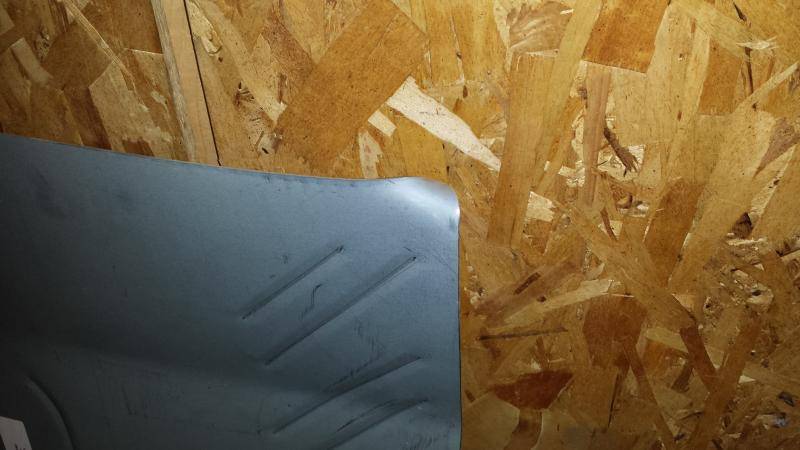

If everything goes well this week. I am going to test fit the C2C trunk floor & side plates and be able to offer an opinion on the quality of the floor.
It doesn't have the same depth of ribbing as the factory floor but I am not worried about that because I don't plan to enter any 100 point car shows
So far now the wheel wells have been consuming a # of hours fabricating patches and welding them into place.
