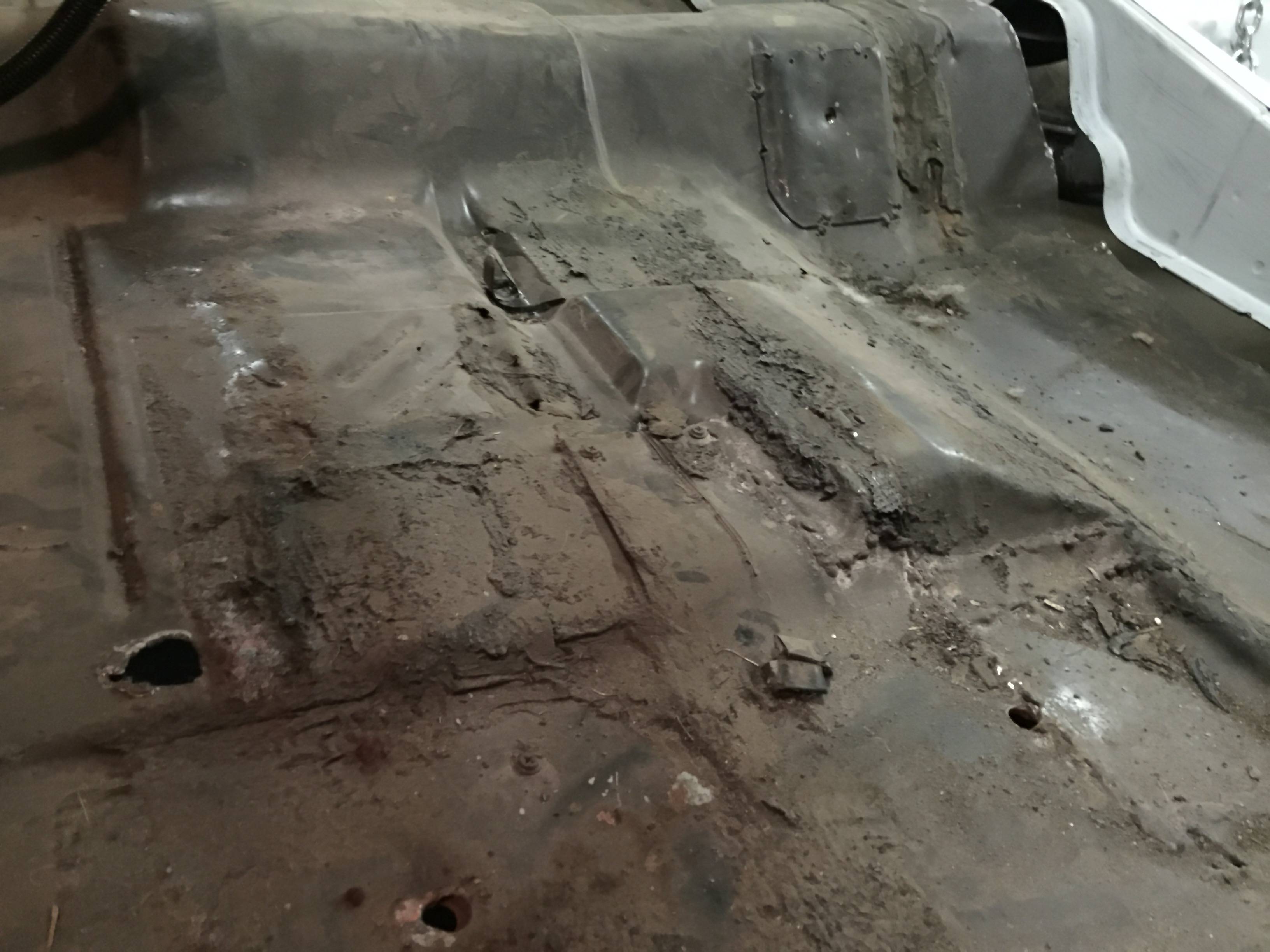

Well I have the frame welded into place now and test fitting the trunk pan from c2c fabrication
Although it is not a factory stamped pan it's looking like it's going to work out

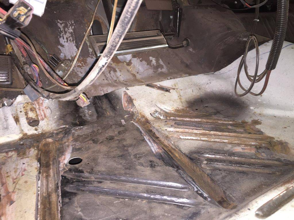

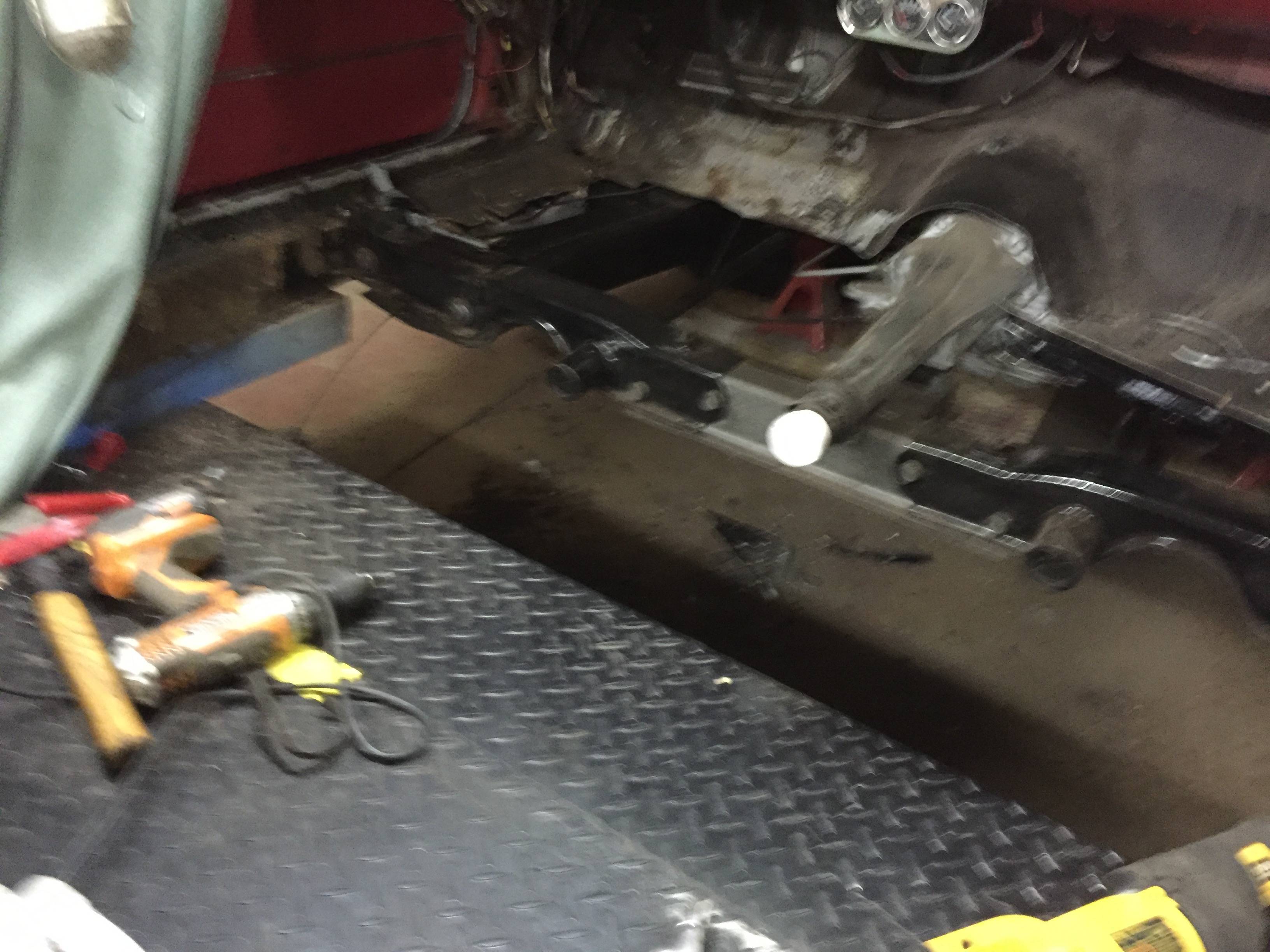

I also removed the floor pan and cleaning the rails up and expect to install the donor pan within the next week

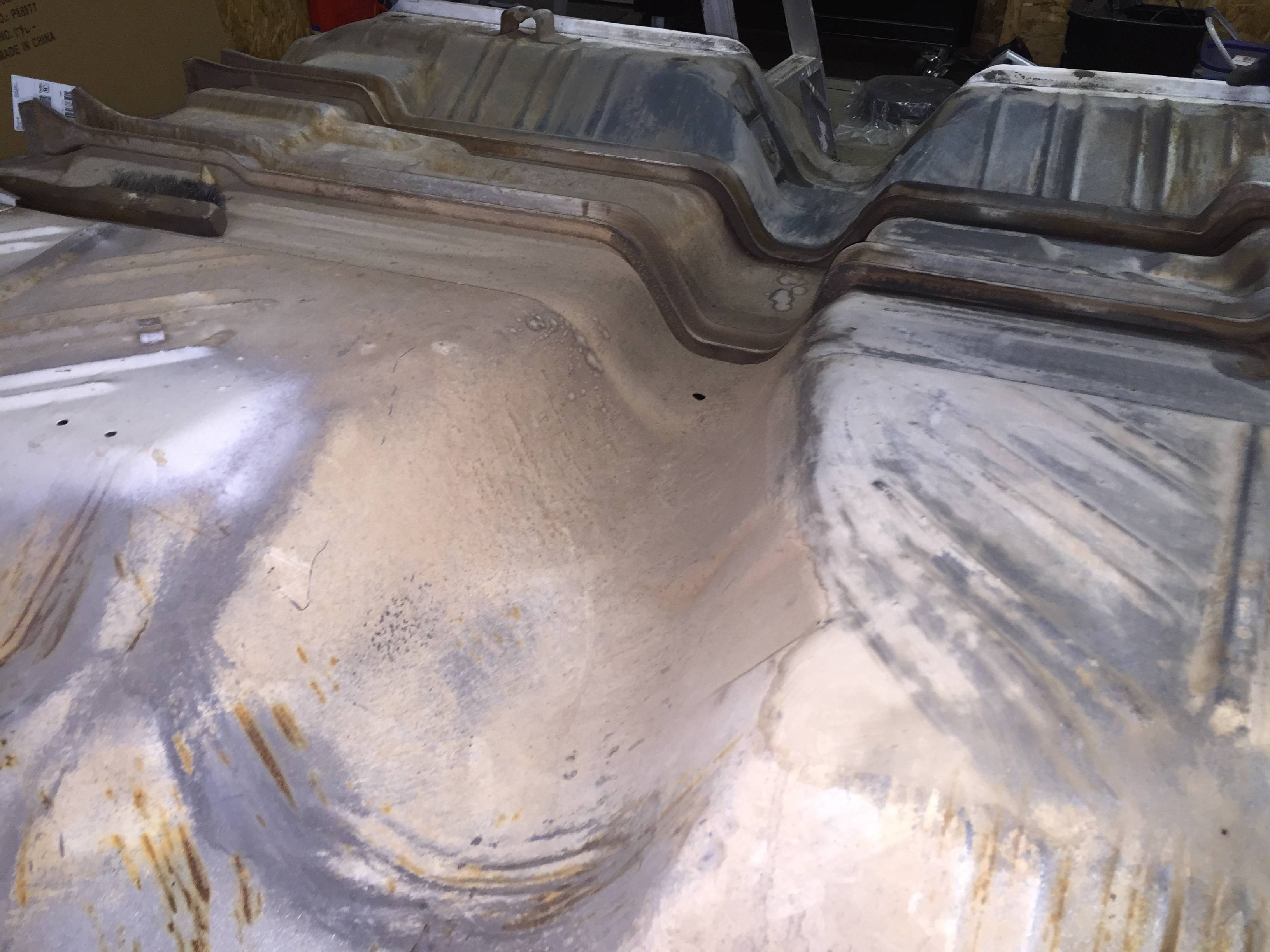

Floor's out and rails prepped for the new floor. I just have to prep the new floor for installation this weekend. I hope...

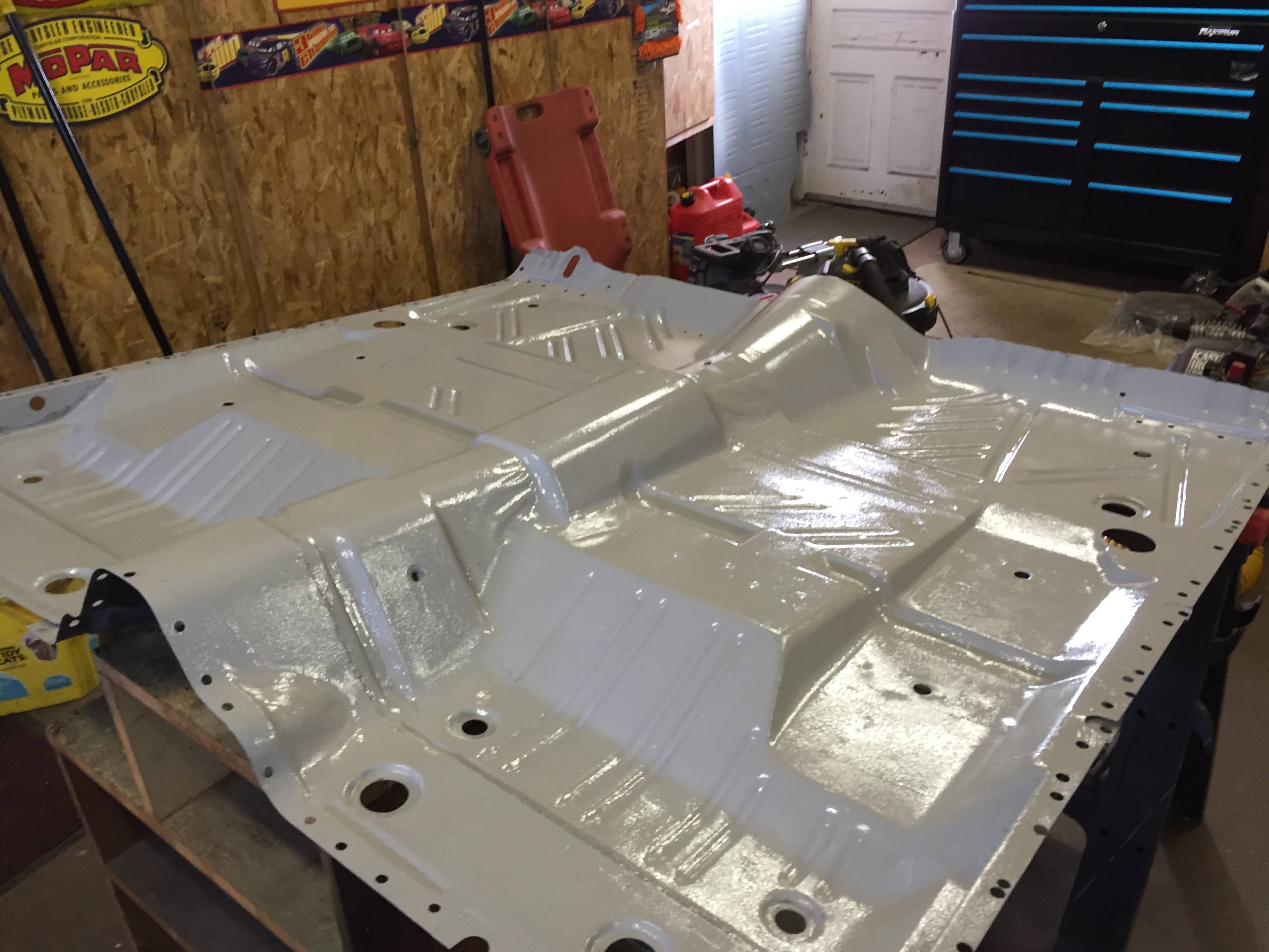

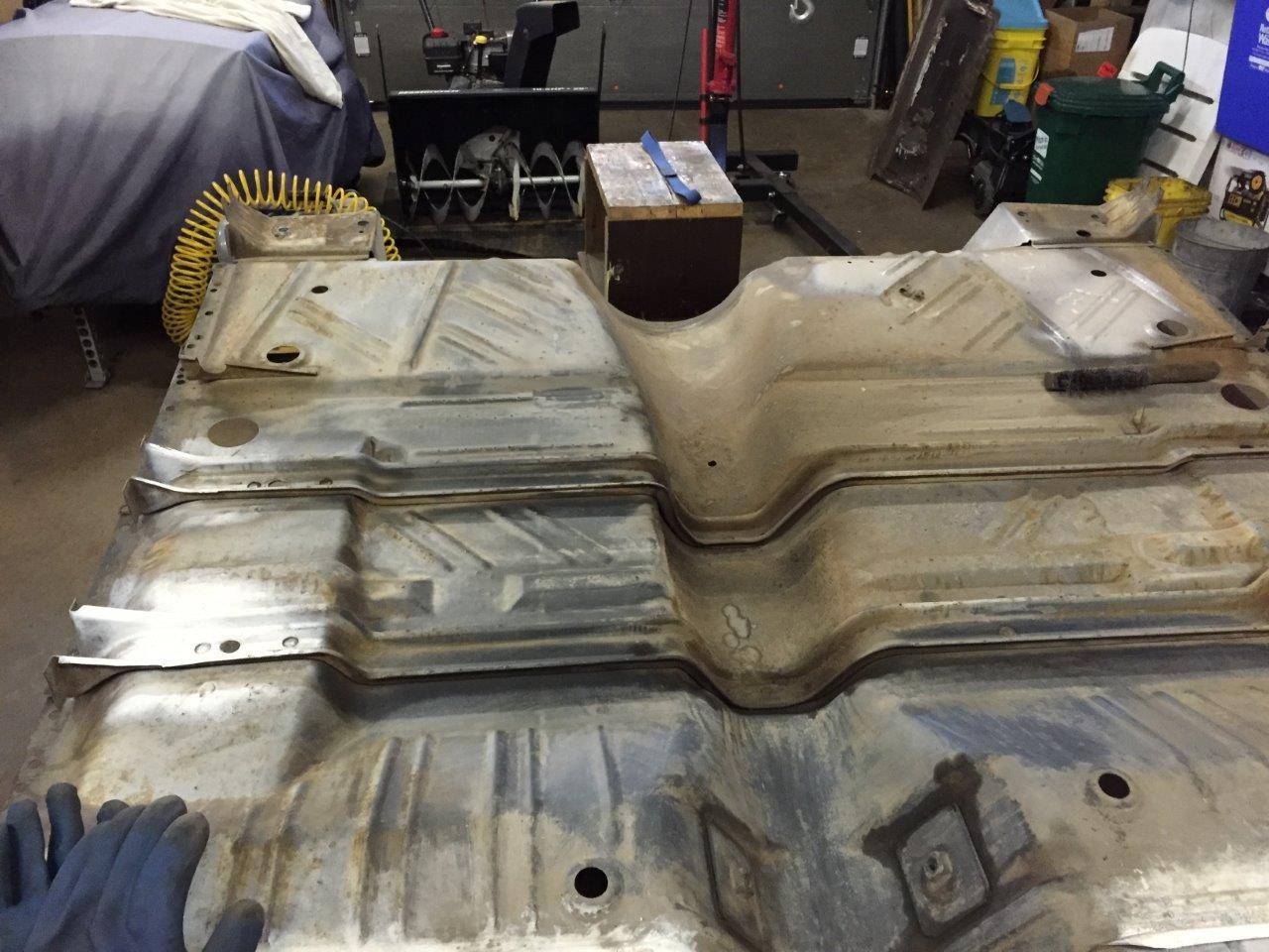

I wiped the one side down last night with some varsol and took some pics to show how easy the clean up of this is going to be.
This new floor is in amazing condition!

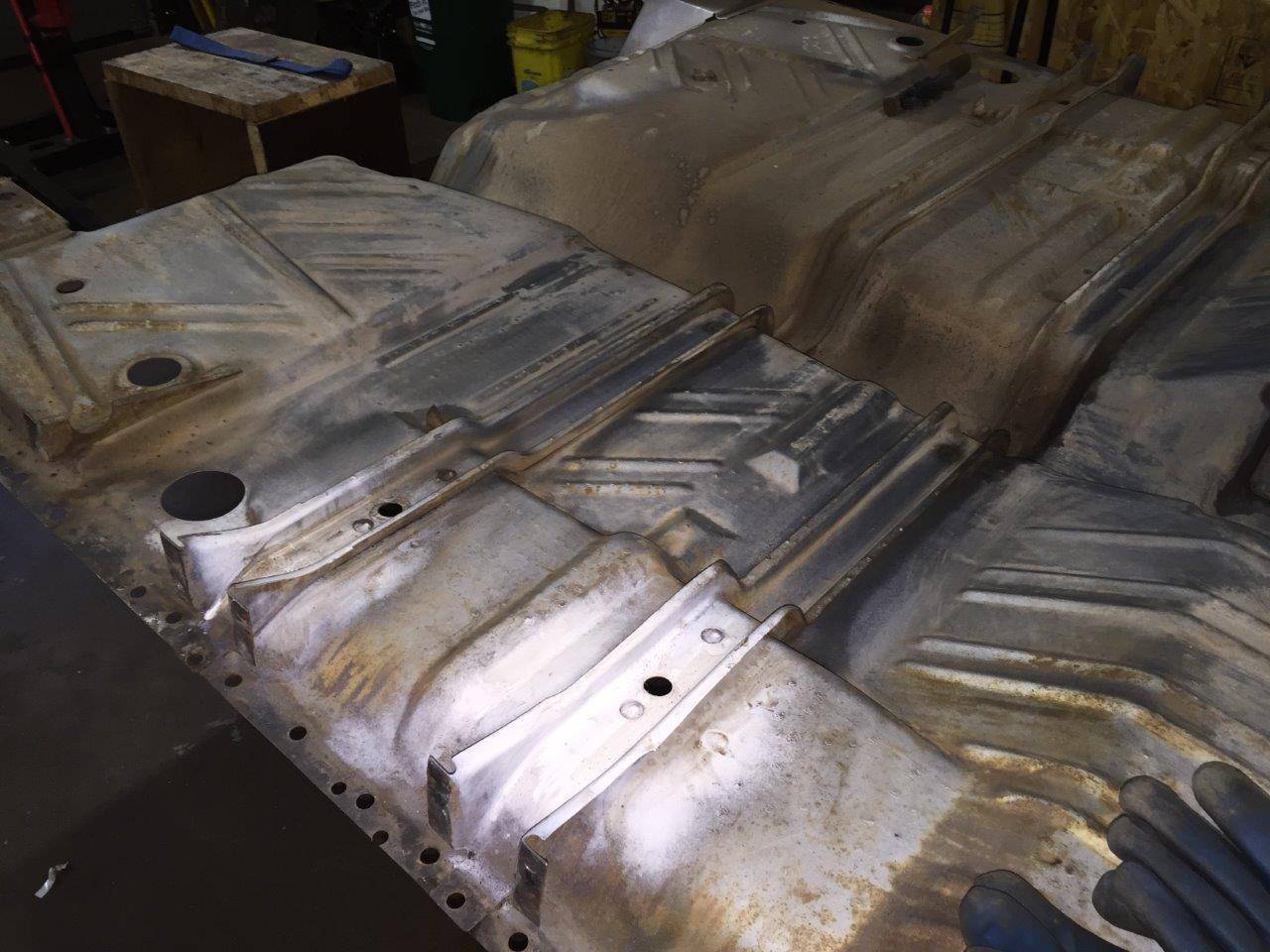

the white paint is some minor rust removal done by the bodyd shop that pulled this pan out of the Fury that became the donor car for Mark's restoration project.

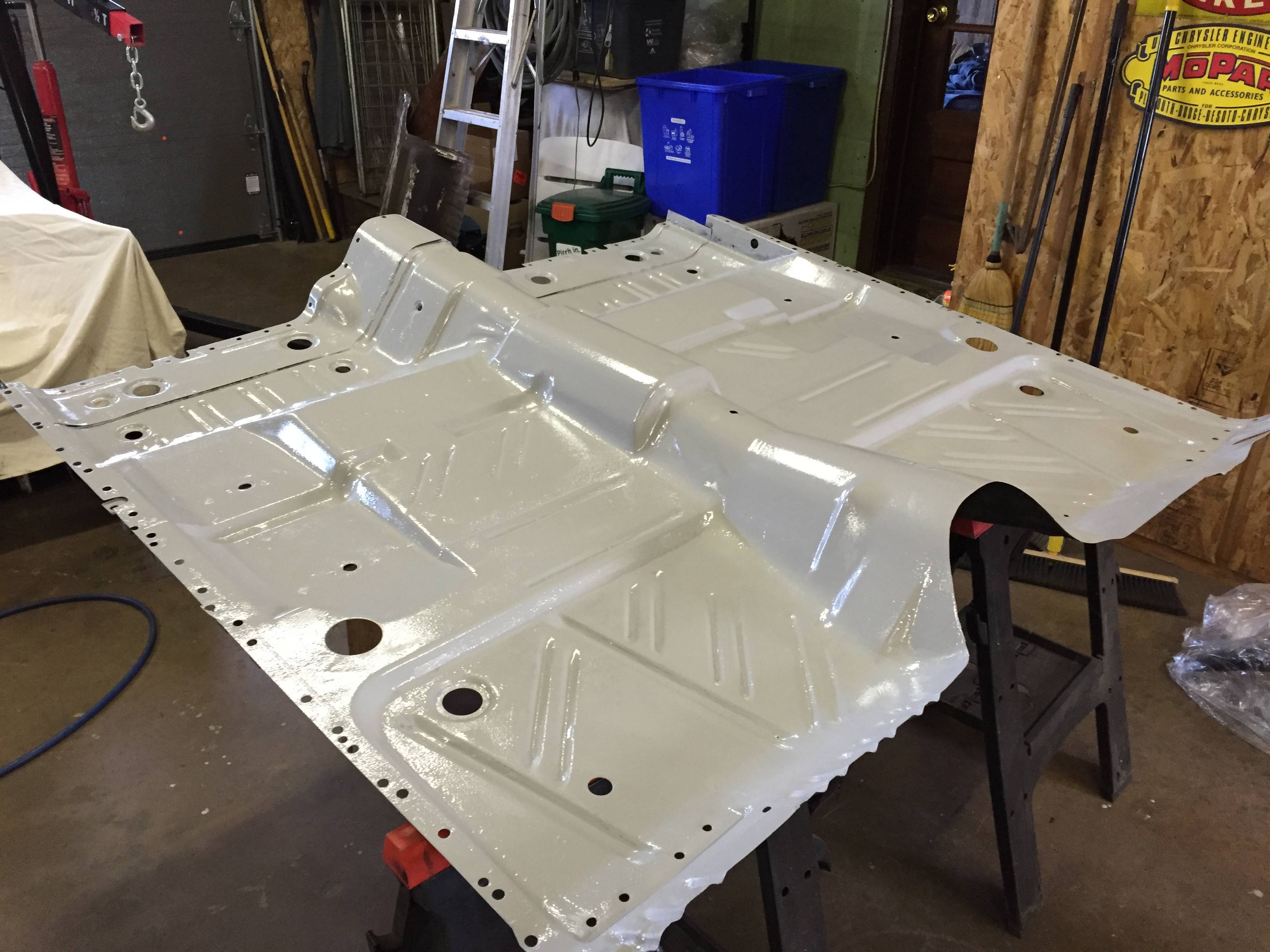

that's a lot of drilling spot welds. keep up the good work
The body shop that dismantled the car did the spot weld removal.they did a great job:D

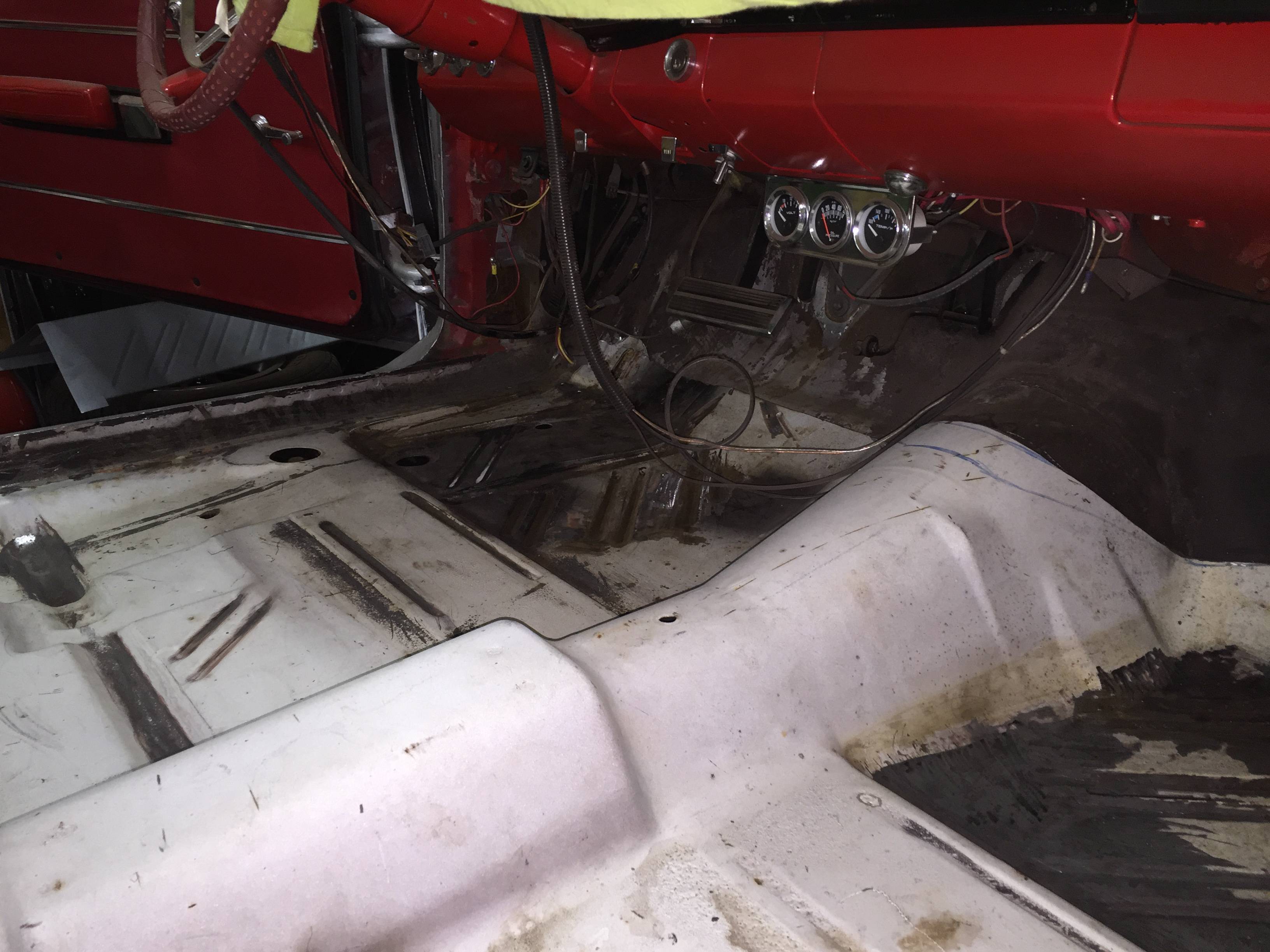

I test fit the floor pan in the car tonight.
It fit in very nicely I am very happy to state!
I have to prep the remaining floor pan in the front and prep for paint along with adding 3" to the rear section so the passengers aren't doing a Fred Flintstone in the back! :)
