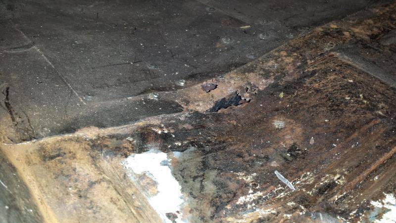

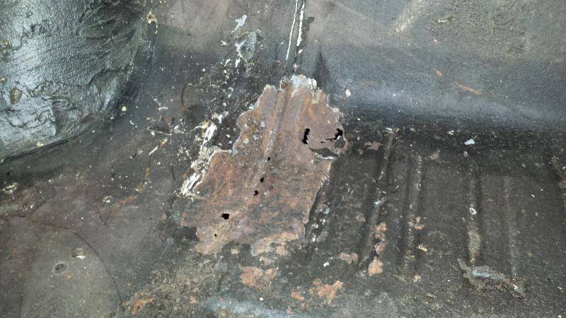

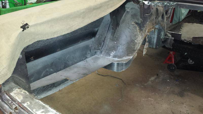

So since the front end was completed this past June, it is now time to tackle the rear of the car rusties.
So far I have been uncovering the past sins of the hacked up restoration that took place over 20 years ago.
I have a long ways to go.
A couple of tips for what I an amateur body repairman as well know is that body filler makes for a poor repair where critical strength is required.
There was too much bondo and mess used for my liking...

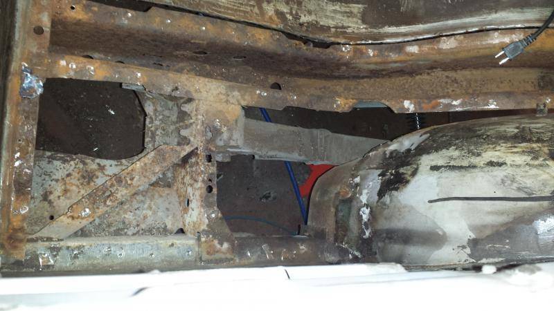

Like where the inner rear fenders connect to the floor or where the cross braces go to connect the inner fenders or the trunk floor patches...
So here is what it looks like and the long road I have to go down...

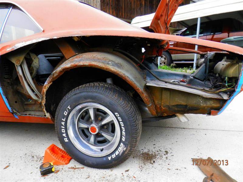

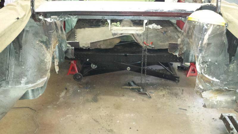

I think the biggest challenge for me is to make sure that the rear quarters are properly supported as I cut out the rusted areas.

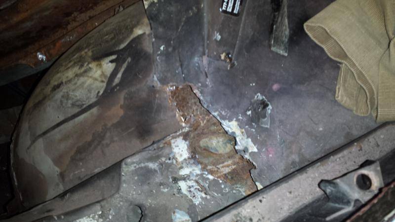

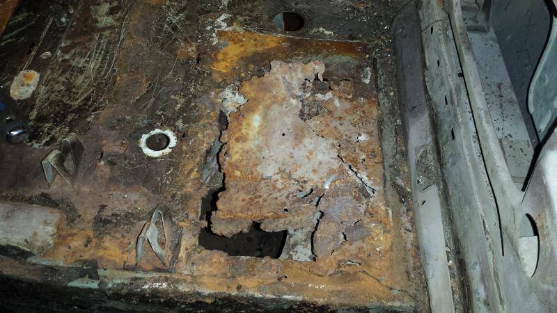

More of the trunk floor as I peel up the rotted trunk & passenger rear floor
This shall be interesting, as bad as mine were :)

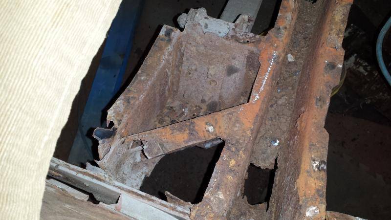

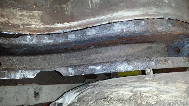

might want to pull the rear bumper to see how far the frame rust goes. sometimes there is nothing behind the brackets when they are removed
I know Nick...:buffer: he turned a sow's ear into a silk purse!

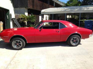

X2 ^.....your going about right, it is going to take plenty of patience, I know there will much help here, might check Youtube. When I did my Firebird last year, I learned a lot there. I had never done 1/4 panels before, found a guy doing a Camaro restoration, helped a lot, good luck man! Kel
already into that area. it had been patched before... not good though. I plan to make a pattern with the old plate and make a nice new one.

My point for showing the pics is that the 'bird was my first restoration, yes, was a bit intimidating at times, I did learn a lot about patience and perseverance. Just trying to encourage the fellas tackling their own projects that even if you aren't an "expert", they can do a great job as well. There is a enormous amount of satisfaction when someone asks "who did your car".....you can say, "I did everything".

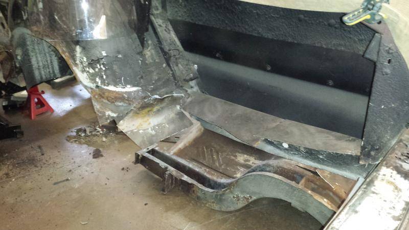

I got the leaf springs out now and taking measurements to make sure I put the frame rails that I am getting in the proper place :)
My goodness I am surprised this car didn't do a low rider on me..

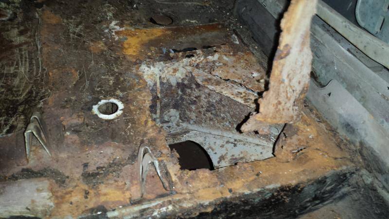

I got the trunk rails out today and started cleaning up the inner wheel wells.
There is a lot of rust going on but nothing that can't be fixed...
