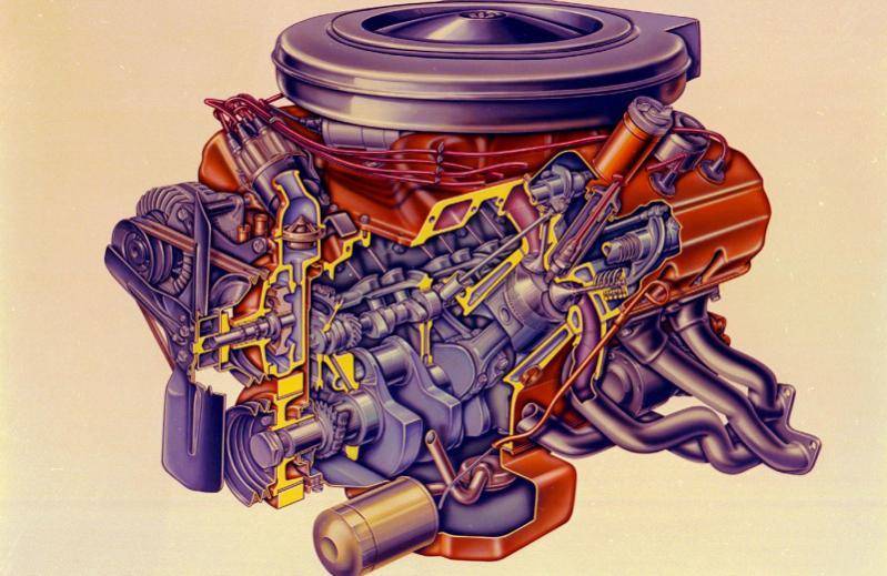

http://driving.ca/bmw/m5/auto-news/news/five-of-the-most-underrated-engines-and-their-true-power. Here is an article about supposedly underrated engines of the old days.
interesting. so these folks say L88 under by 80HP, 426 Hemi under by 45HP, and 428 CJ under by 75HP, from original SAE "gross".

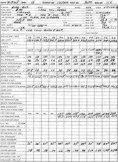

dyno sheet (source: allpar and footnoted not necessariy a production engine) attached at link below from Chrysler in July 1965 says 426 Hemi max HP of 463 at 6,000 rpm and max torque of 472 ft. lbs at 4,000 rpm. so maybe another confirmation of factory "underrating".
http://www.allpar.com/mopar/hemi/dyno-test.html
long story short, 426 (7.0L) Hemi may have still been at 425-HP SAE "net" (assuming you add back the underrate and have no compression change?) back then versus the 425-HP "net" out of the modern 6.1L Hemi mill today. Seems to make some sense improvements got equivalent HP out of less displacement.
