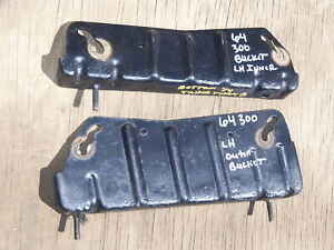

Some of the seat tracks have optional holes for the bolts that go through the floor. You would need to remove the seat to check, there is a clip that holds the bolt/stud in the frame.

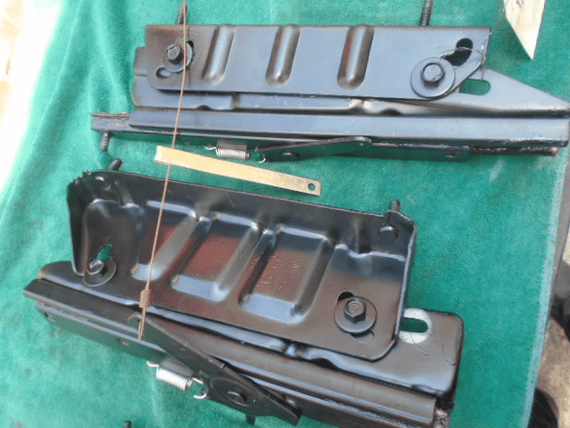

This is a pic of an A body seat bracket and you can see the adjustment slots. I have no idea if your car has these or not, but wouldn't be surprised.

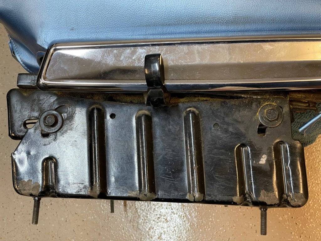

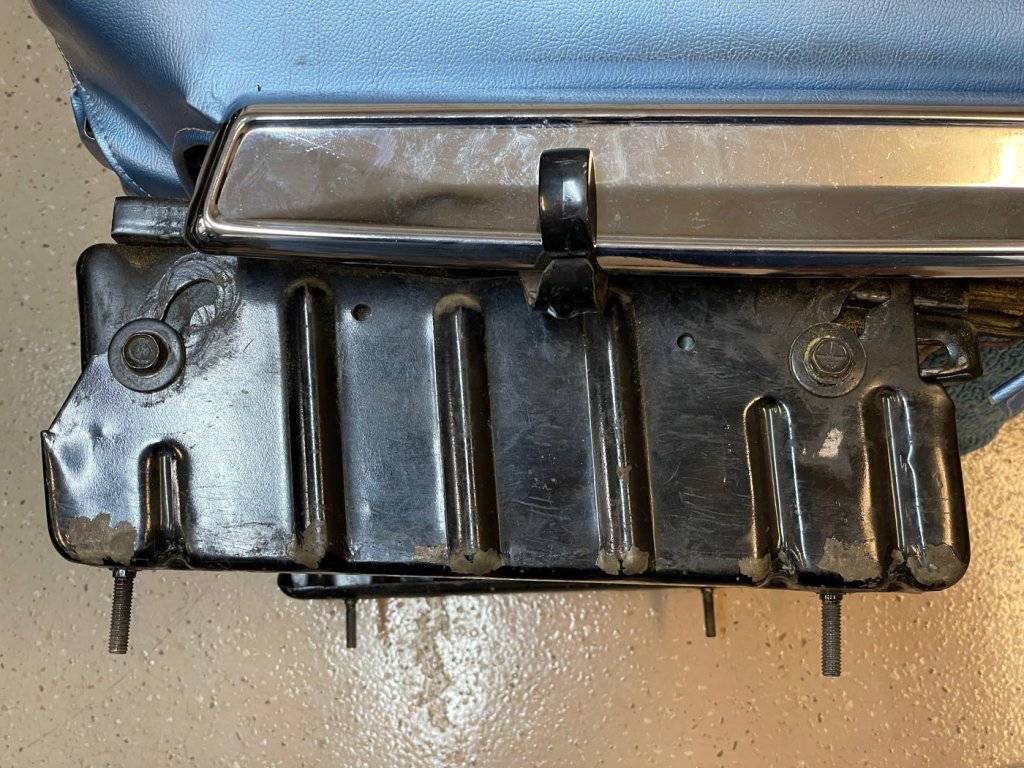

Thanks everyone. I was able to lower the drivers seat and move it backward.
There are 2 bolts on each track that I loosened, moved the tracks to give the most rearward travel and lowest seat height. Note: The seat tracks are different height since the inboard track is setting taller due to the floorpan configuration.
See the outboard seat track pics attached. The first pic is before and the last pic is after adjustment. It adjusted about 1/2" back, 1/2" front down and 3/4" lower in the back of the seat.
Makes all the difference needed.
Chuck
ChuckView attachment 557507View attachment 557508
