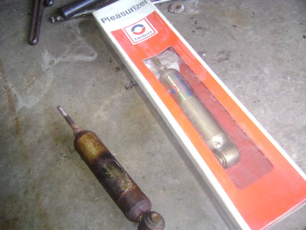

I found on E bay some NORS shocks from back in the day to experience the REAL ride of my C..lol
I found the exact "old school" oil filled shocks that she had.

"Pleasurizer"...sounds like a sex toy!

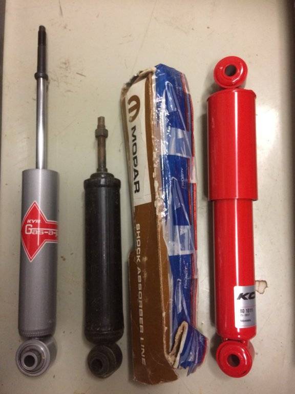

From left to right: KYB, NOS Oriflow, and Koni 80-1011. Some manufacturing needed on the latter one, though. The bottom bushing needs to be changed due to size, the top cap will have to be removed (by cutting off the top lenk), and a new piece (a bolt) will have to be welded to the top.

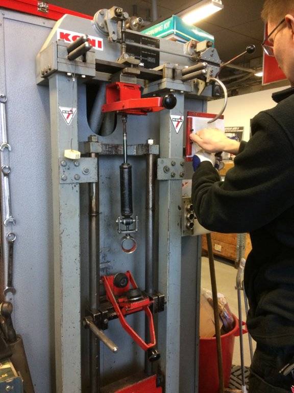

I took both the Oriflow and the Koni to a shock dyno:
The old (NOS) Oriflow turned out to be a surprisingly good shock absorber. Much better than the KYB I took to dyno some time ago, but different in character from the Koni.
