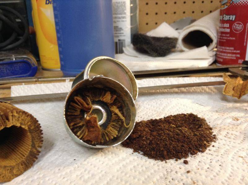

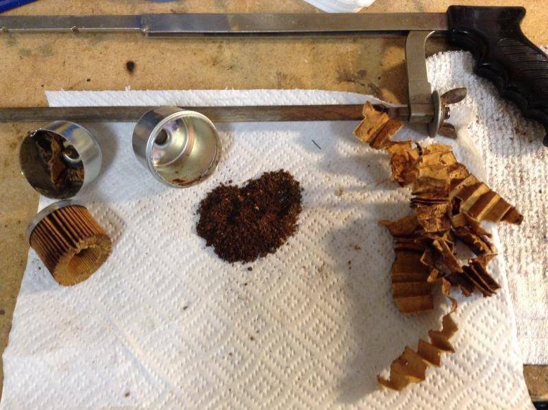

Yep, agree with all the above. My car sat for over a year,..and this is what I found in just the fuel filters after the car ran out of fuel and I couldn't get it started. Cut the fuel filters in half and found this. I had to replace everything. Tank was cleaned, all the lines and put in a new high flow mechanical and a Holley electric pump and 2 filters. Lucky for me I had 2 filters and the second filter had no rust in it,..or the carb would have had to be rebuilt. The original carb is no longer on the car and was replaced with a Holley 850hp.
