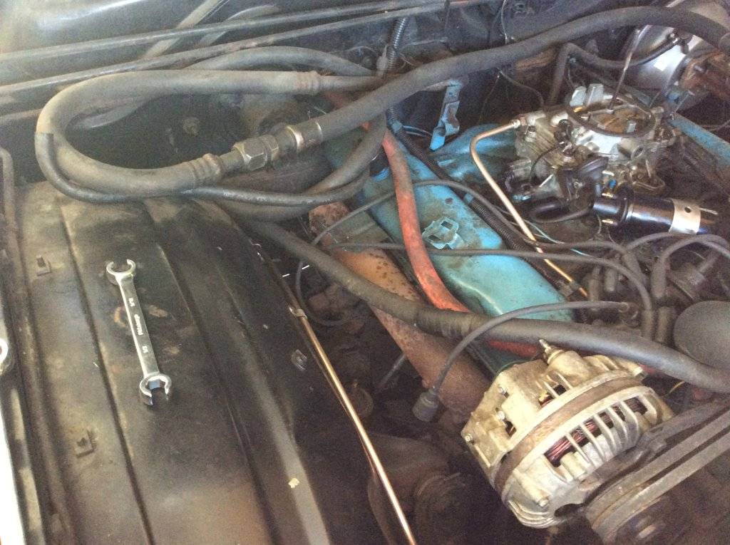

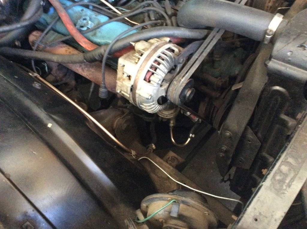

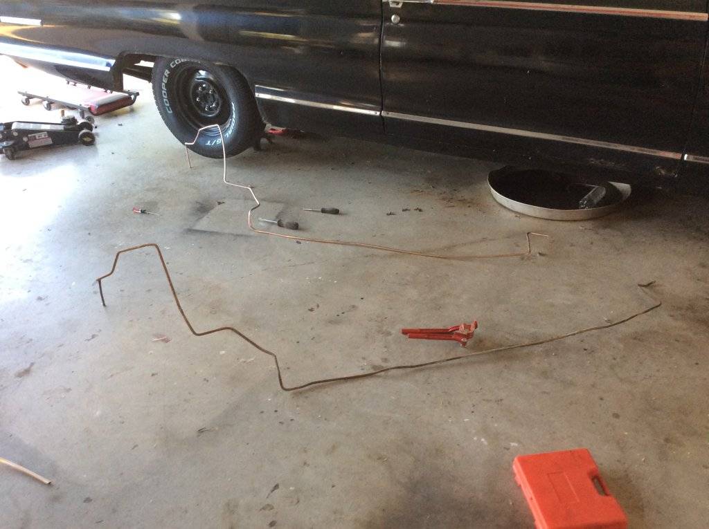

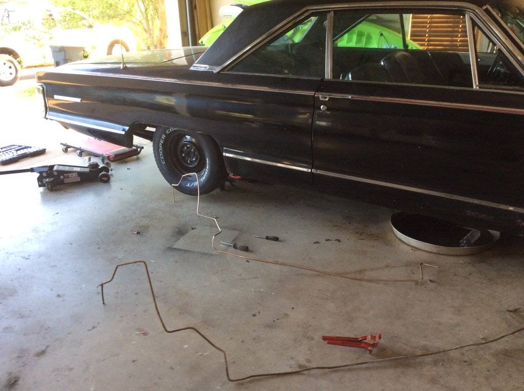

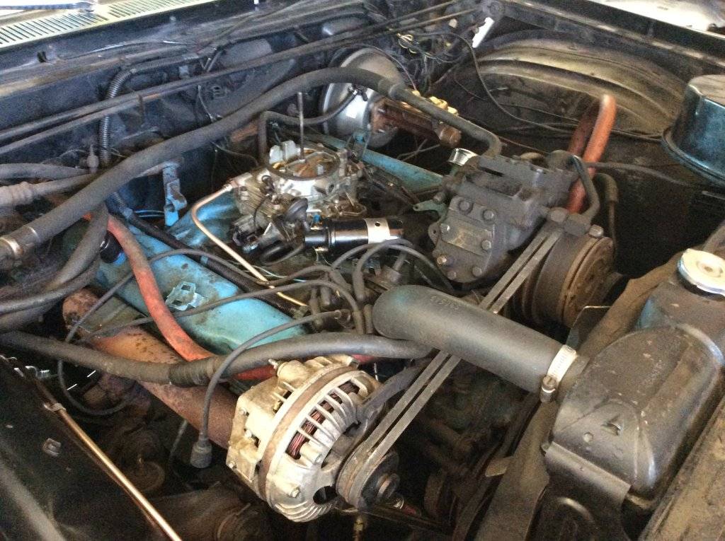

Finished installing new sending unit, fuel lines from tank to carb, and fuel filter to go with a new pump. Kept it stock, used 5/16 Niccop lines. You can see one of the new lines by the old one prior to installation. I've also figured out how to post pics. Still have a lot of sorting out to do around the engine. One day at a time. May2nd2022.JPGIMG_0130.JPGIMG_0131.JPGIMG_0136.JPGIMG_0137.JPGIMG_0138.JPG

Good job on the bending!
I never use stainless steel repop lines.
They are very hard and do leak.
The nicop lines are easy to work with and seal properly

I see you routed the fuel line from the pump to the carb behind the distributer as it should be done. Too many people get lazy on that. Nice work.
Thanks. I really like the nicop. They do seal really well and are easier to flare by hand. The only problem I've had is with cutting them. I have to be very gentle using a pipe cutter or I squash them. Mostly I stick a cutting wheel on my dremel and zip on through.

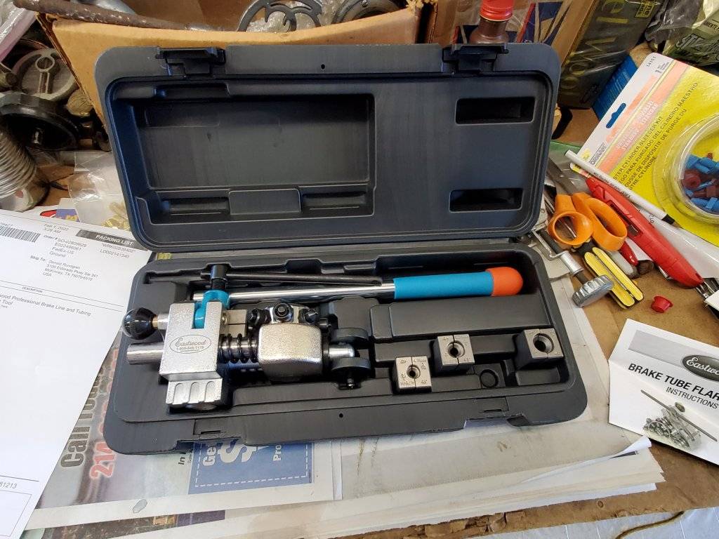

Nice job with the lines. Best way to cut tubing is with a rotating tubing cutter, shown in the right background of this pic.
