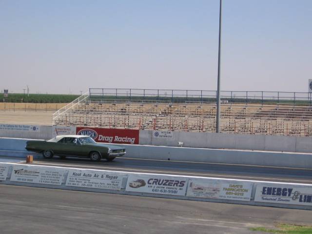

Don't know about that; I'm still running 2.76 gears and I can burn rubber all day.View attachment 282373
