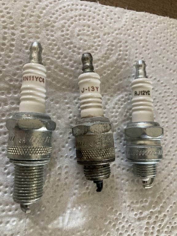

My 68 440, had the middle plug, all 8 installed. I purchased plugs on the right, what is called for, and the one on the left, set of 8 is what came with the car. Which one should the correct plug? All stock with point, condenser ignition still. Any imput please.
The plug on the left is not the correct plug for a 440.
You'll have to look up the application for it to see what it fits, but if you screw that one in, it will hit the piston top and cause all sorts of havoc and destruction.
The plug on the left is definitely not the right one, its threads are too long. I think that type is used in a slant six or small-block. The plugs are supposed to be resistor plugs so I would say the one on the right is correct. I don't think the difference between the 12 and 13 is very significant. That indicates the temperature range.
Thats what I thought, Im just glad the previous owner didnt install the long reach and find out the hard way. The RJ12YC is what is called for so thats what I got. Thanks for the imput gentlemen, always appreciated!
The J13Y is half a heat range hotter —- and that is why you see that is black by the electrode —- it is too hot…
The J12Y —- replaced by R ( Resistor ) J ( short reach 3 /8 “ )
12 ( heat range ) Y ( extended tip ) C ( Copper Core technology) —- hence the part number : RJ12YC …. IS correct for the whole 383 & 440 cars….
The “ N “ plug is long reach ( 3/4 “ ) for the Small Block Cars —-
273 , 318 , 340 , and 360 —— and would strike your piston and create serious damage to the motor…
And , yes , the RN12YC serviced the Slant Six class from 1960 - 1974…..

The plug in the middle obviously has failed or the plug wire going to it has failed. No spark is the reason for its sootiness.
The RN11YC plug on the left is for a LA motor. No workie in a B/RB engine with the stock heads on it.
Take away the "R" from the front (resistor) and the "C" at the end (copper core) and what remains is the original Champion Spark Plug number from old.
Usually, deviating up to two heat ranges colder than stock works fine as long as the cylinders are not using oil. But going hotter than "14" is not something I'd be doing. There were some 383HP engines in the '60 383 police cars which spec'd J9Y Champion plugs. They were not chasing people all day, but probably sat idling a lot, too.

Big blocks with factory iron heads never used long reach plugs.
The ones on the left are for a small block.
