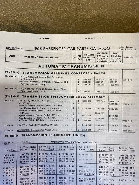

It seems all the replacement cables are a little long. I think I ordered an 80”, but didn’t like the way it routed because it was kind of long. If I am not mistaken the OEM length is in the parts manual.
Or I found some notes somewhere on the lengths.
Non cruise control, Standard cable length w/ housing 63” on Everything (all models) except Chrysler and Imperial in which it was 68” long.
Interesting that the shaft or Cable package was 80” long. And seems universal.
