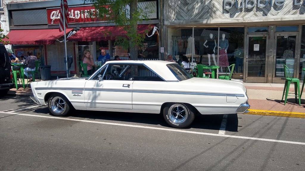

I bought new springs... But a good measurement if you want a little "*** up" for larger rear tires and the classic hot rod look is 1". Don't go over that. It's too high. 1" and use gas shocks... Never air shocks.
I got my rake with wheel size, spring arch and gas shocks. If this is that you want. If you want stock look. Don't bend over stock height.
