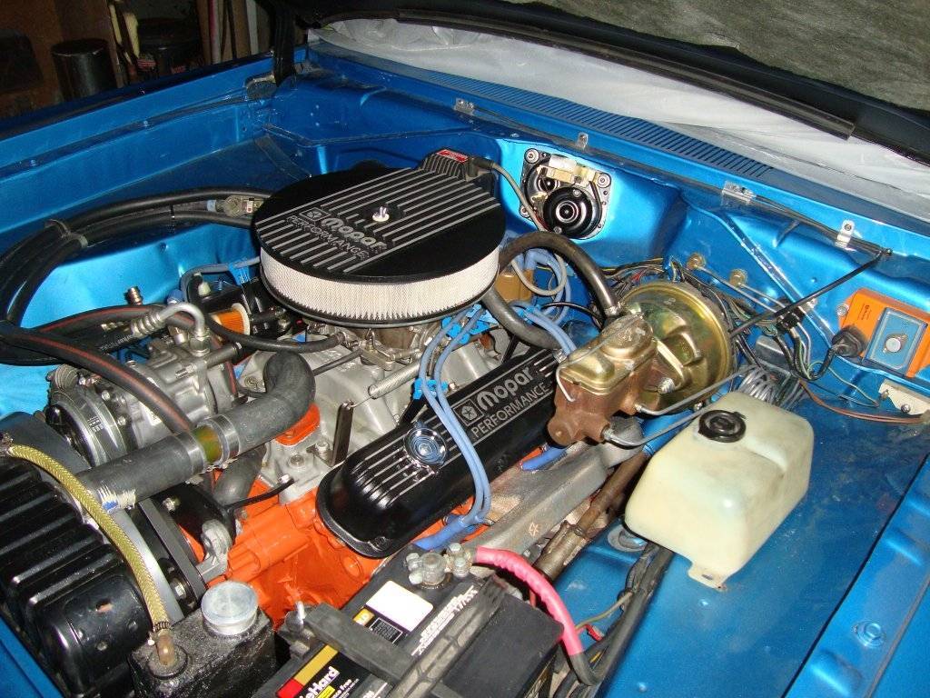

did a ssbc kit on a 71 duster with no issues . are you converting it to power brakes from the single pod master ? there is a lot of new lines to be run . and if your going power , there can be an assemble issue , it seems the the linkage from peddle to booster can be assembled backward . made the peddle stand close to the floor . once assembled correctly had no issues in operation of the unit . this is a pic of that power unit on mine . the lines going through the firewall are for the rear brake pressure valve adjust .
The pedal assembly is kicking my butt. Is there a way I can see how yours looks? The lines are run and everything else is golden but I rigged the pedal so I could bleed the brakes. And yes it was a single pod master.
