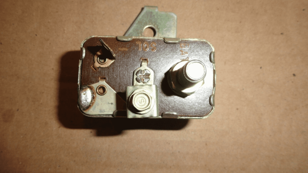

I might have a NORS one let me look. AT or MT?
Think I have this one older FILKO

^^^ Ray / HalifaxHops ^^^,
That one you have illustrated / photographed, is a M / T, but then you probably know that….
Yours, Craig……
Thanks did not catch that. OK then I have none. Glad you have it covered then Craig!
