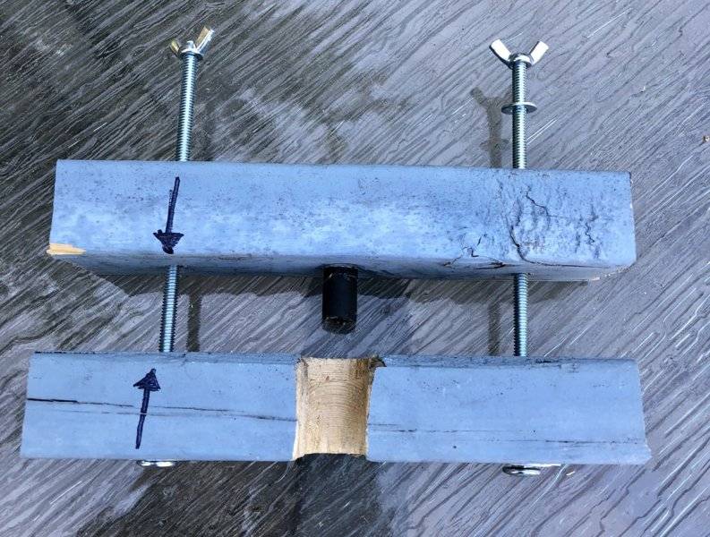

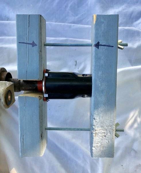

Just happened to see this homemade tool on FABO.
Show us your home made tools Post #345
Nice one. Managed to get two crappy carpenters clamps on mine.
