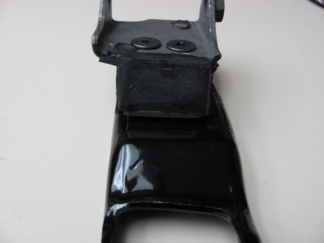

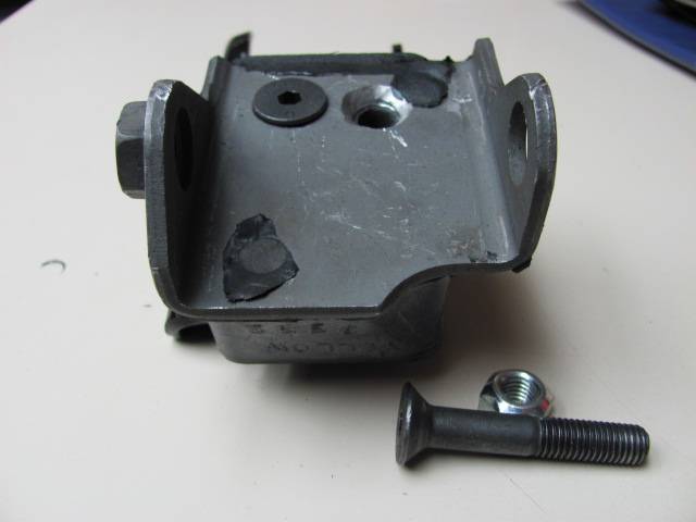

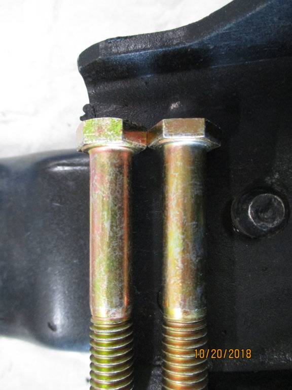

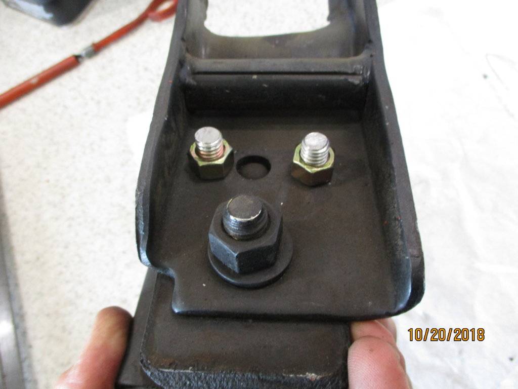

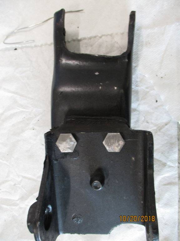

The simplest, cheapest, and MOST EFFECTIVE cure for preventing a broken engine mount (driver's side only) is two strong bolts through the mount. I did it to my existing mount, and the mod itself takes 15 minutes. Getting it out and back in is another story, but that's the case no matter what product you use.
One bolt will work for 99% of our applications, but because I have a warmed 440TNT and an irreplaceable fiberglass Hurst hood that hates fan blades, I went with two 3/8ths bolts. Metrics work, too! :D
1. File the heads so the mount will fit "almost" properly on the K-frame. I got them pretty thin, but with plenty of strength still there. Some guys have used countersunk bolts, as you can see in the pics below.
2. If you're using your own mount, there's no need to disassemble it from the bracket. Leave it be, as you're drilling through the whole assembly anyway. If you're going with a new mount (even a cheapo China mount will work fine with this mod), bolt it to the bracket, torqued, etc, before drilling.
3. Figure out where you want the holes. Drill a small pilot hole first, then drill the needed hole size in two steps, unless you have a powerful drill press.
4. Insert bolts with heads down, washers are NOT needed. Put a drop of Loctite on the threads (or use a Nylock nut) and run the nut down to almost touching the mount. Almost! Leave a gap about the thickness of a business card and the mount will function totally normally, transmitting no vibes to the chassis with this small gap.
5. Reinstall, done! This works perfectly, forever.

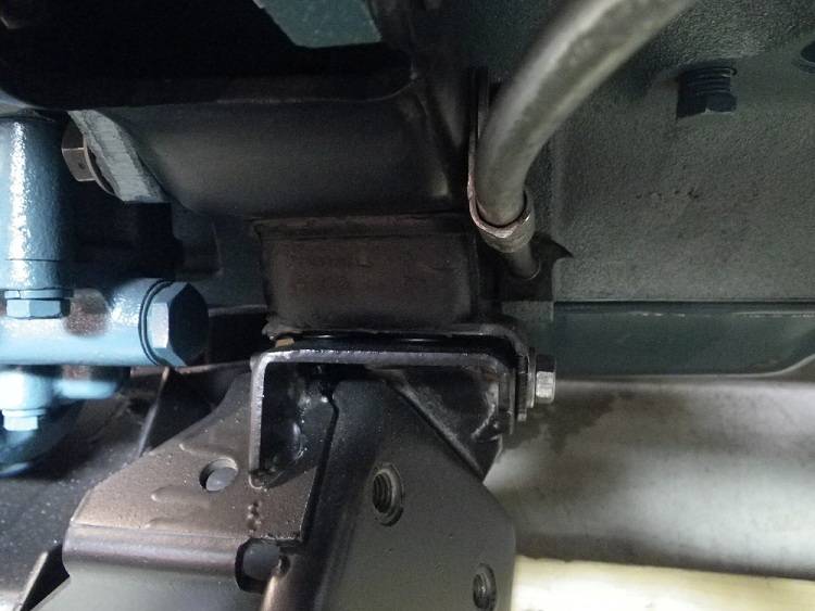

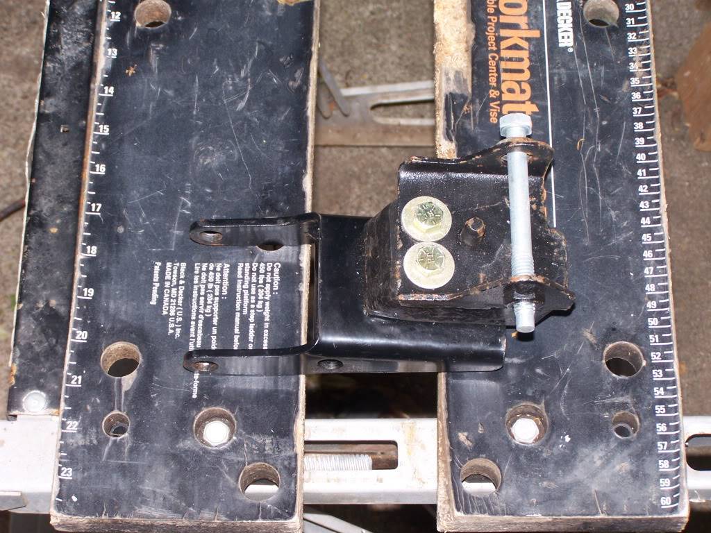

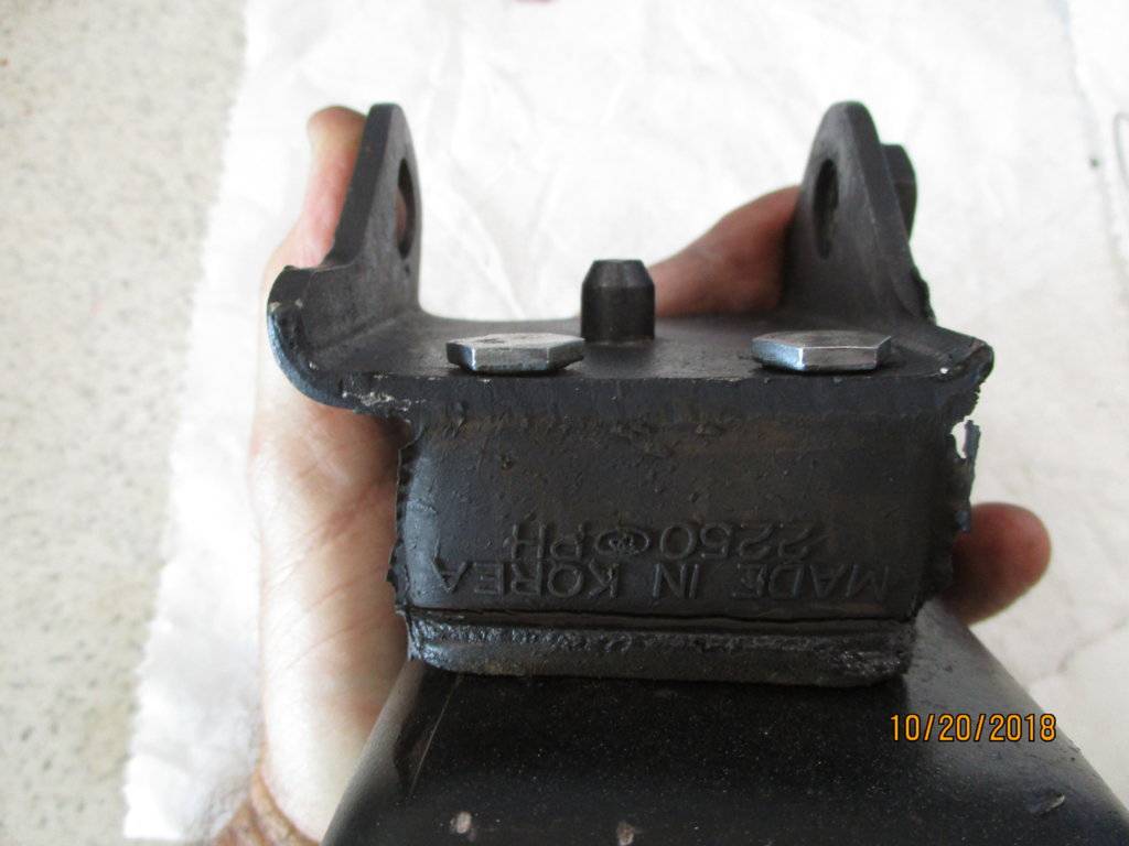

Here's my pics:
And some pics from various forums:

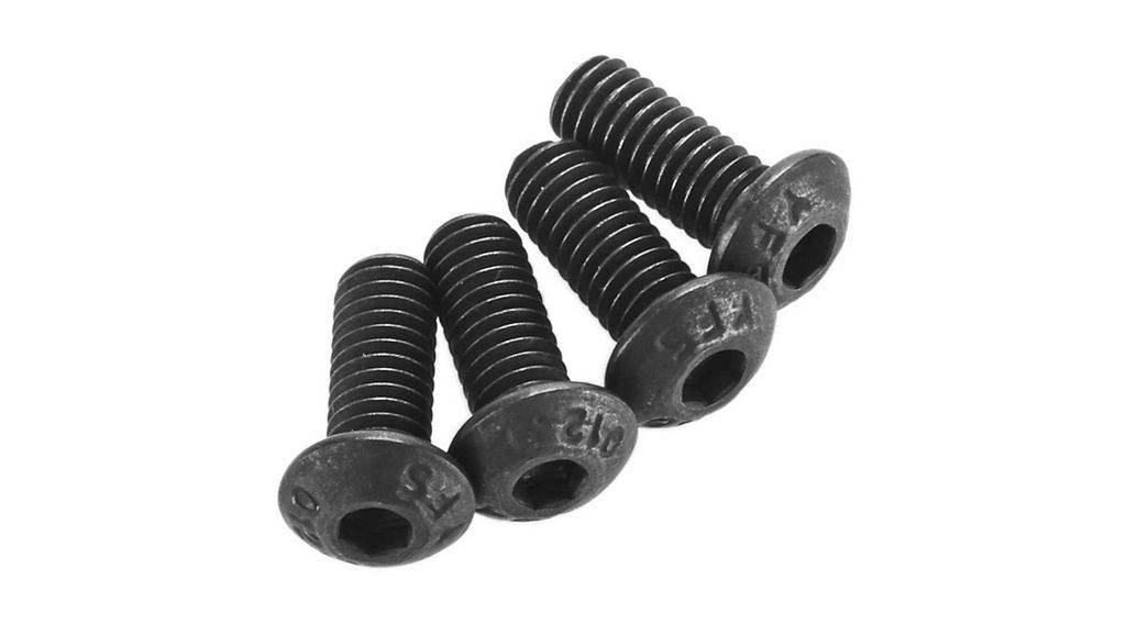

You could probably use a nice button head screw instead of a flat head.
Indeed, lots of options. And since you don't need to torque it at all, most any head will do. But it needs to be a strong bolt, 3/8ths, 2 1/2 inches long....and Depot didn't have a pan or button head that met those requirements. They had the countersunk items, but I didn't want to hassle with countersinking that robust steel of the mount. A couple of minutes with a grinder and a flat file resulted in a new specialty fastener that I call a "Skinny-headed Trace bolt". :rolleyes:

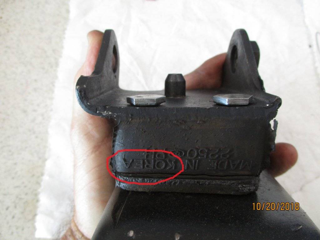

Also, I just noticed that my mount was Made In Korea, probably a loooong time ago, but it was in good shape. The engine was last out in 1998, so I'm assuming that's the era of that mount, too.

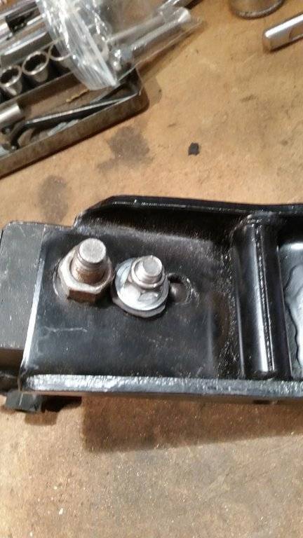

I just found this pic in my files of somebody who did the countersunk bolts. As you can see, it only lifts the mount a wee bit off the k-frame, the bolt still goes through, and all is well. My Skinny-heads gave similar results, the bolt went through the k-frame, etc.
