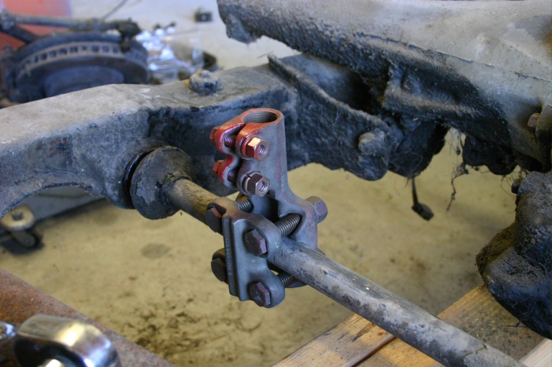

Not sure what this is, got it from the City electric yard.
I then put a 2x4 against the clamp above the bar and they popped right out.

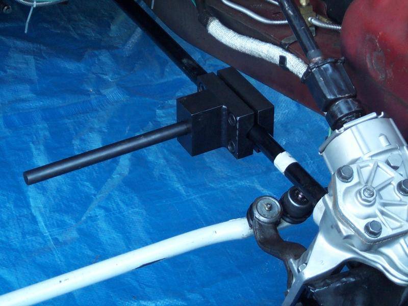

The Miller Special Tool from Chrysler for that job is very much like the Classic Industry one, but much beefier. I know, as I have used mine a lot and it is pretty beat up now. But what you did is adequate and it got the job done!
That's the one I own so, yes.
Checked with Classic Industries and the T-Bar style has been discontinued. Does anyone have any links to other brands of the same style - I couldn't locate the Miller brand saforwardlook mentioned. If none available I guess I'll have to settle for the one 330dTA posted.
