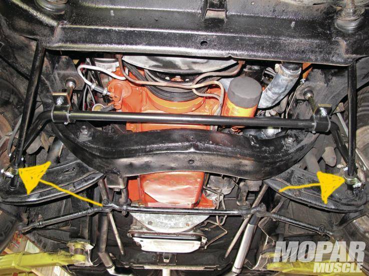

What is the terminology for these two bushings at the ends of strut rods? (yellow arrows). Maybe "rear" strut rod bushings? I dunno. Mine are dry rotted and cracked. Replacing the front bushings so looking for replacements for the rears also.
Thanks. I had absolutely no idea what to call them, other than "bushings". Unfortunately there are "bushings" everywhere in the front end.
Those are sway bar bushings, the problem is that is not a factory setup in the picture (not your car?)
Moog - Sway/Stabilizer Bar Bushing Kit
Part # K7064
(looked again, didn't see the "Mopar Muscle" on the picture)

Ordered them. Many thanks Alan
