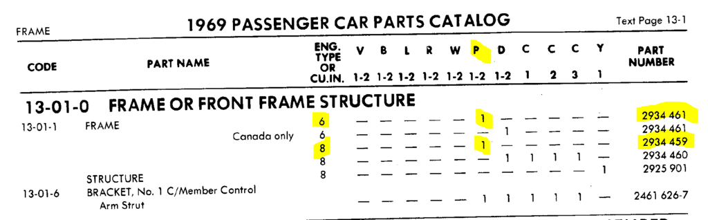

@cbarge is correct. Your 69 Phoenix/Fury (US) is a unique stub, you may want to check the parts book for xref to other years. the furys where 120" wb and the dodges and chryslers where 122. The difference was in the front clip including stub frame. You'll need to find another Phoenix/Fury for your project. You'll probably want to look for the V8 version, there were two as seen below.
