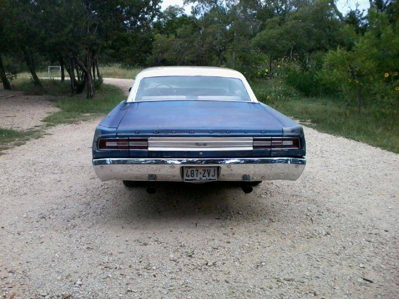

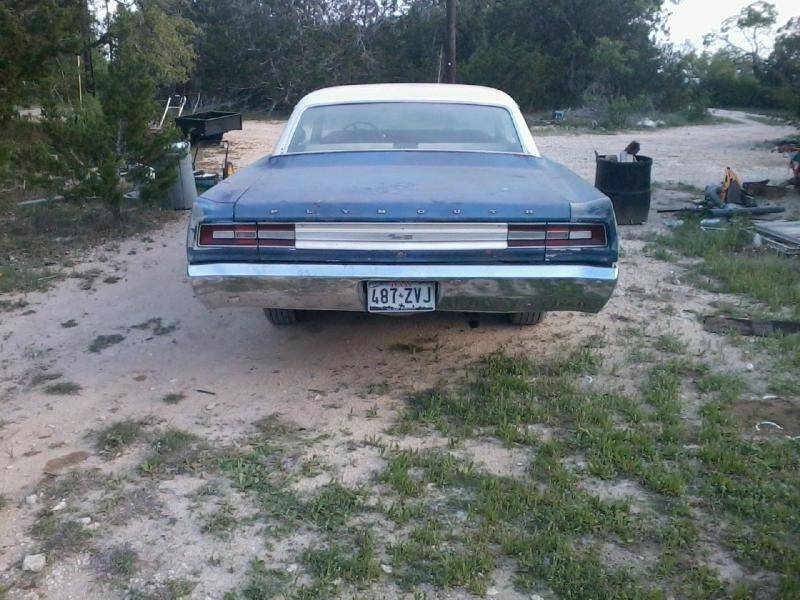

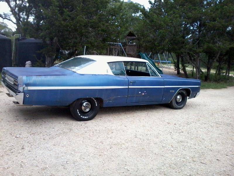

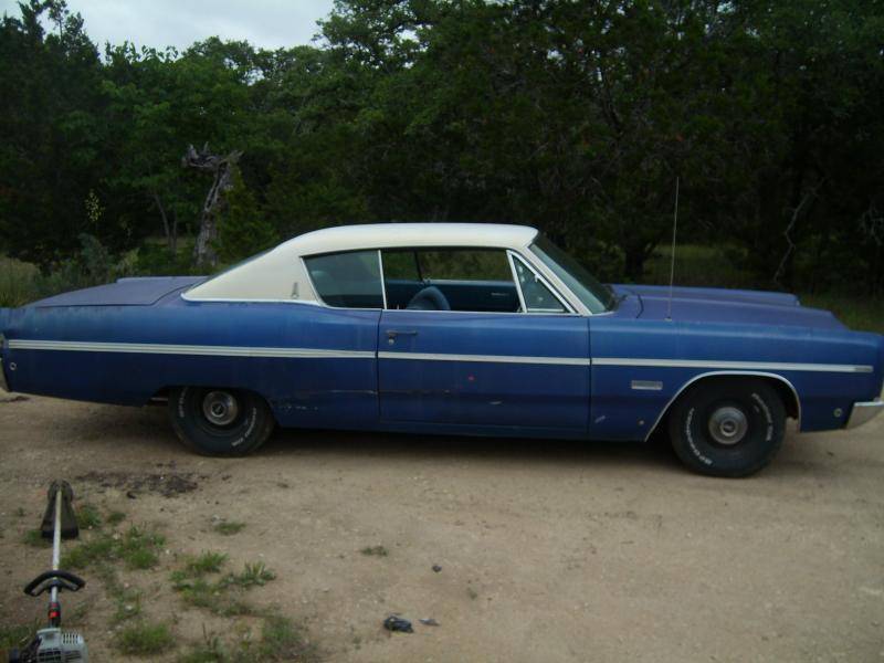

The springs give the car a great controlled ride. Not to stiff, and definitely not to soft. The car handles corners without leaning and when on full throttle the rear is very stable and tracks straight. Everybody tells me that C Body's just glide down the road. I wanted a muscle car C body!! It drives, and handles like a muscle car, and still has great road manners. I can jump in and go for a 200 mile run and be very comfortable without feeling like its a Cadillac. I love the rake the springs gave the car also.

Is that the factory arch and just stiffer/more springs that gives you the rise, or did you go like an inch over with the arch?

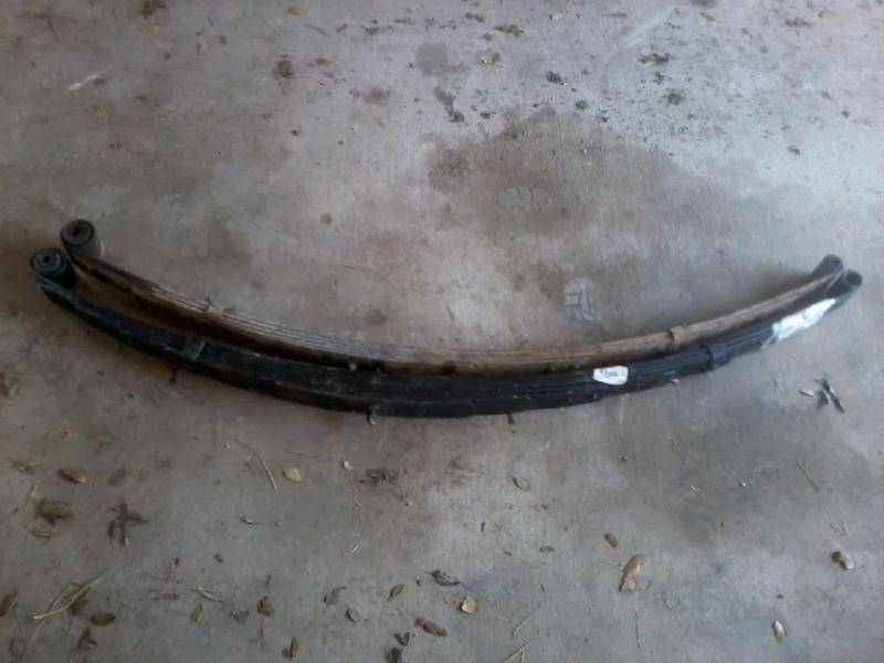

The new springs have a higher spring rate. The lift came naturally from getting good springs that don't sag. I went from staggered 4 on drivers side, and 5 on passenger side to. 7 Leafs per side.
Stock
  • Spring Capacity = 760
  • Spring Rate = 95
Heavy Duty/Super Stock
Spring Capacity = 1120
Spring Rate = 125
