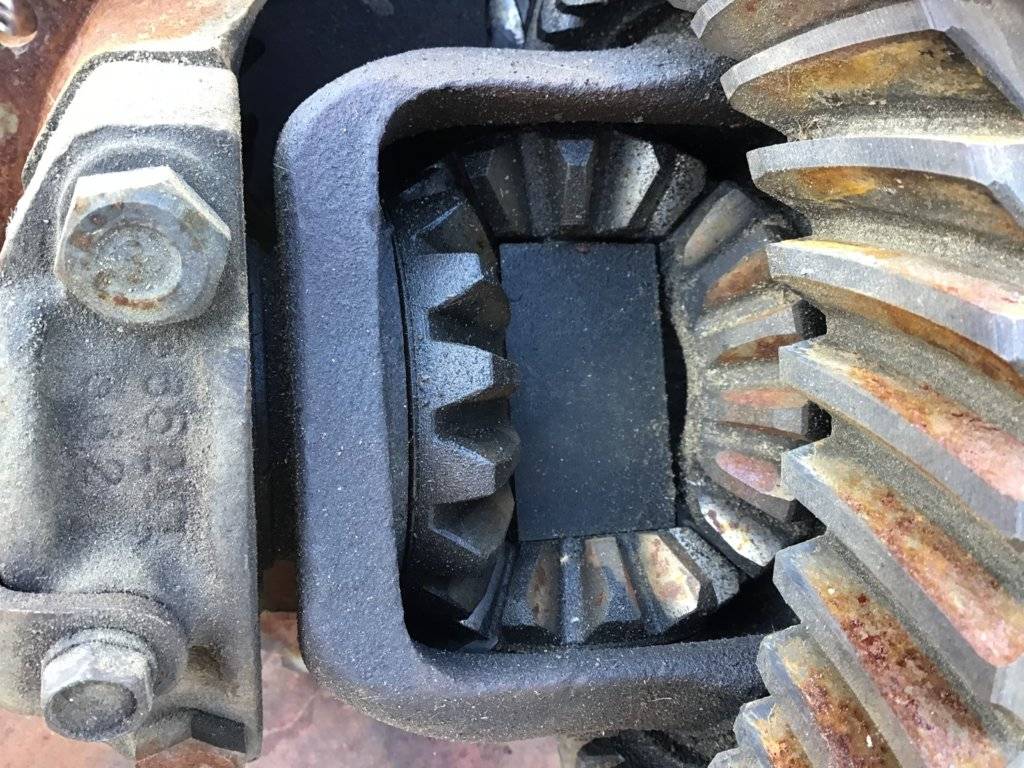

    First photo 1964 and older. 1.25” wide center. Notice the large rectangle block that fills all the space between the side gears and spider gears.
    second photo 1965 and newer. 1.5” wide, same as a sure grip. Notice the smaller round shape and you can see the spider gear shaft and inside the gear area.
    I learned this the hard way when the axle length was suddenly wrong and nothing would fit together any longer when it did previously.
