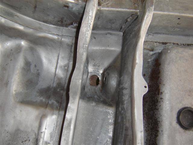

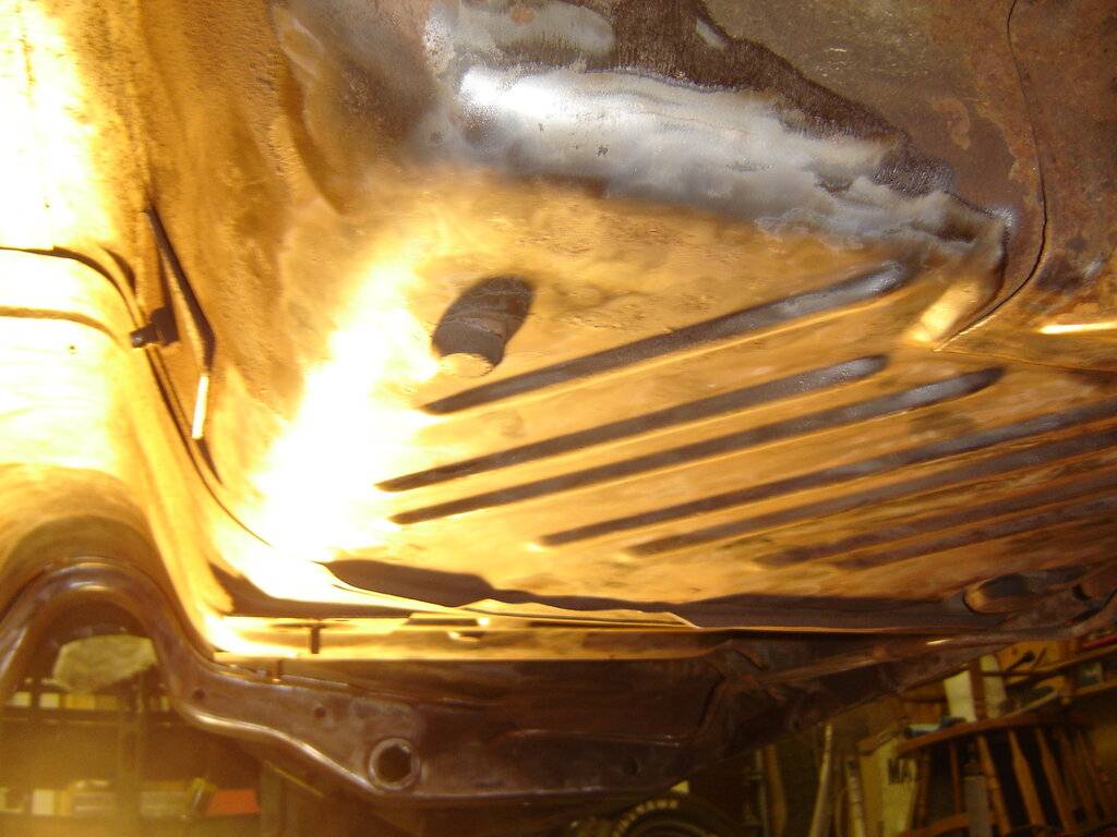

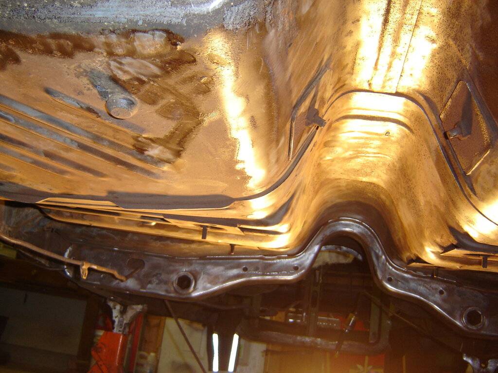

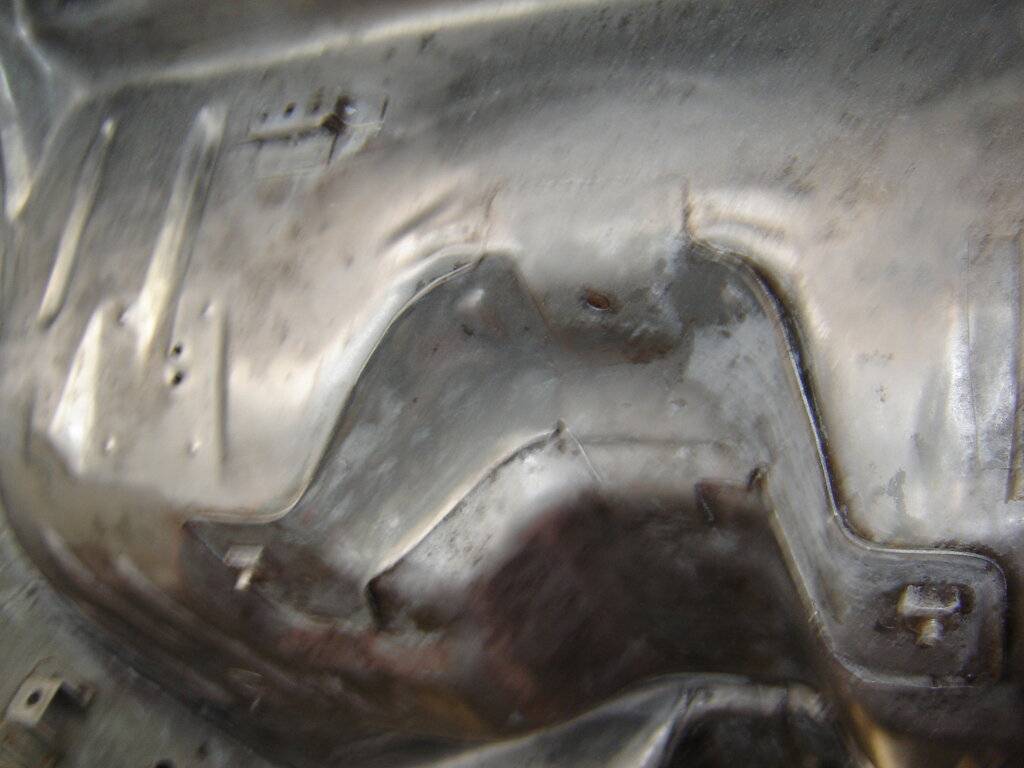

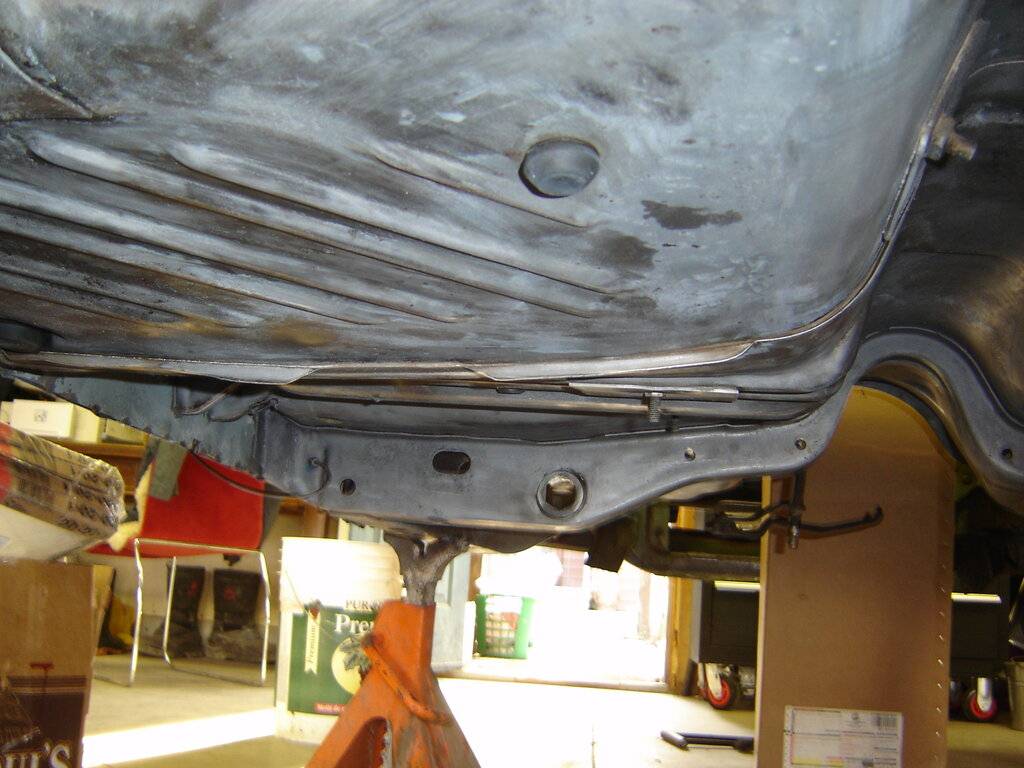

For the thick sound deadener I use a pneumatic needle scaler, colder the better.
On a C body I would but it back after the restoration, to help with quiet smooth ride.
There is also the thinner rust protection, black thin tar stuff. that washes off pretty good with varsol and stiff brushes. Also wire wheel in areas. (total combination of tools to use.)

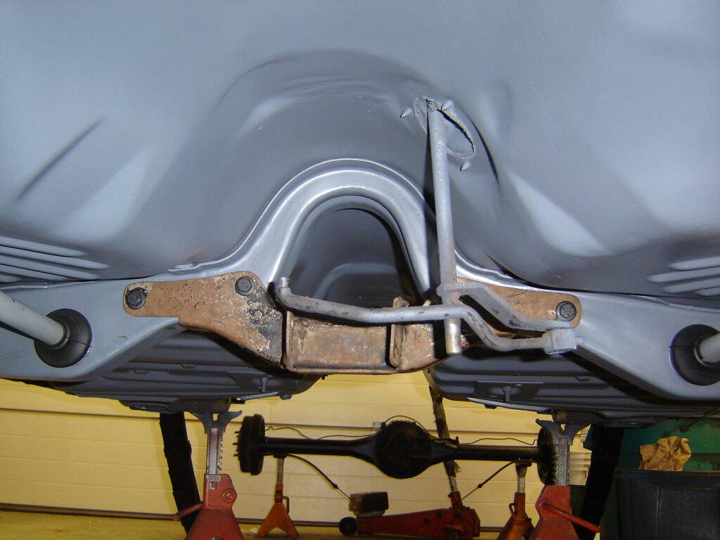

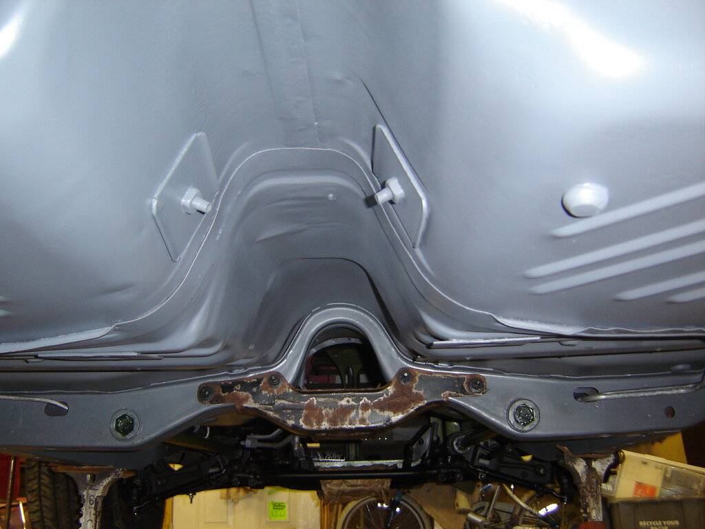

Then I use a portable media blaster to get the tight areas, wiped it all down with metal prep, then painted to look like Chrysler primer/paint.
It is a long exhausting dirty job, do it in the winter, so you don't sweat so much in the disposable suits and wear respirator. It is easier laying on a creeper on your back, then standing under a hoist with neck bent. Rotiserie would be great, but if car stripped that much then have the whole undercarriage media blasted.
